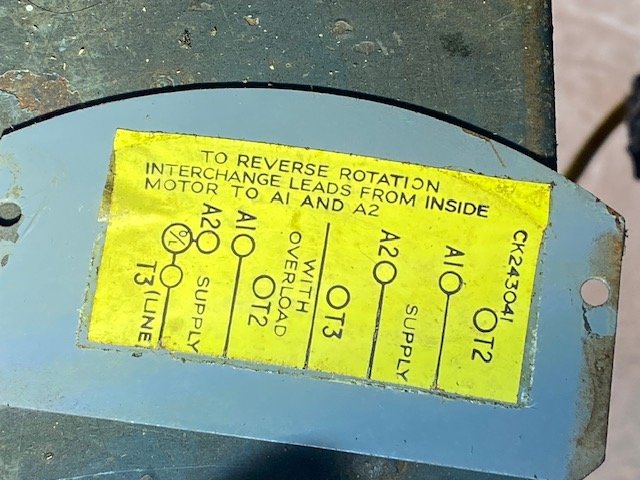

At the moment my Boxford has a light switch to start the motor (It's single phase, 240v) which I feel I should replace
I've done a little screwcutting in the last few fays, and whilst I'm not great at it yet - winding the lathe backwards by hand is quite slow, so I wondered about a revesing switch.

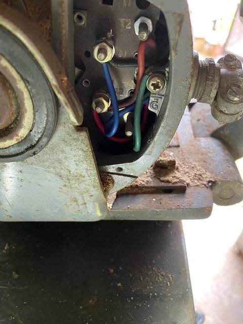

The motor windings appear to show I only need to swap two wires, and a cheap drum switch would appear to be all I need.
But I've read elsewhere on here a post about start windings needing to be swapped (@Rrobson ?) so thought rather than launch into a capital expenditure (£12.85!!) I'd ask the collective
Can I just wire the output feed from the switch to the A1 and A2 points - or is it just the internal motor windings (Black and Red) that swap, with A1 remaining neutral and A2 remaining live (As currently)
