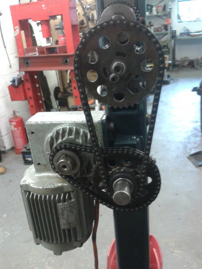

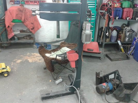

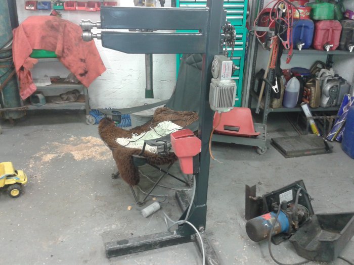

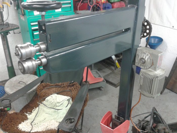

After selling the bead roller i bought (and should have kept) ive been busy building another, ive taken inspiration from "Lazze" and made my own from scratch, everthing was scrap, 2 X smart cam and chains, a stannah stairlift motor, some 20mm bright bar, a couple of legs off a stillage, the only things i had to buy were some needle bearings,
and even with my metal butcher skills it works and looks quite good, does 9 rpm,
so if anyone wants to come and use it your very welcome,
BUT I AM LOOKING FOR ANY SPARE DIES (made some but very slow on the lathe)

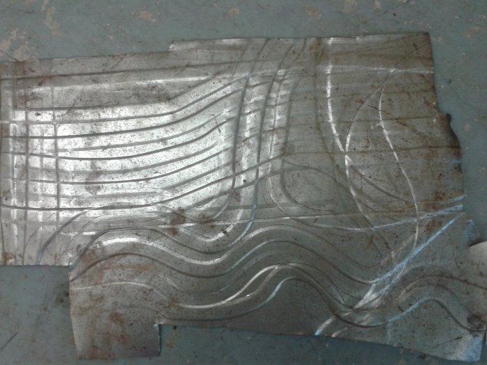

my test piece
