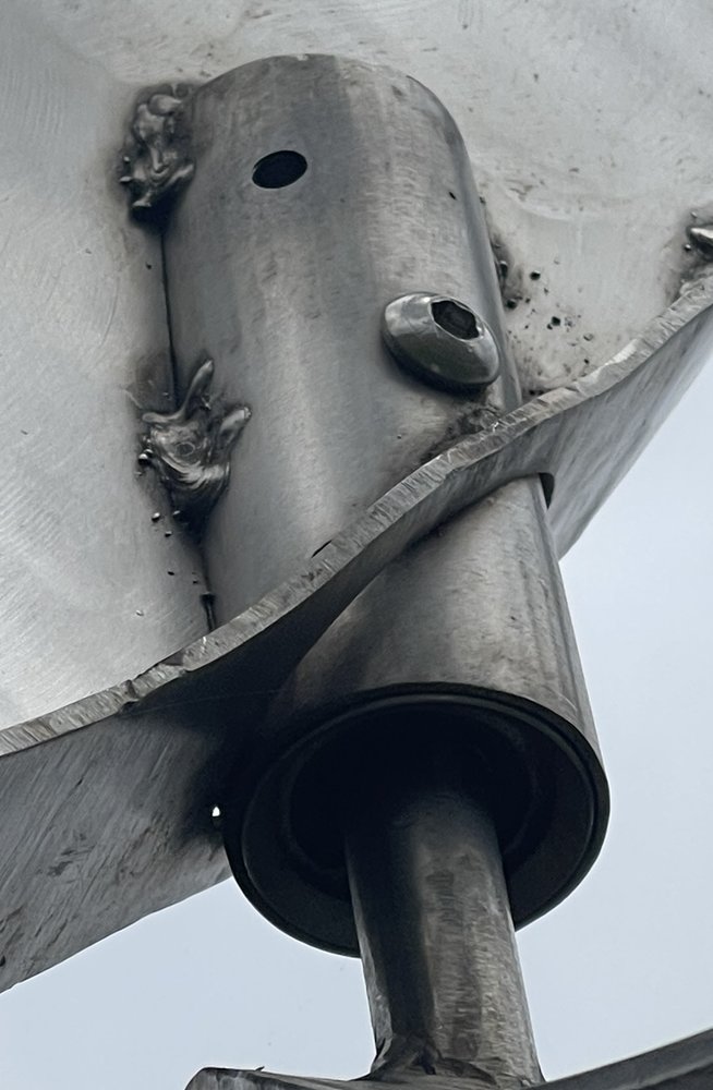

It allows the top bit to spin around in the wind.
Nylon is better here, as those bearings won't like the rain.View attachment 456802

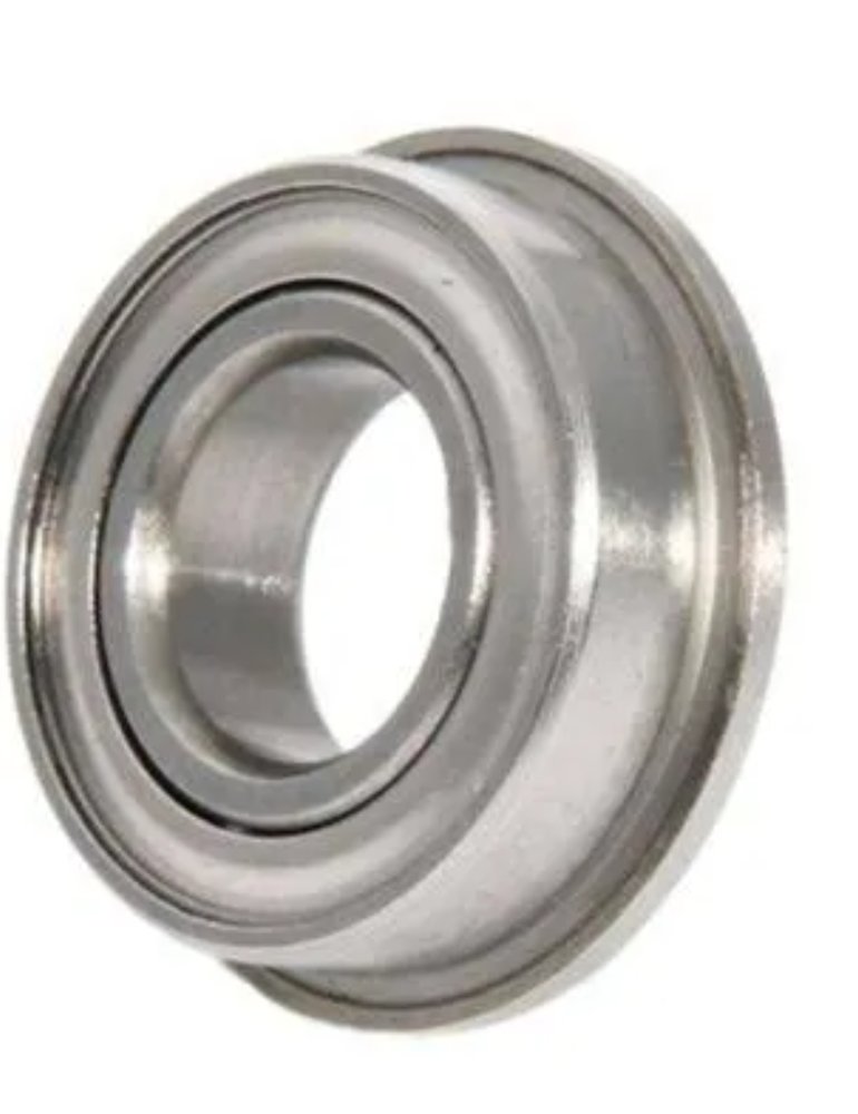

Flanged deep groove ball bearing
2 of those pressed into a length of tube.
Tube inserted and locked in place with the button head bolt.
Not just the balls, the steel raceways can rust.Do our Chinese friends sell cheap ceramic bearings? They might be OK if they are rain-lubricated.
With any type of bearing bearing, the shaft needs to be vertical in two planes 90 degrees apart. Depending on where the thing is installed, that might be tricky to achieve. The gimbal-style single ball pivot is self-plumbing so long as the rotating object is balanced.
