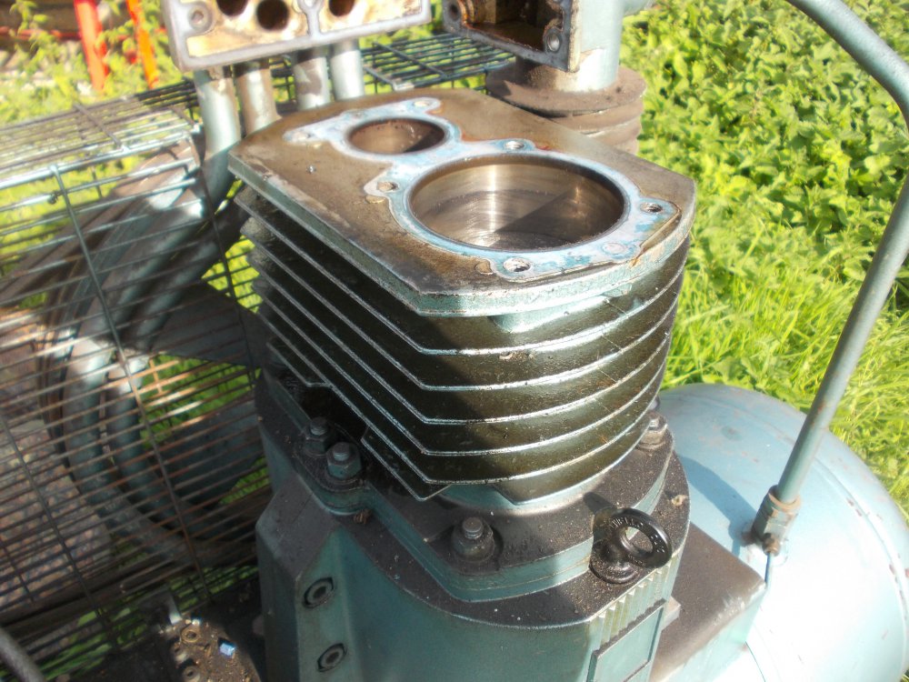

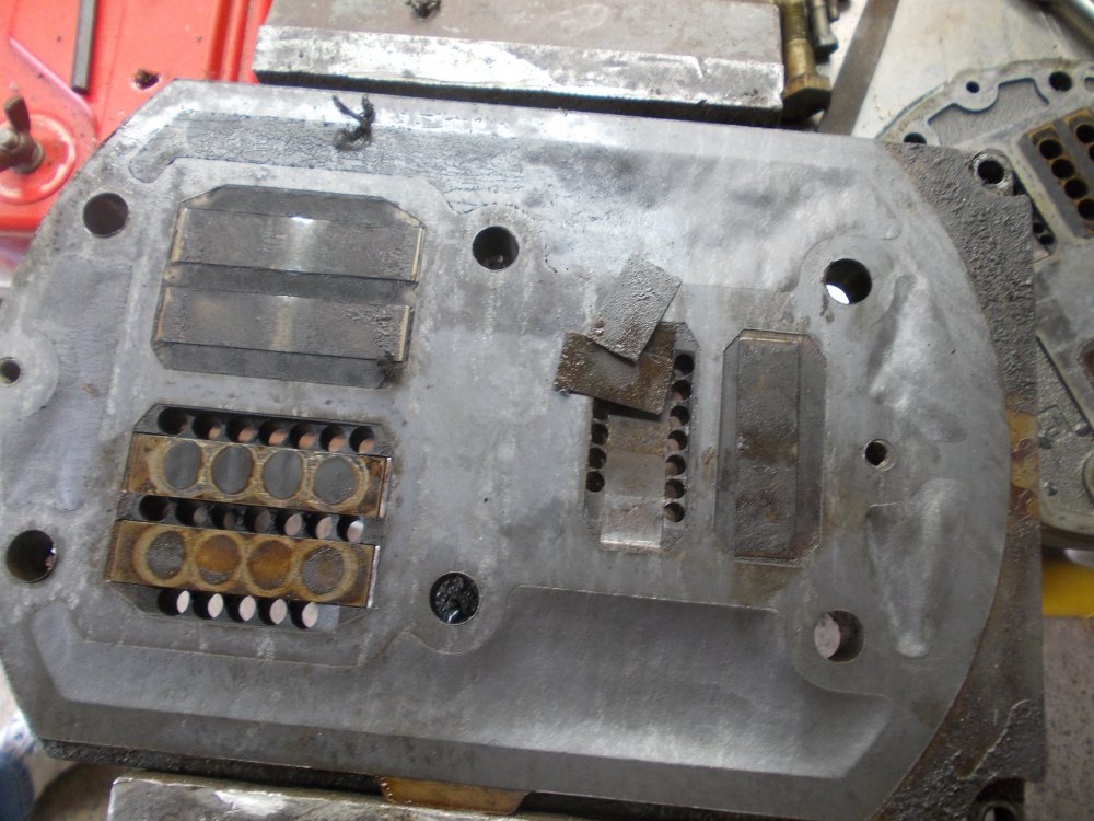

get it measured for size and shop round http://uk.rs-online.com/web/p/produ...stBid=tztx&gclid=CJuAzMLNnMgCFSLnwgodwyAObwif your steel rules the righ gauge get it cut up and used improviseant got any spring steel otherwise worth a try
will go and measure it now i will replace all of them fix it once and forget.How thick how big ??
what did u use to measure themI used feeler gauges to make a replacement for mine
I actually used exactly same thickness and it lasted ok, But then tried slightly thicker when the other failed, and it seemed to fill faster so swapped the first replacement one for thicker and it definitely filled faster. It is on all day not pumping obviously but it runs every hour or so for 10 -12 seconds to refill.what did u use to measure them
Brill thank you the shim steel arrived today cut out what i needed and fitted it put it all back together runs sweet thank you so muchI have some shim (make Stubs)
0.12th
0.15th
150mm wide
300mm long, so can cut for you it is flat sheet not rolled
If it is any help will post to you send me private email
