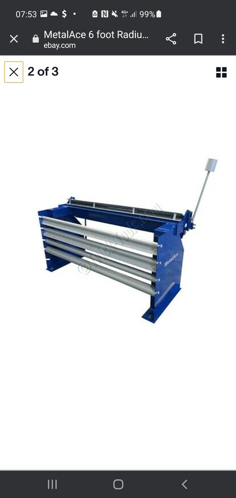

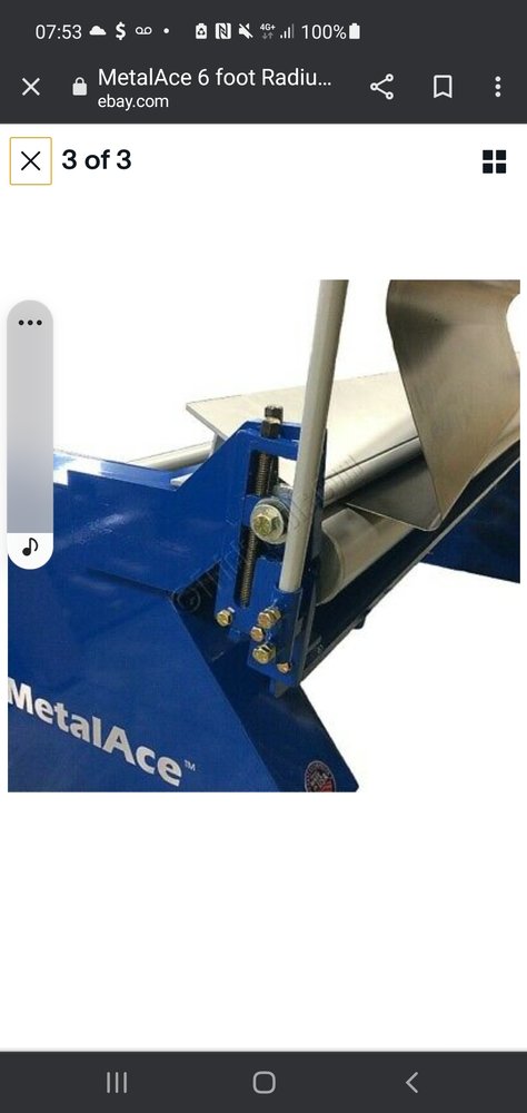

I've done that before, this is for my home work fuel tanks etcNever came across a set of slip rolls with a radius brake built in... looks like a different operation altogether?
If you have a press brake you're better making up some radius tooling with appropriate round bar, it's not expensive or difficult.
... there is a set of rolls that also bends,,,
If you have a press brake you're better making up some radius tooling with appropriate round bar...
More round bar spaced at an appropriate widthOut of interest, what do you use for a bottom tool there? Can you use a soft/deformable material?
you can use anything, even normal notch tooling, if the vee is wide enough for the radius.
Don't have oneJust use a normal vee if you have one suitable sized, with the top tool made to suit the radius.
what sort of lengths do you need to roll the edges on , roughly what radius? I was thinking home made Gabro or a couple of jacks and some press form tooling .Don't have one
playing with ideas a fuel tank looks much smater with radius edges, they are also less prone to cracking I've seen a few ways to achieve it, just wanted to know had anyone use them, How's things Tomwhat sort of lengths do you need to roll the edges on , roughly what radius? I was thinking home made Gabro or a couple of jacks and some press form tooling .
