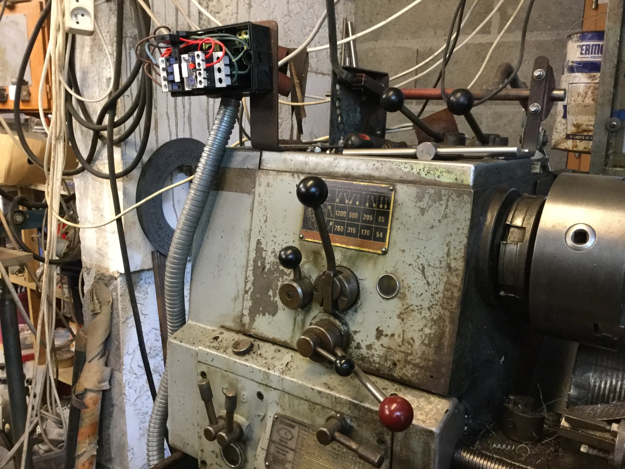

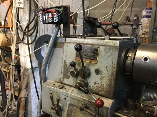

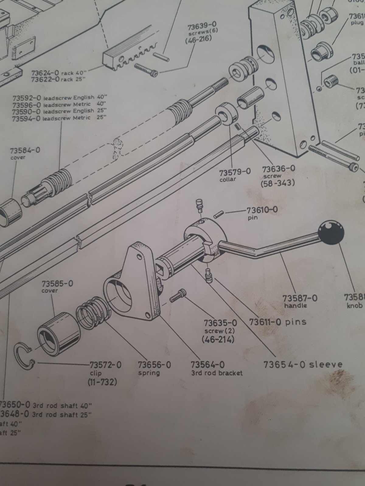

Well after only 18 years my Colchester Triumph ran for the first time! Really smooth and quiet as well. AND on my birthday!

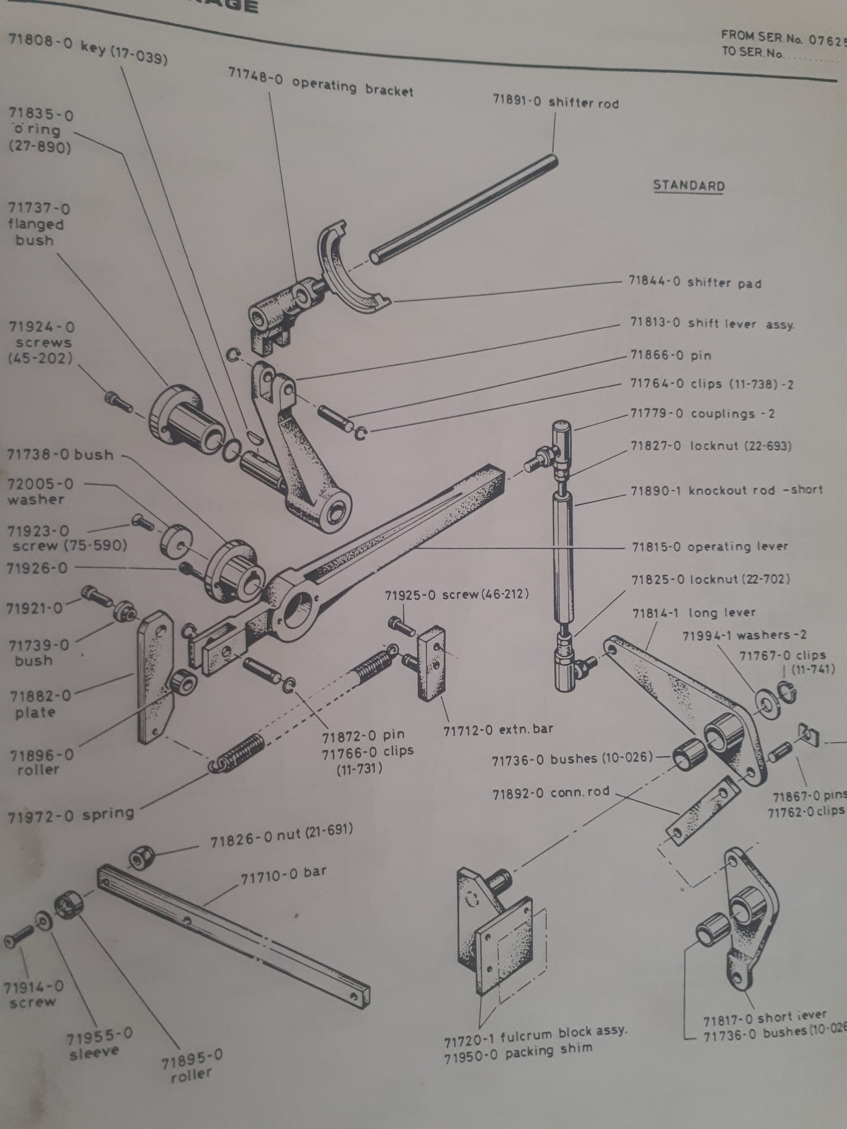

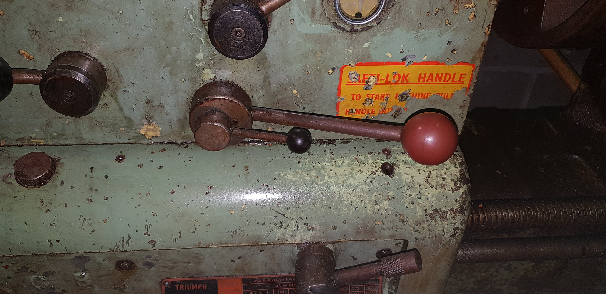

Have a bit of a problem though - the safety lock lever isn't engaging properly.
I have to hold it up to keep the lathe running - as soon as I release it the lathe stops.

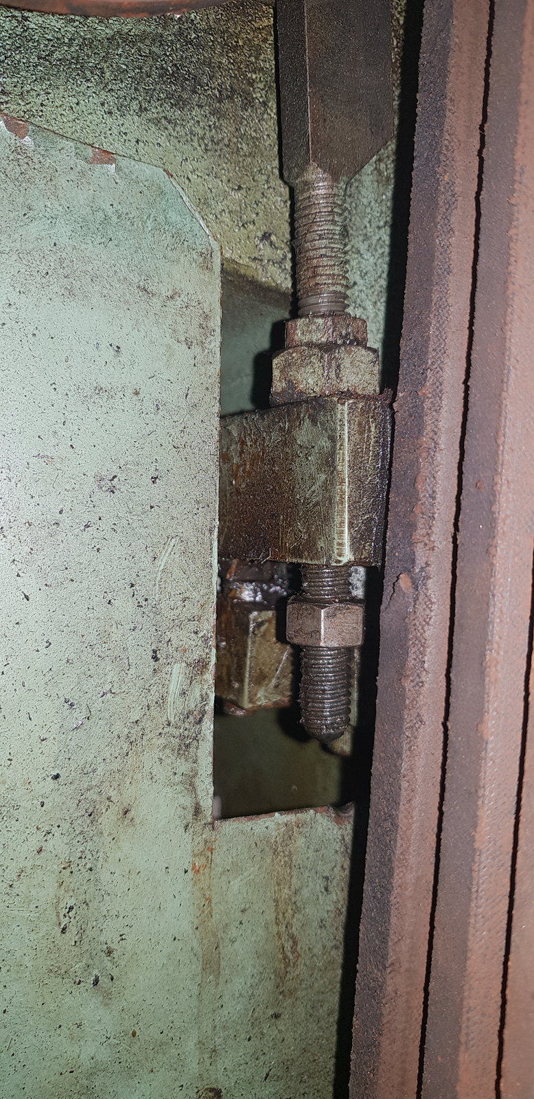

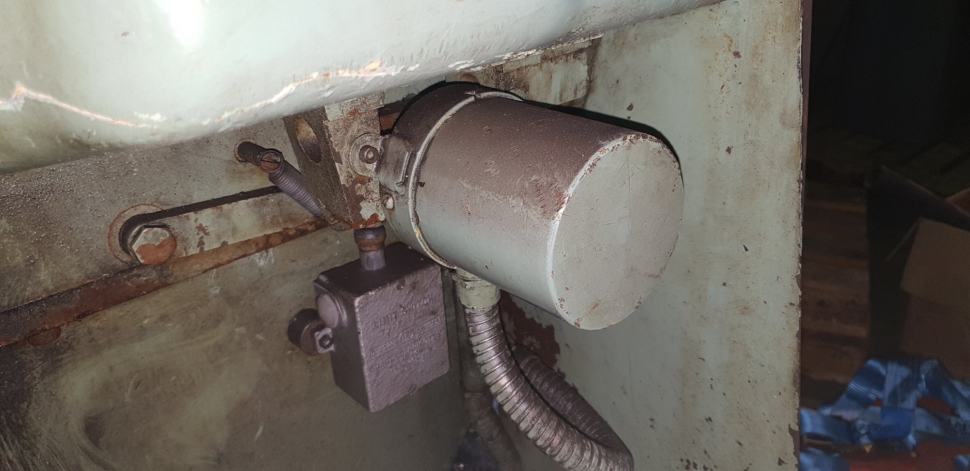

There is a position stop on the back of the lathe. When I adjust that so the handle latches the lathe doesn't start at all.
Any ideas?
