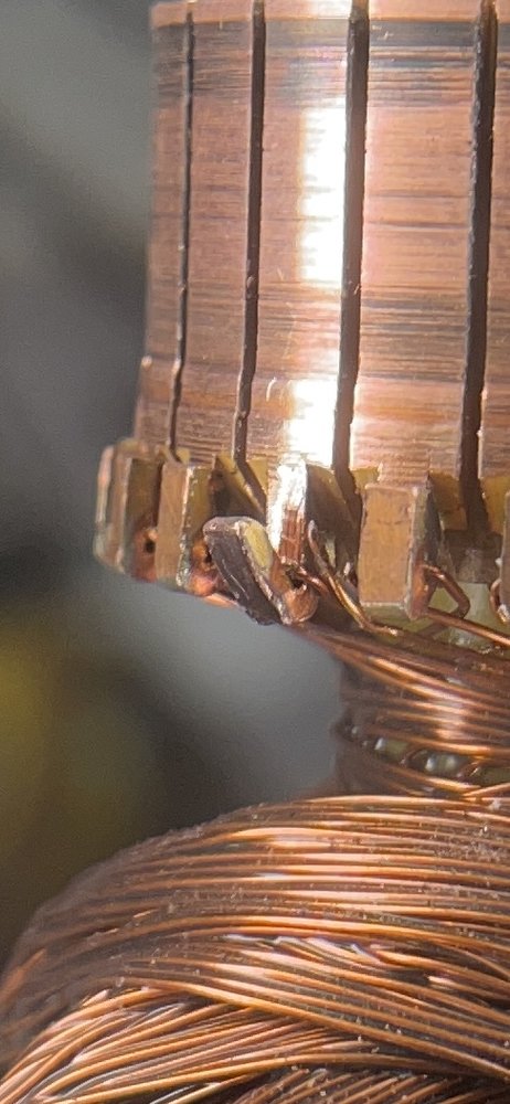

They are not soldered originally.

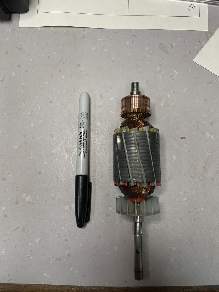

Ok but what has the motor come out of out of interest?But right now, the wire that was continuous when the item was manufactured, has a break in it. It is discontinuous. What alternatives to solder might there be for restoring its continuity?
As a tinkerer / DIY type ( not a motor expert) some ideas :

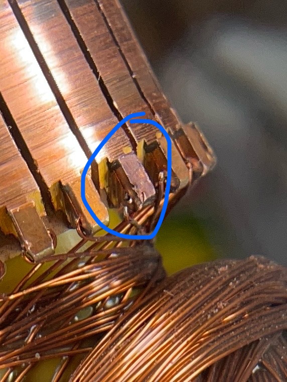

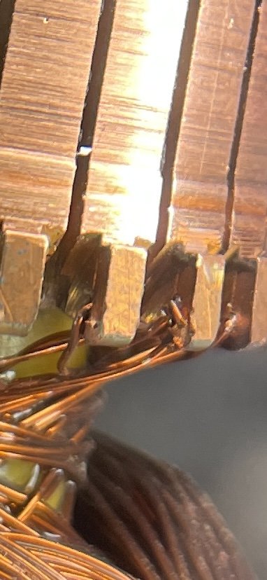

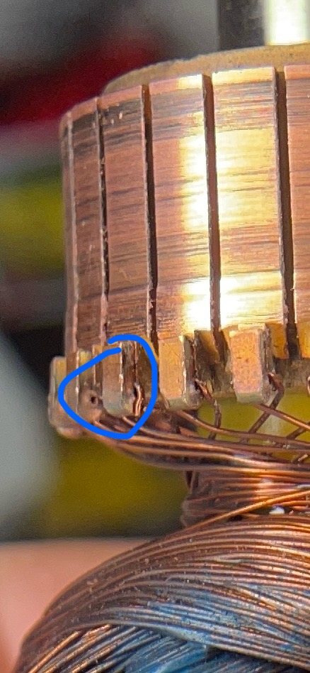

It's been crimped - open up the crimp to remove the broken end of the wire.
The wire originally over-shoots the crimp and connects from the left, will the snapped wire reach the crimp if you go direct and connect to the right side of the crimp?
Some of the other crimps have 2 wire connected ( looped in & out), the one in your photo looks to only have 1 (broken) wire - am I looking at it right?
I didn’t think of the heat, good point.Bear in mind the commutator gets hot. Something I never really factored in as a schoolboy when I rewound a motor for an RC car and soldered the triple windings in. Went like stink for all of about 30 seconds before it died a death . Autopsy showed it had thrown all the soft solder off the commutator. It seems Automotive starter motors etc that have soldered in windings are done with a higher temperature solder for this very reason…
