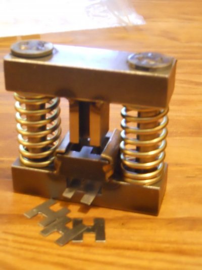

I'v been buying in the little cable guides that you see on most bikes these days, but thought I could make a tool to make them myself.
So here are the pics:
The one with the springs needs a press. It gets stuck once you've punched so I needed some pretty tough springs to get it to return. The Die can be hit with a hammer though
In the actual manufacturing enviroment they probably use a machine worth several thousand pounds to make those, You've managed to do it for about a tenner Excellent, and well done

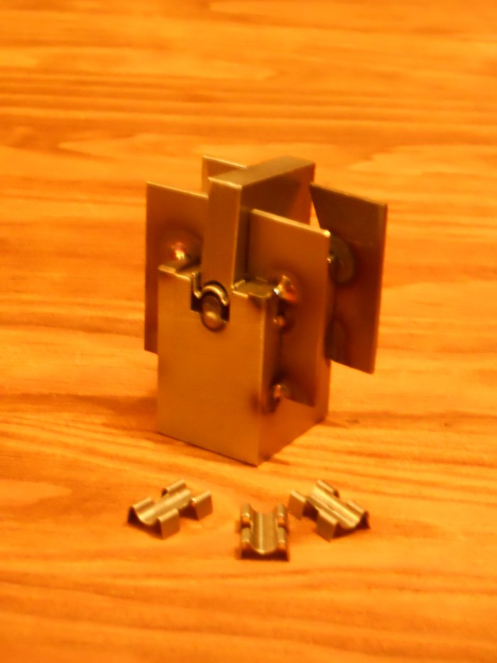

the punch is made in 2 halves and welded together. For the life of me I can't remember what the metal was, the name has escaped my mind... Flat stock? Comes ground to size... Man this is annoying!
