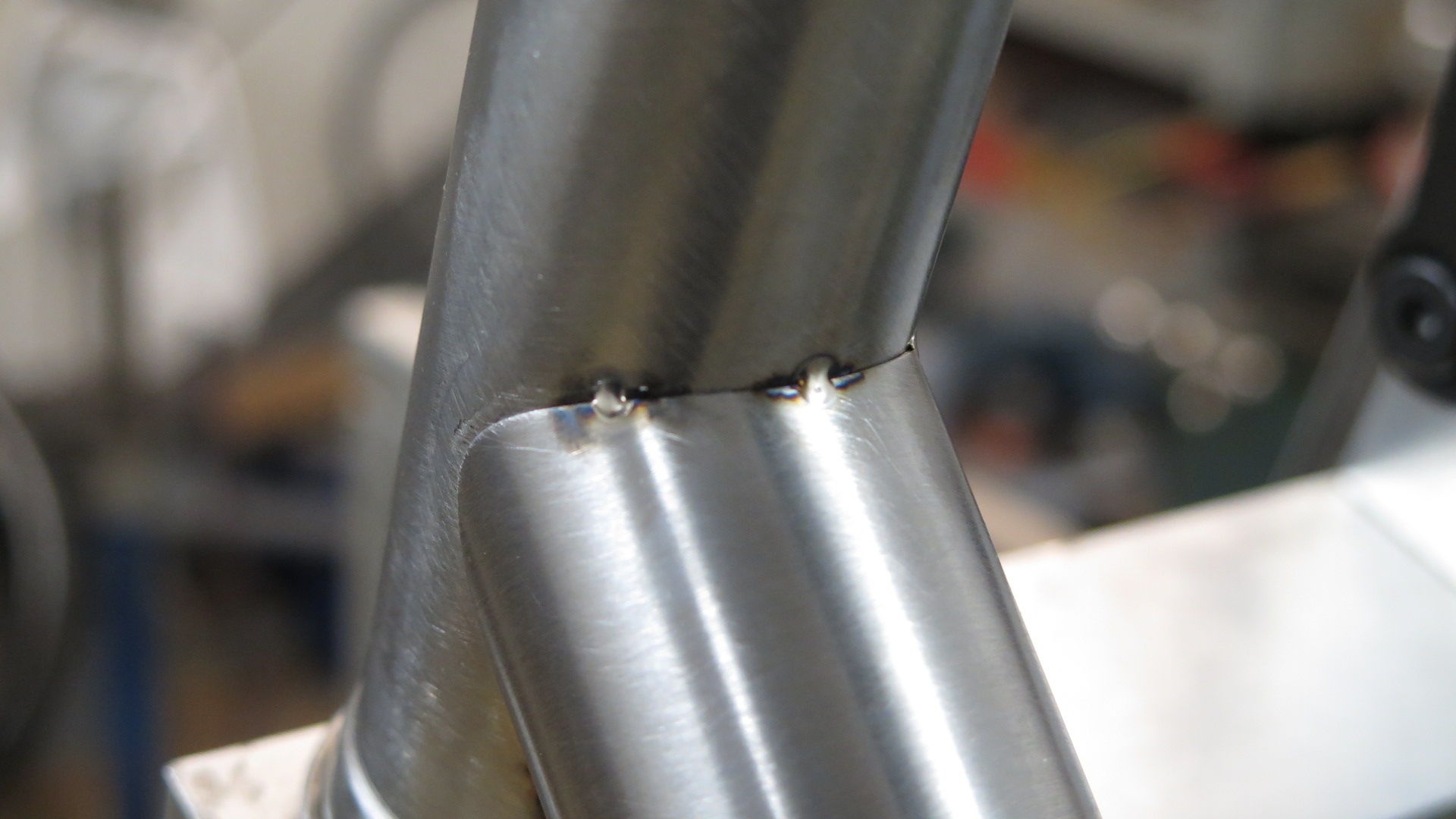

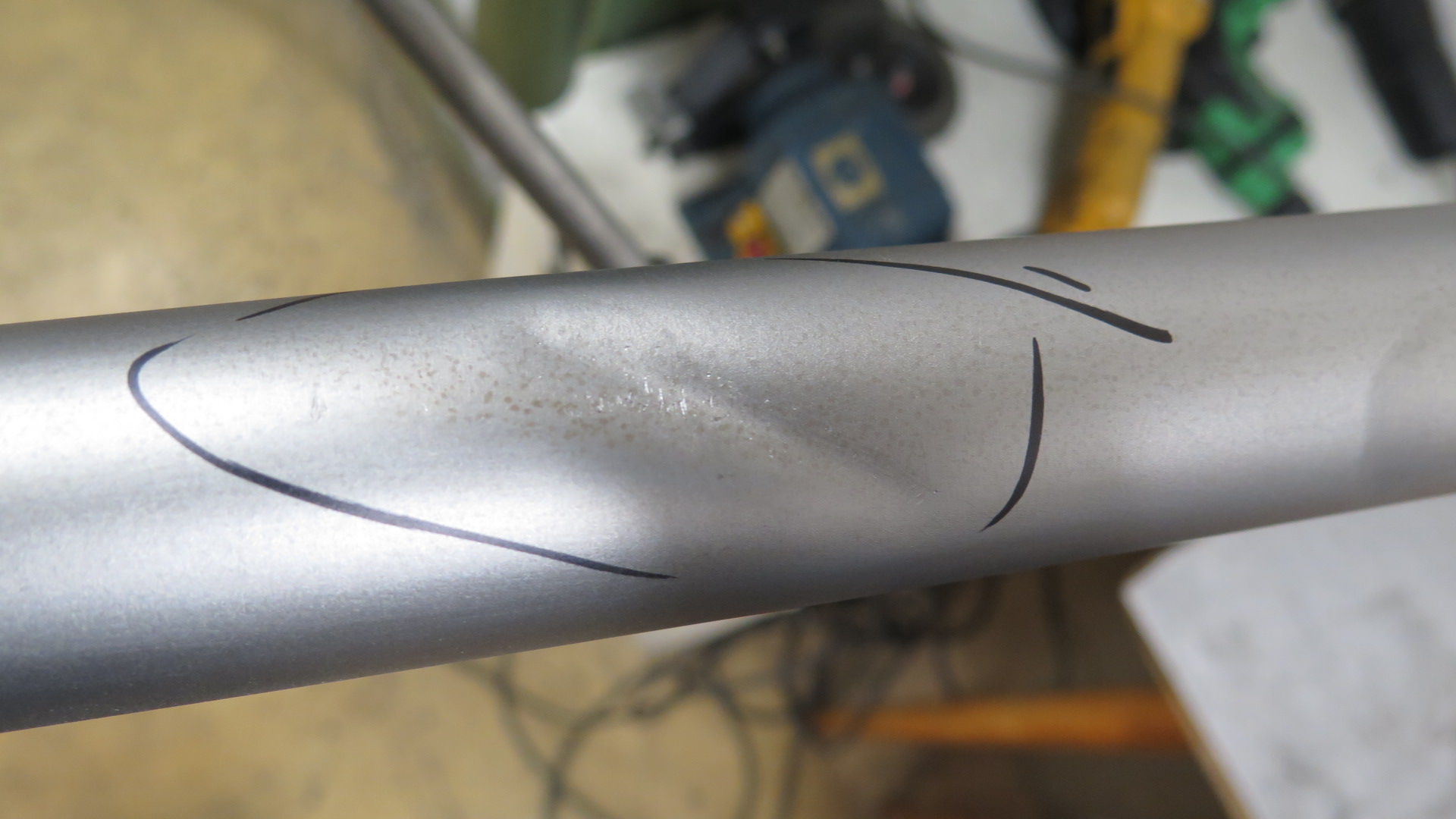

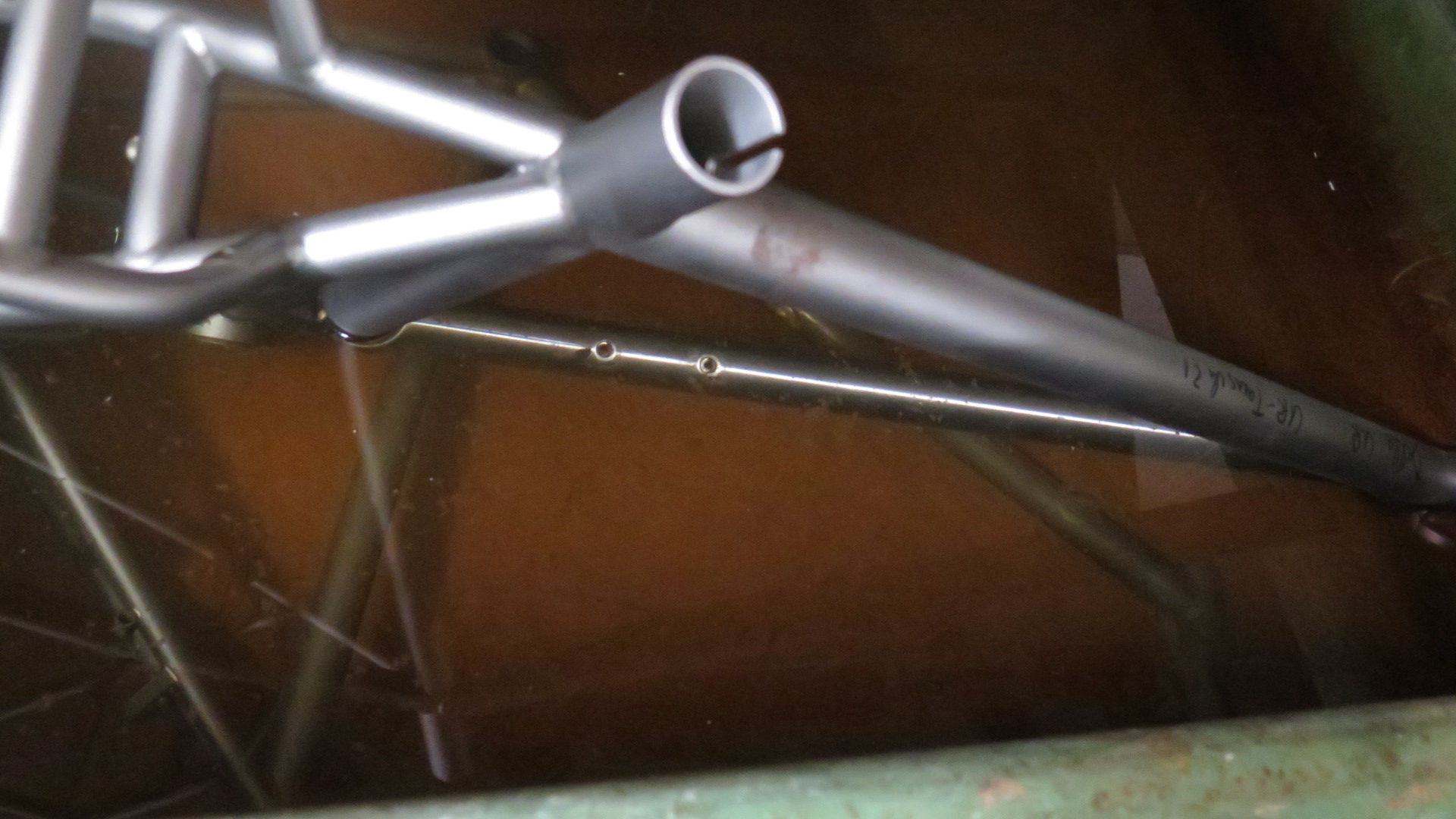

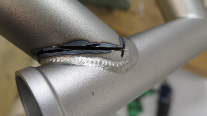

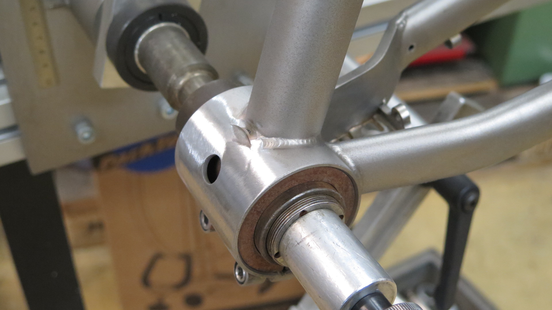

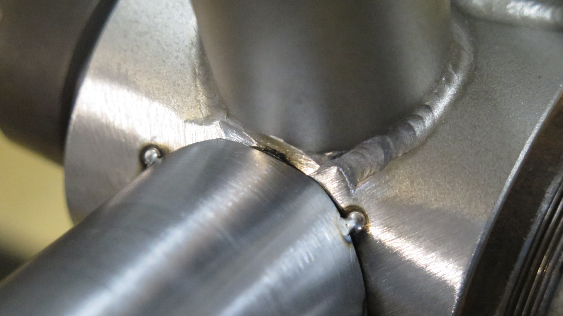

Hi,

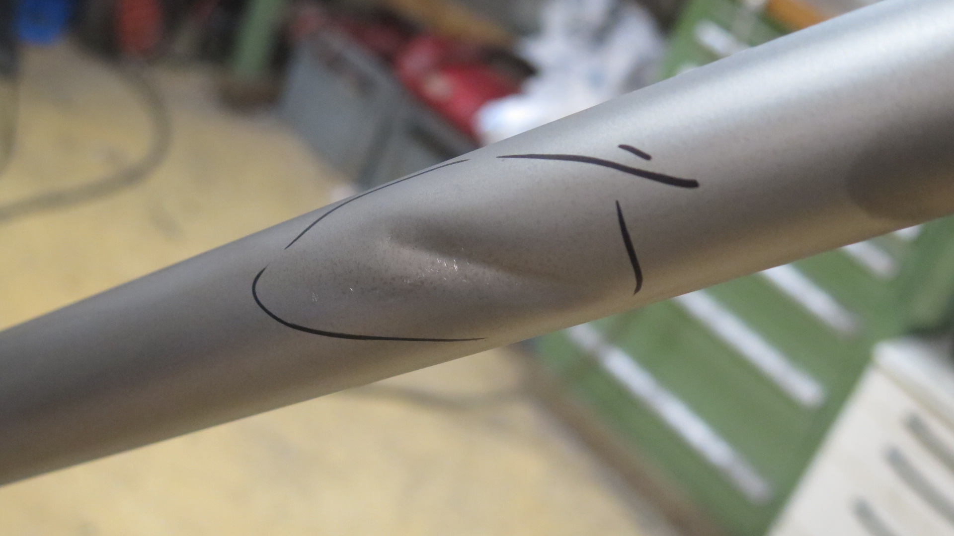

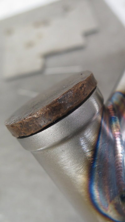

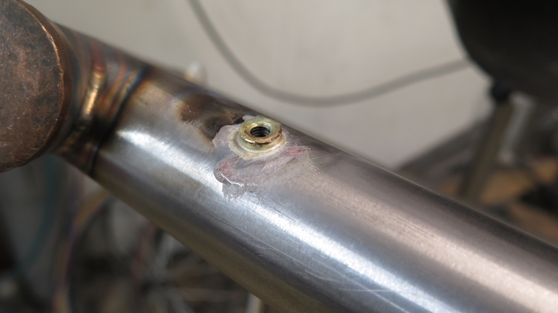

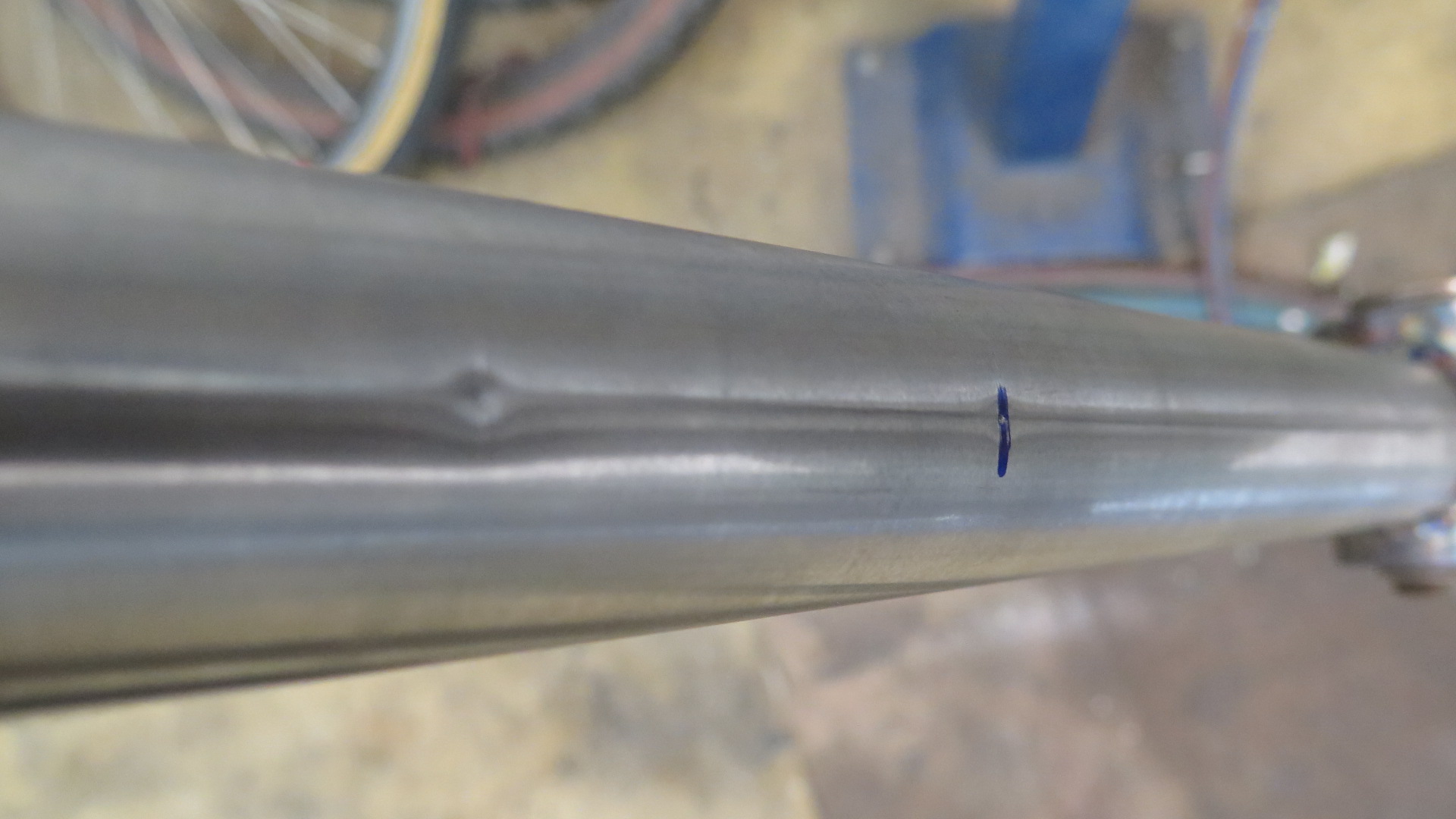

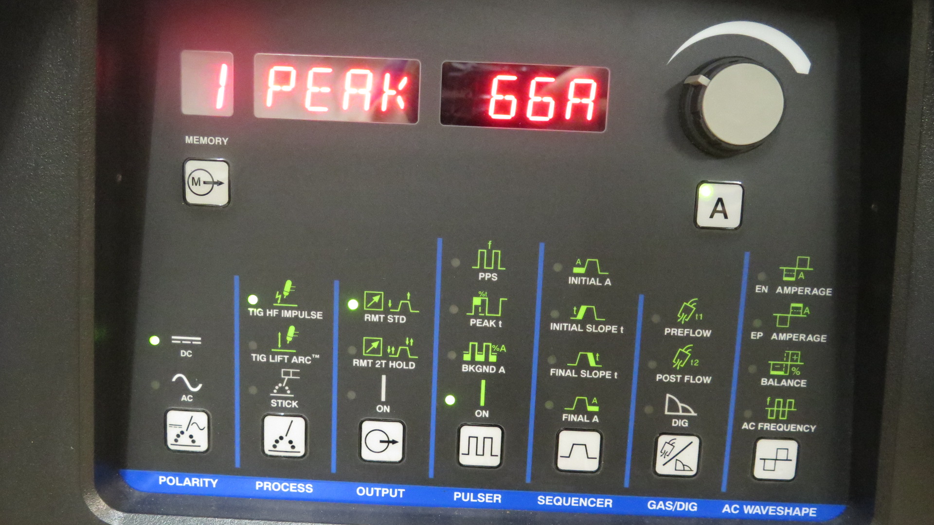

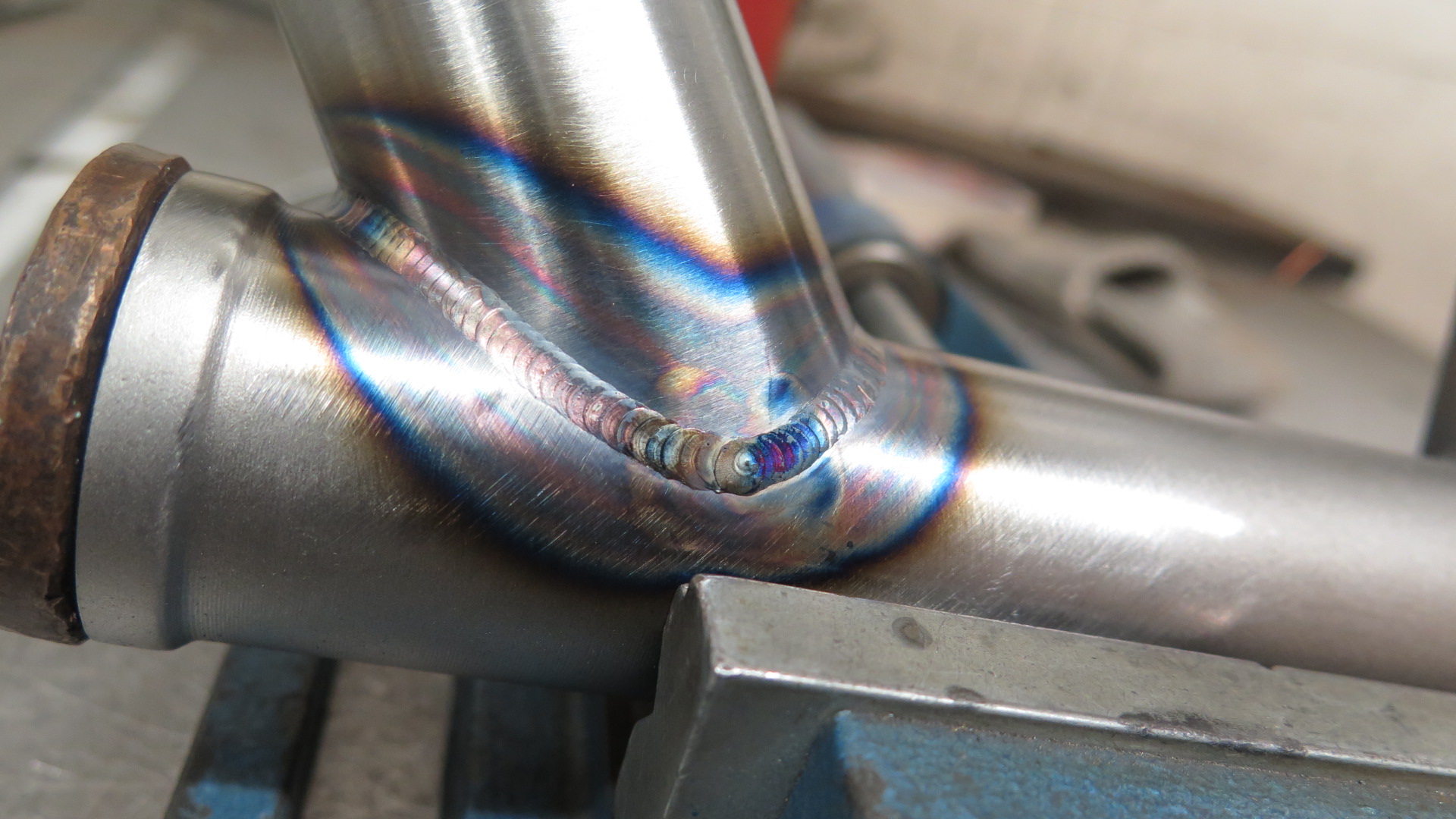

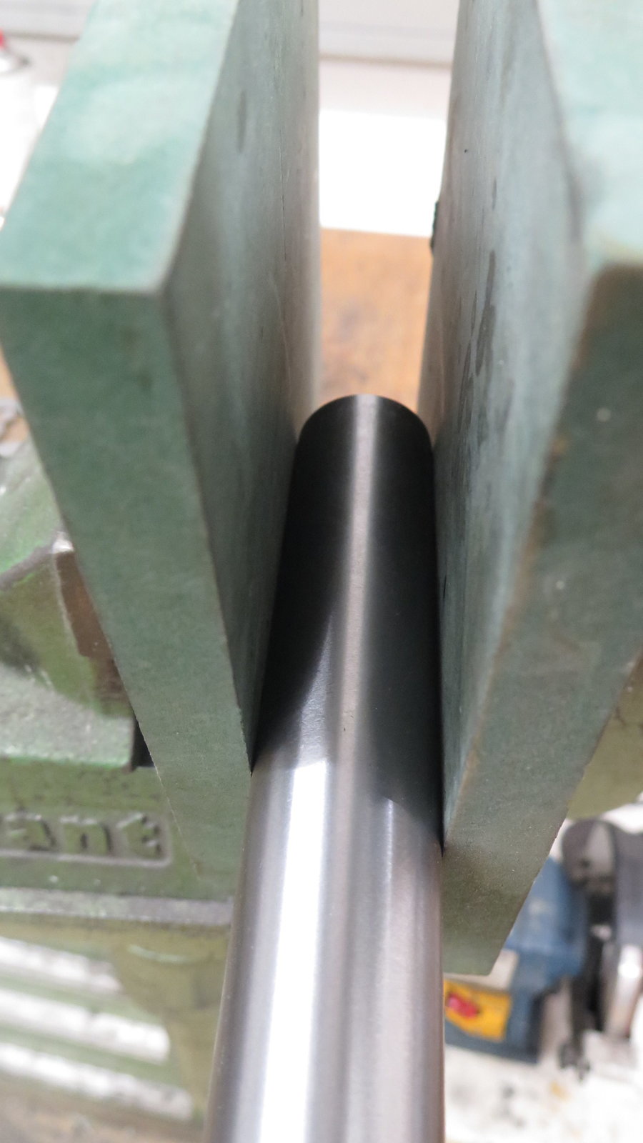

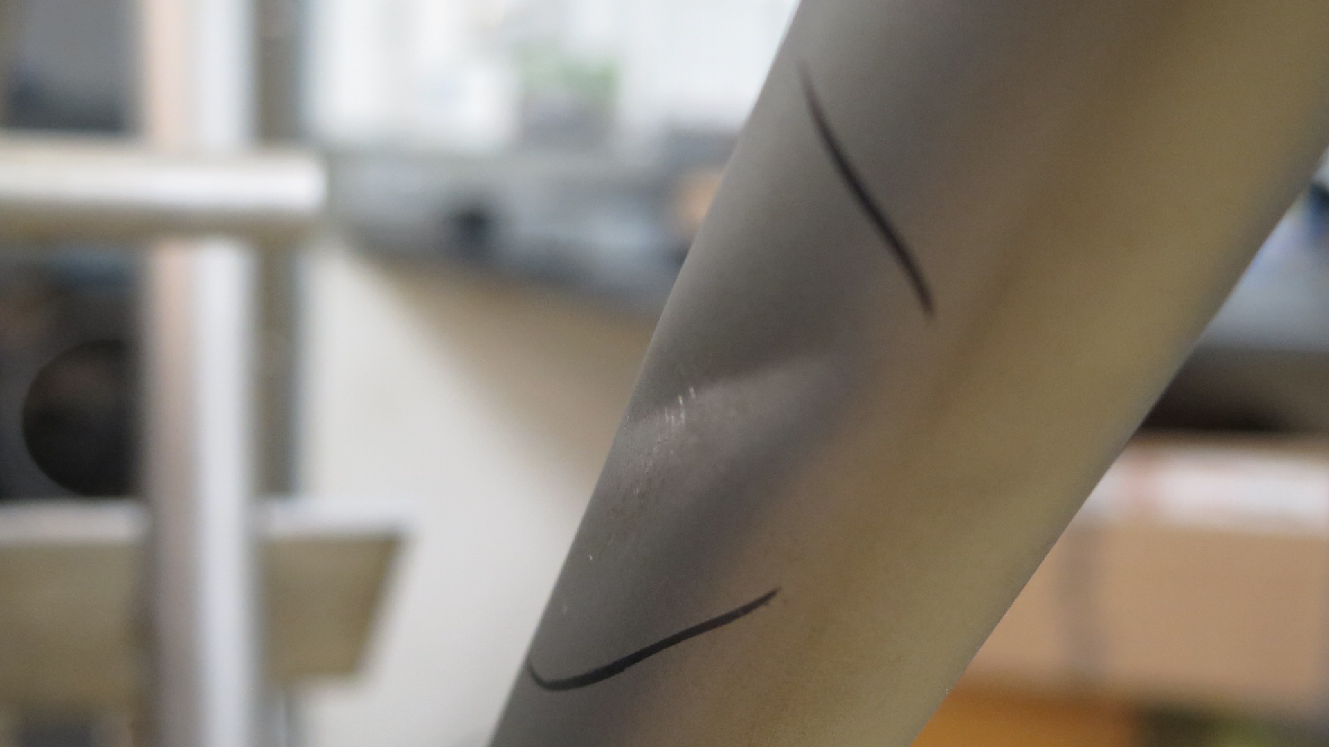

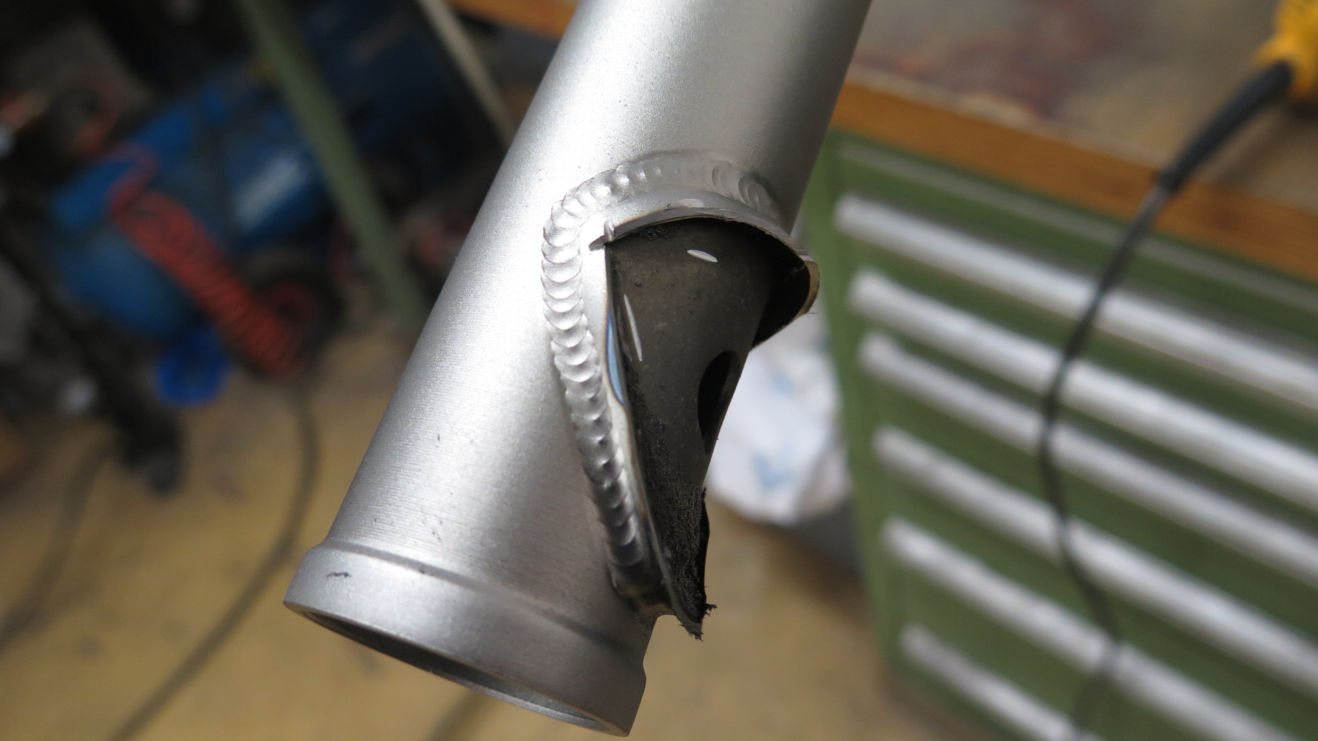

I just made a series of pictures from a typical job I do recently.
The steel touring frame had a bad dent in the downtube and filling that with silversolder (Thats what I do when it´s not as bad) wouldn´t work.
So I had to replace the tube......
