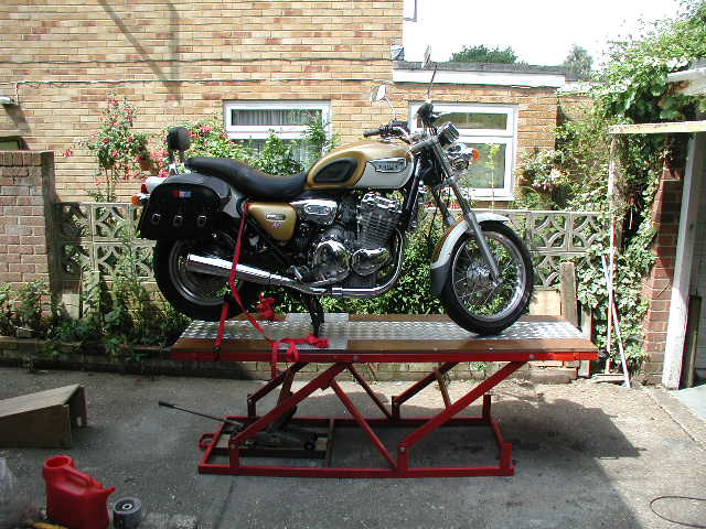

I bulit one, but it's not a "table" it just lifts the bike from underneath. It's quite complicated to get the bike up, but once it's up, the lift isn't in the way.
One thing I learnt was that the key stress points are where the trolley jack lifts and pushes up. I thought I could have just had the trolley jack on the floor, but if I would have done that, it would have lifted the lift, not the bike, so I kept modifying the lift to have more reinforcements around the trolley jack and lifting mechanism. If I'd start again, I'd start to build a strong cage around the trolley jack.
