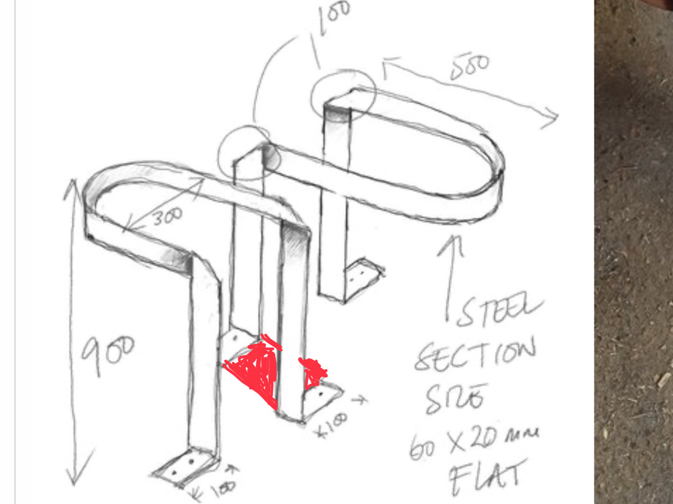

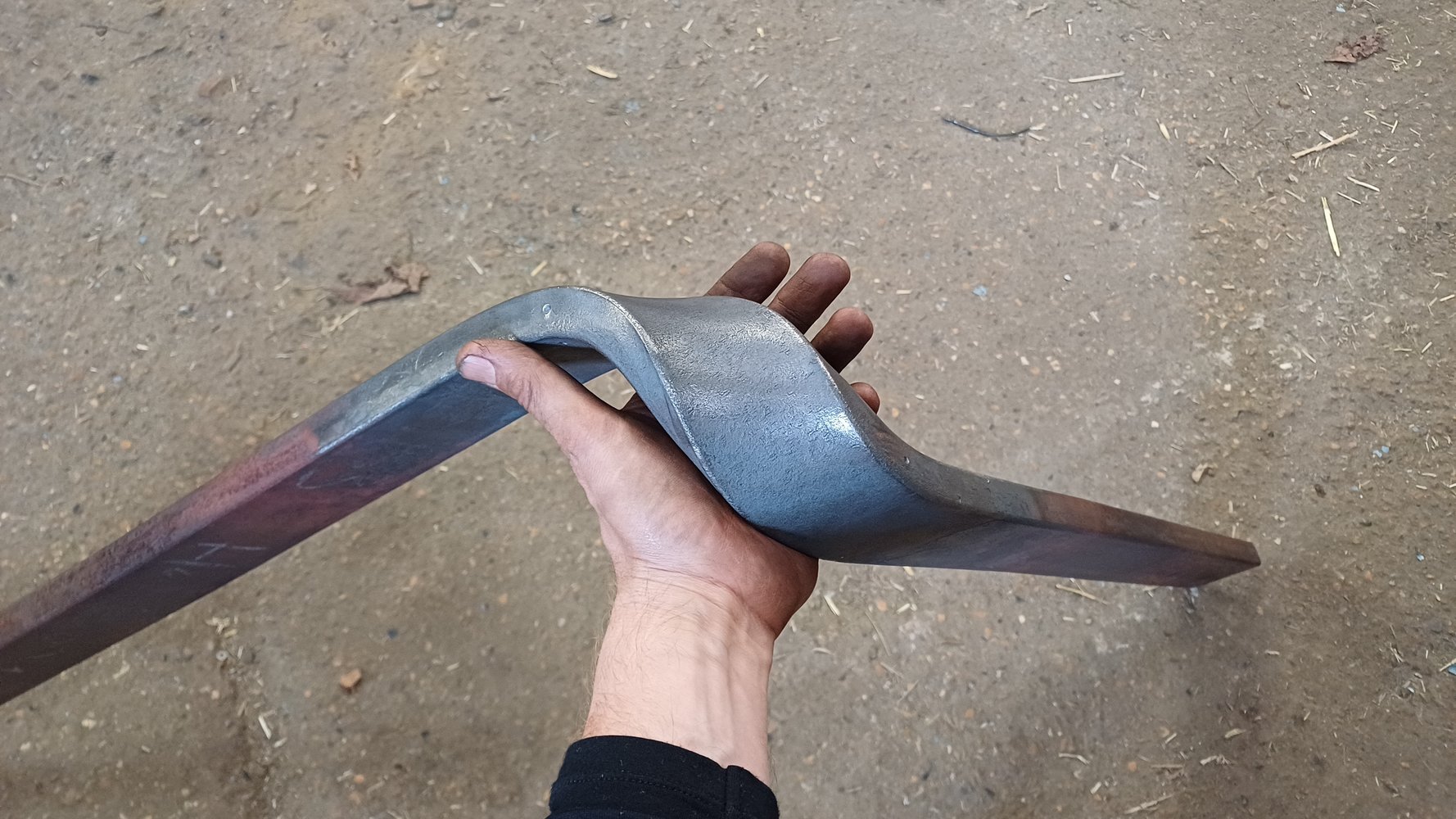

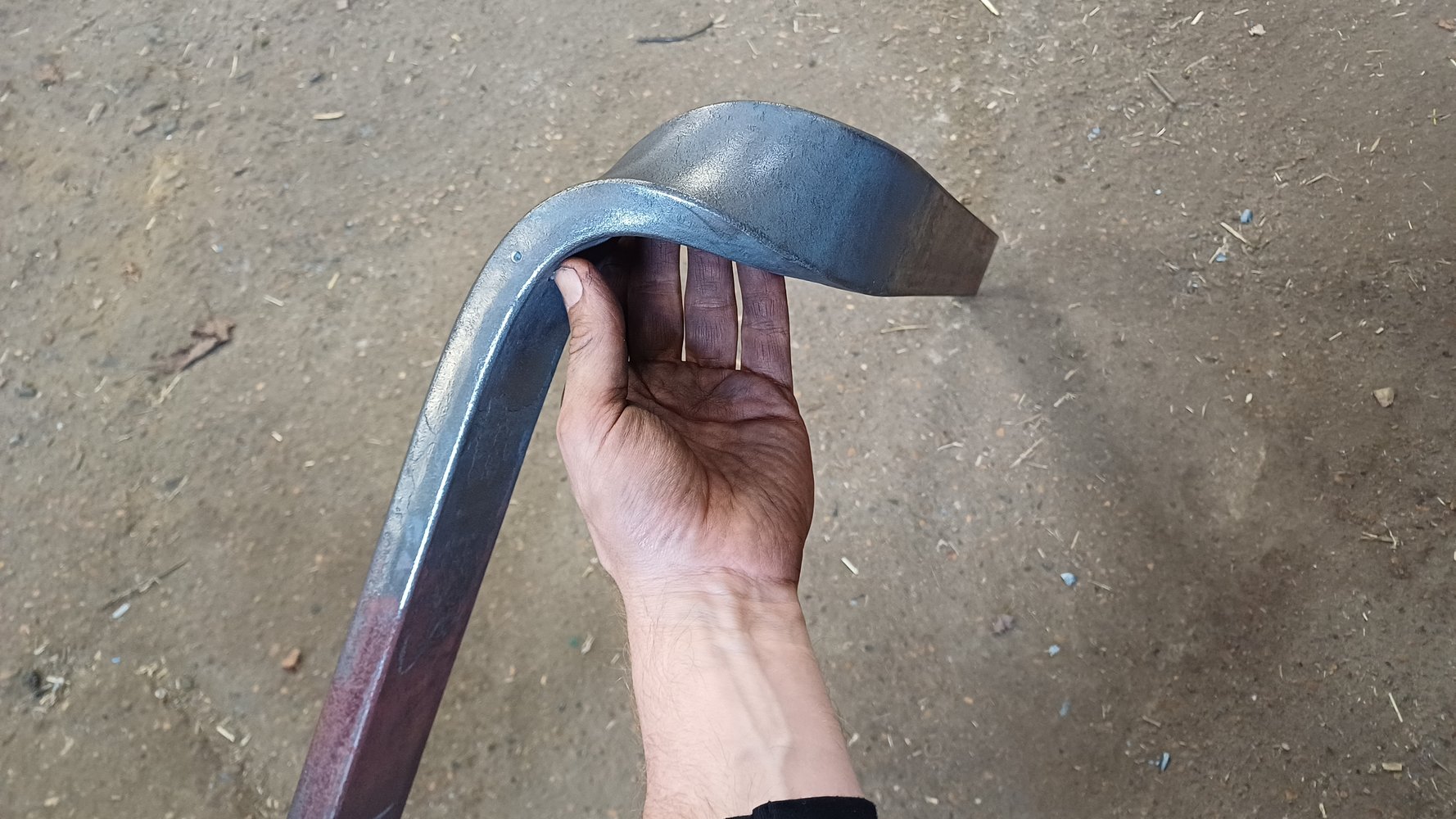

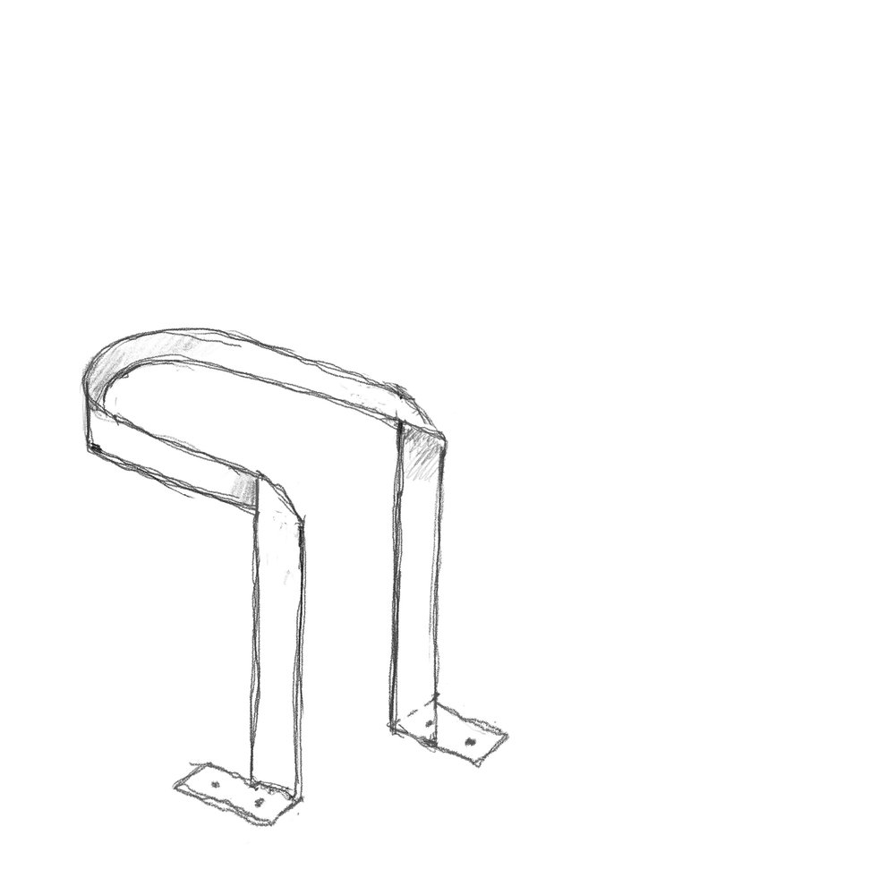

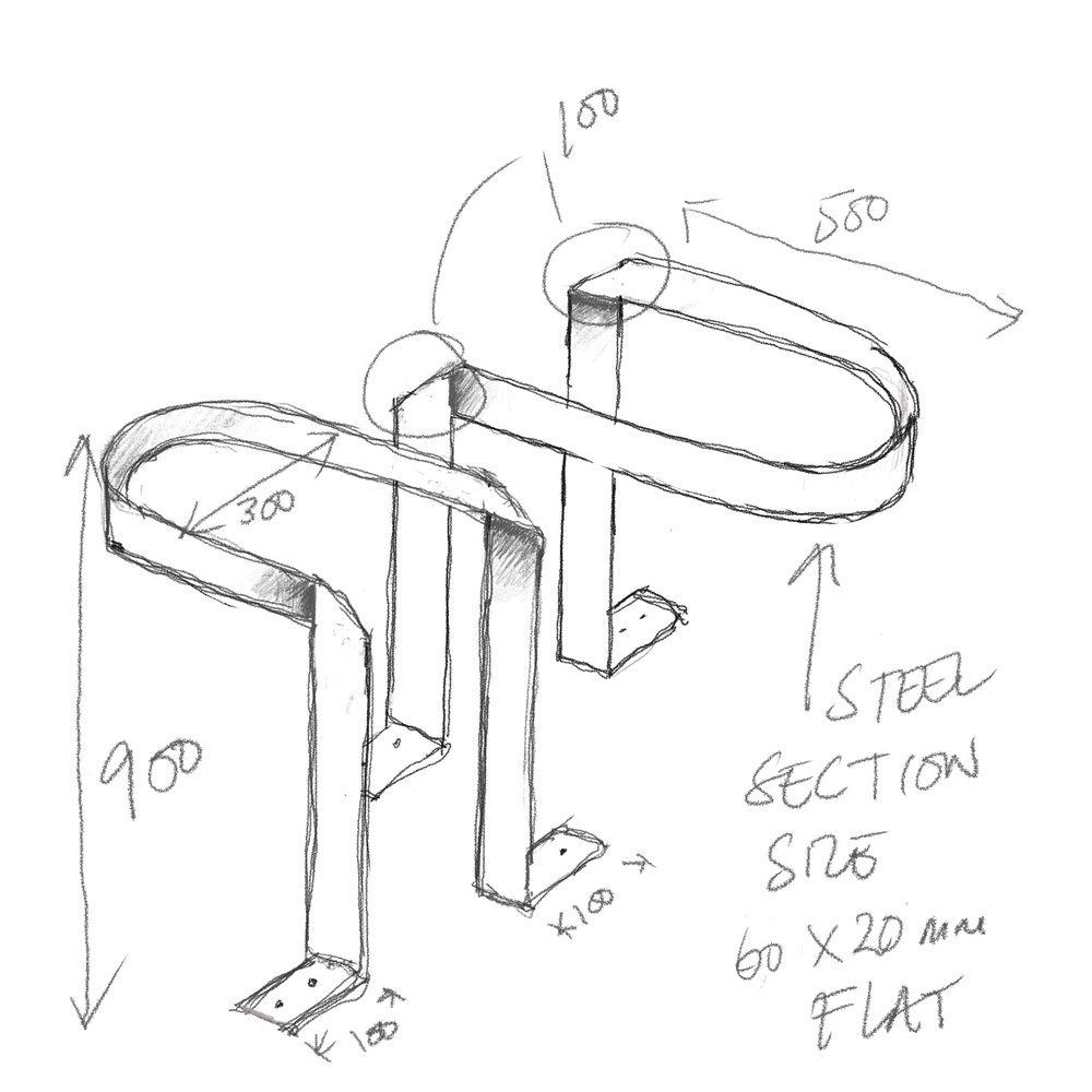

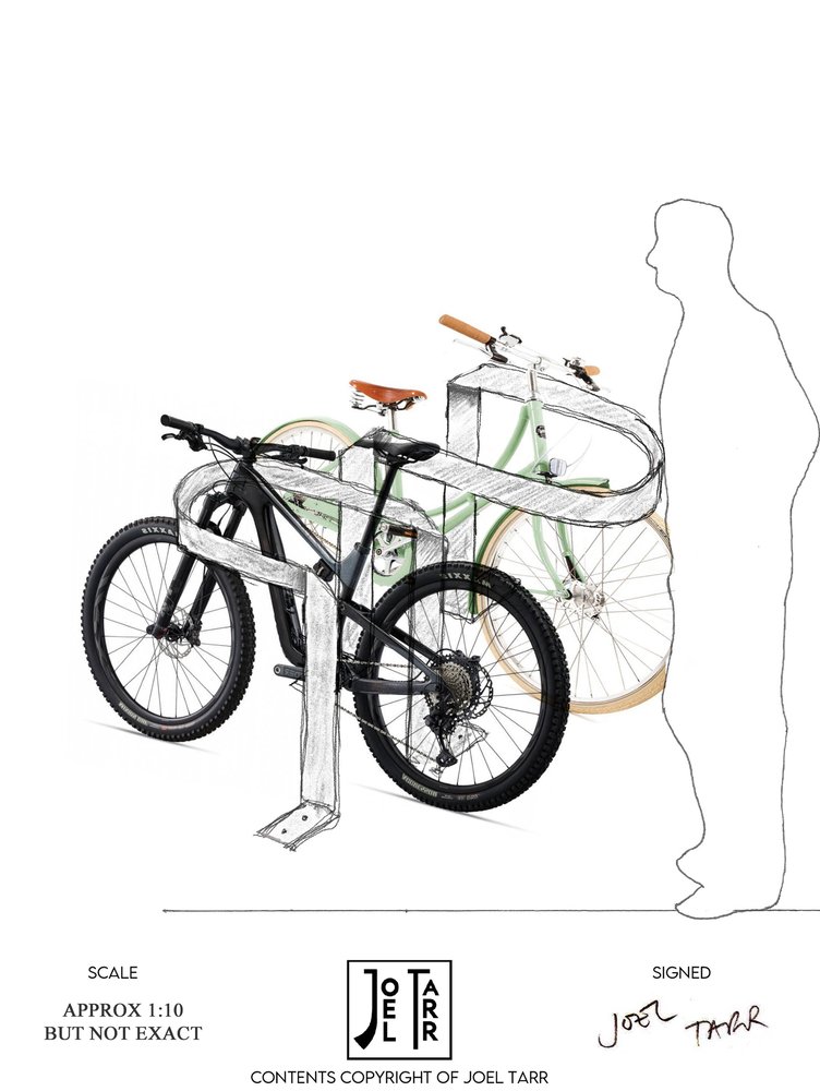

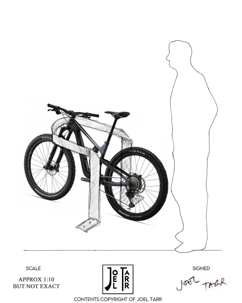

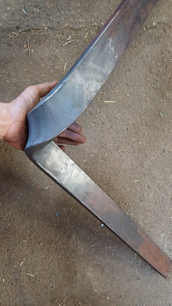

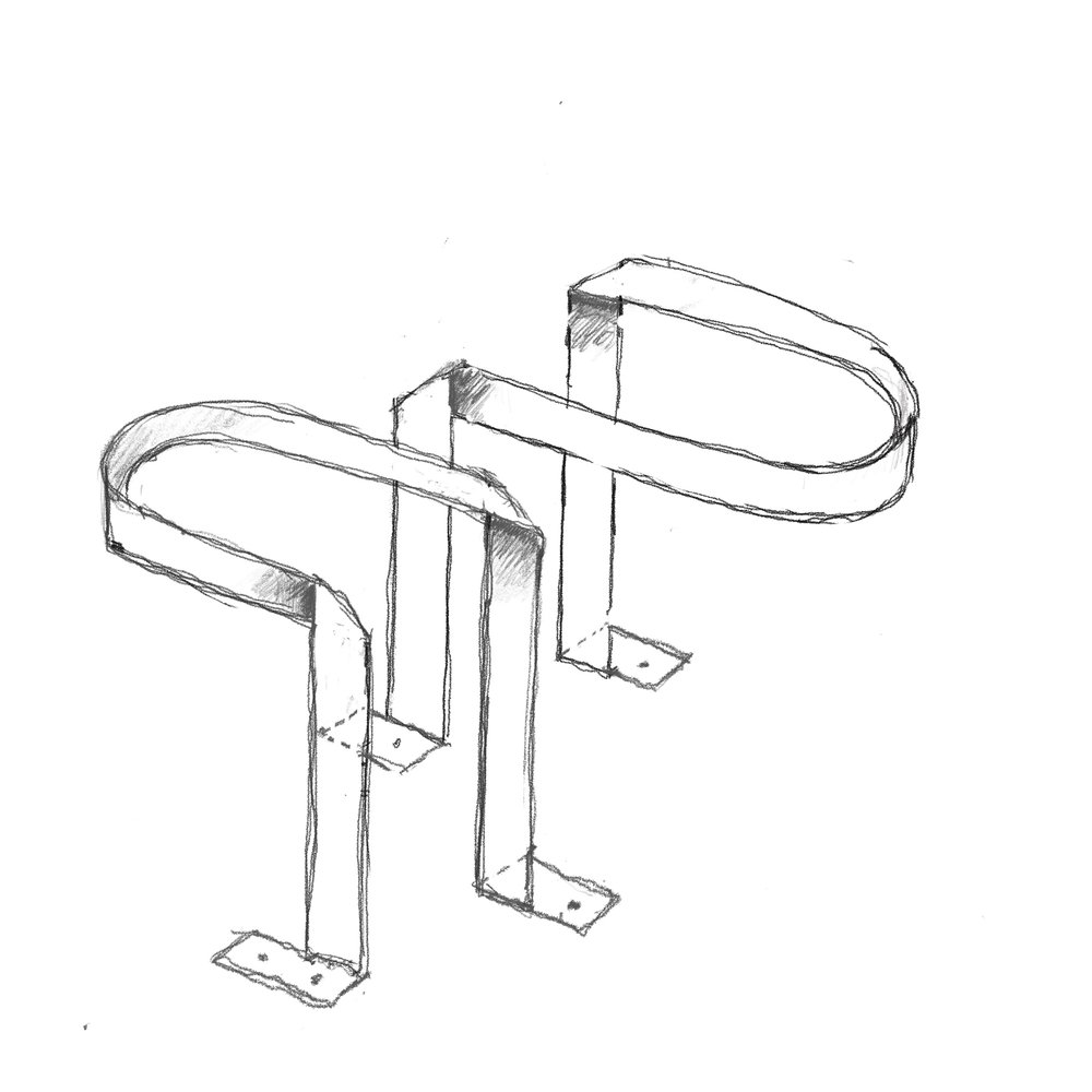

Hi all, I have a job I'm quoting for, it's a bike rack made in 60mm x 20mm flat bar. There will likely be 10 sections. I have attached some design pics + some pics of a sample fold.
Each foot will have 2 fixing holes. What size studding would you recommend? I'm wondering of 16mm stainless studding 100mm deep with shear nuts will be good enough?
And does anyone know a good supplier of shear nuts? From a quick Google, 16mm galv shear nuts seem to be circa £1.50 each!!!???
