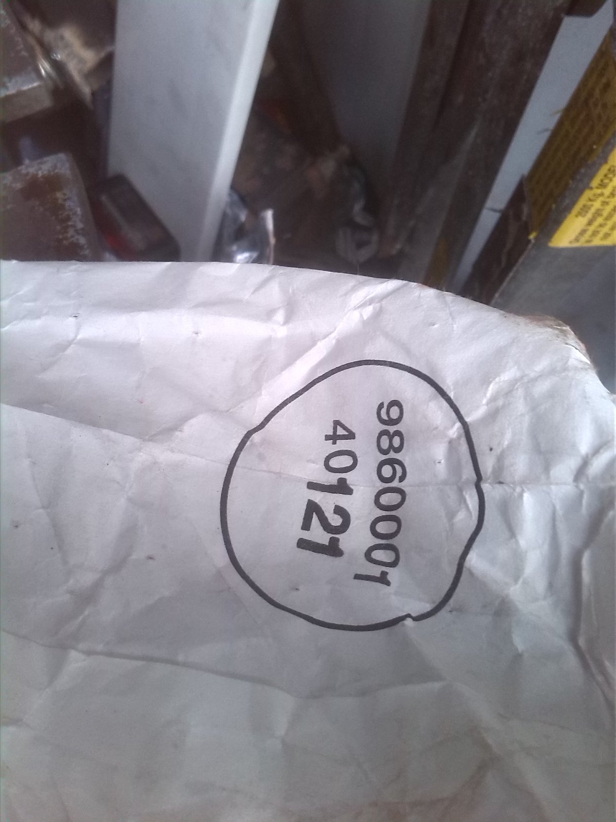

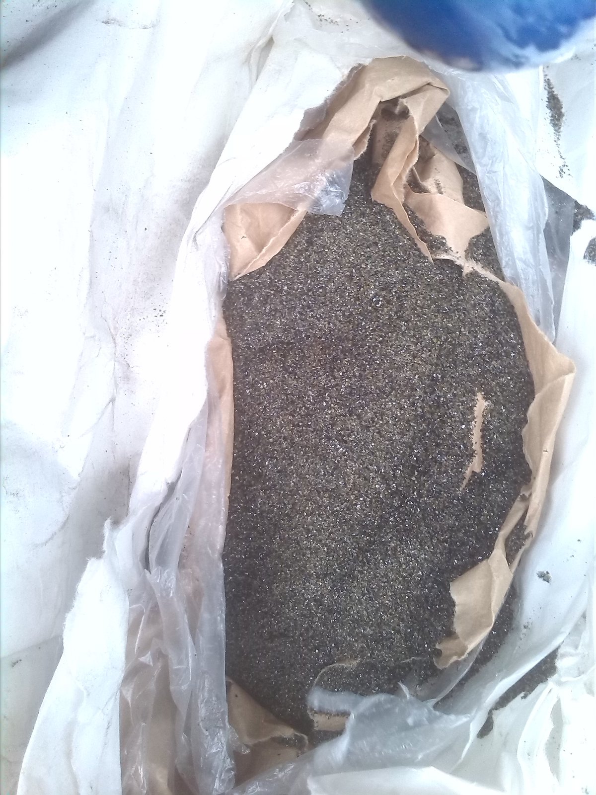

I have a quite few bags of it so was hoping it could be used to clean up some steel wheels, chassis bits etc.
Being new to blasting, and having read postings here, i was concerned with regards to it's makeup and PPE

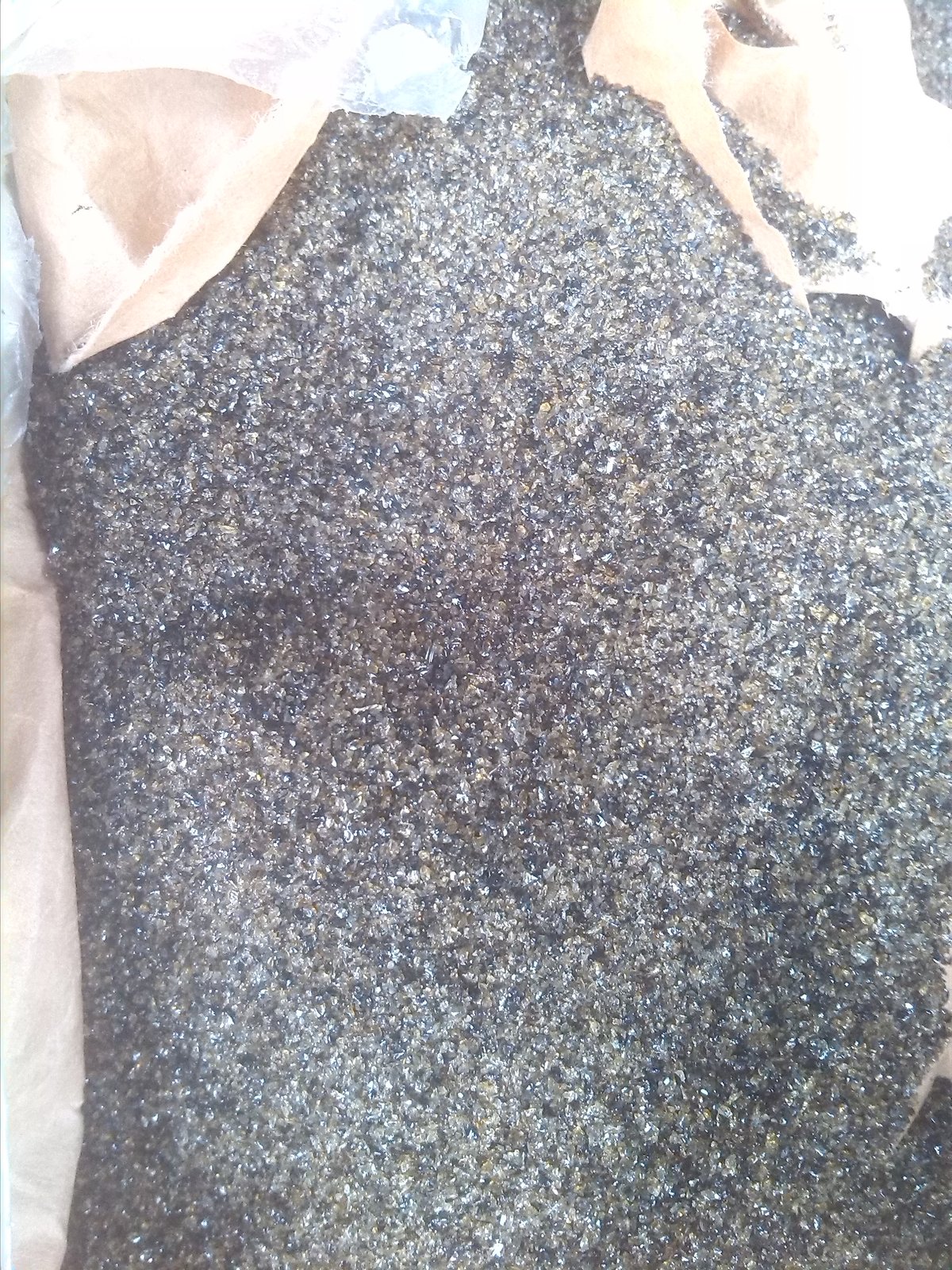

Yes, i was guessing that was the grade. Like you i found nothing on the numbers hence the back to basics visual query.On the first pic, is that 0.09 to 0.5? I can't find anything else on those numbers, guessing thats in .mm
It looks like pretty course glass but hard to tell
its not copper slag that's what I use as someone said it looks like crushed glass obviously not just clear poss green and brownHard to tell from the pics but that looks like the black slag stuff. It is very sharp and abrasive - great for steel. Can be reused. Produces a lot less dust than sand.
