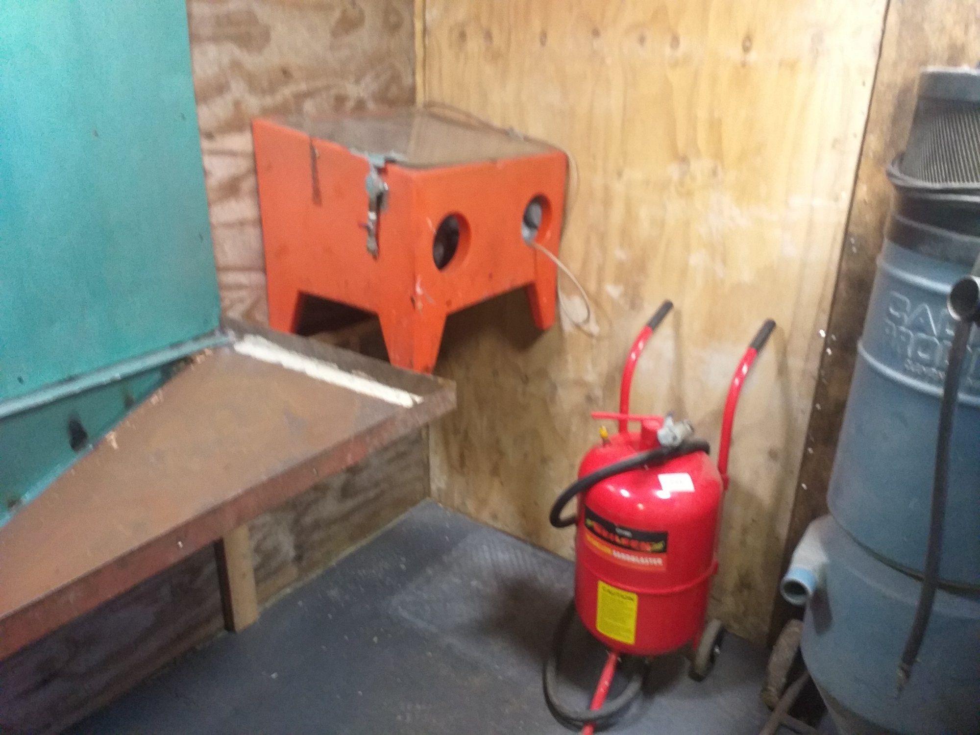

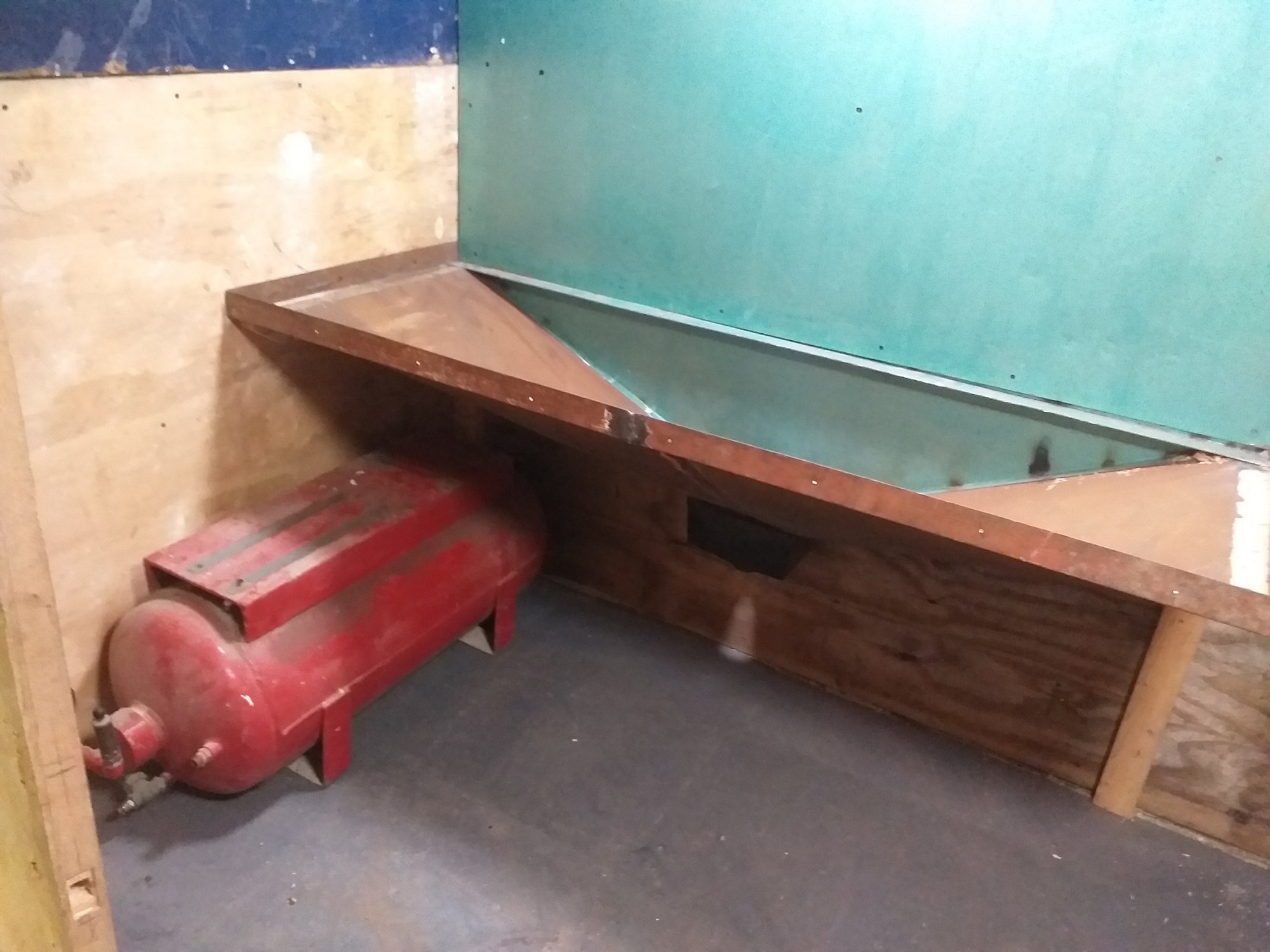

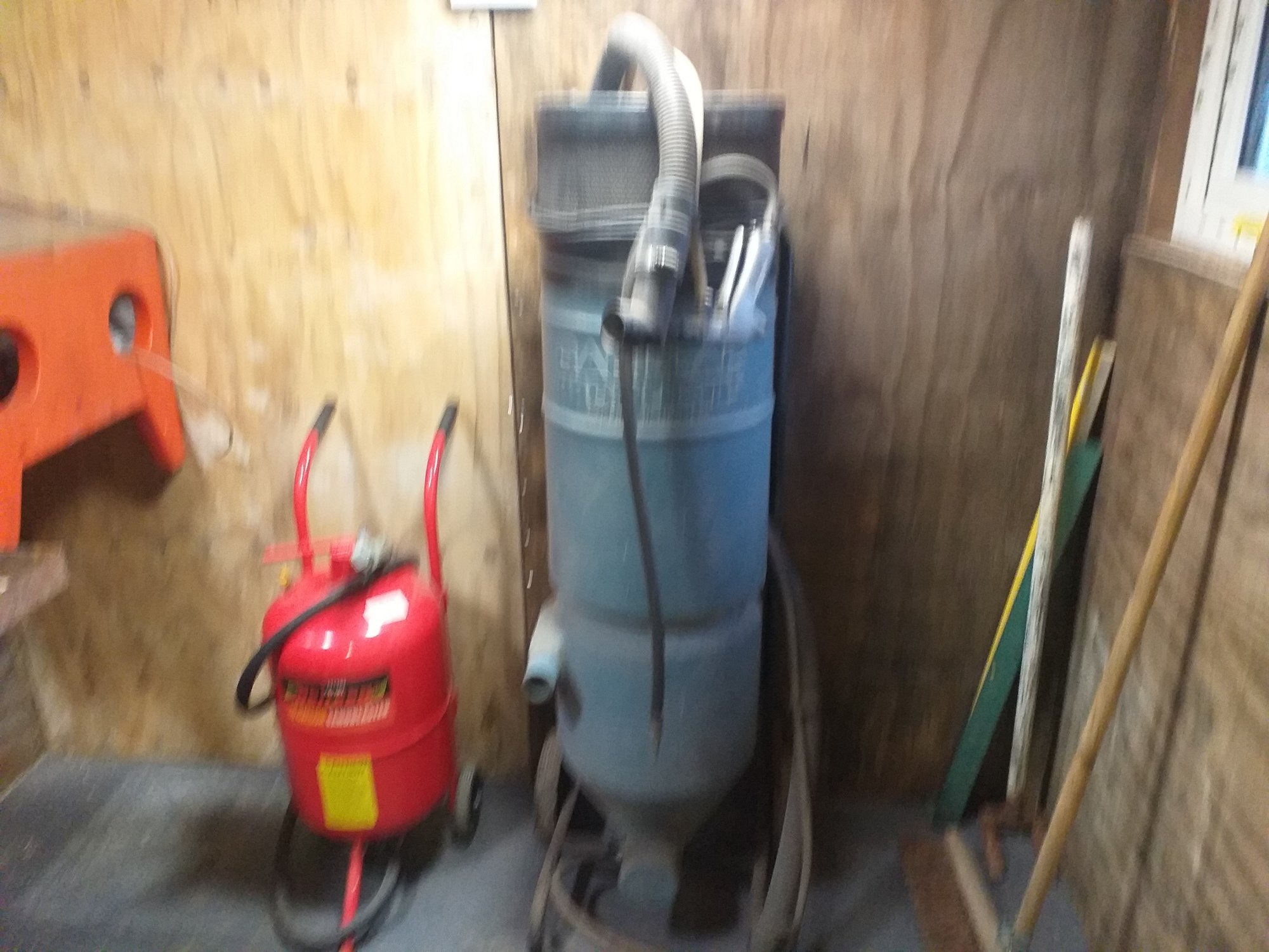

similar to the recent post, setting up my blasting room, I used to have a homemade cabinet with a suction setup before, mainly glass bead, but would like to be able to blast a motorcycle frame or car bootlid / bonnet within reason so I have made a 6' long 2' deep trough, will make the front when I get the tig going, alloy frame, maybe two viewing windows and four glove holes, I have the 10 gallon pot pictured, auction find, and the portable suction / extraction setup, thinking of using that to extract dust from the cabinet but still have it available for blasting in the workshop, I think using the pressure pot in the workshop will be just too messy?? I also have the Clark? benchtop cabinet that I will use for glass bead, and an extra tank on the floor,
I understand there is a post regarding mods to the pressure pot, I will look that up, never used one yet.

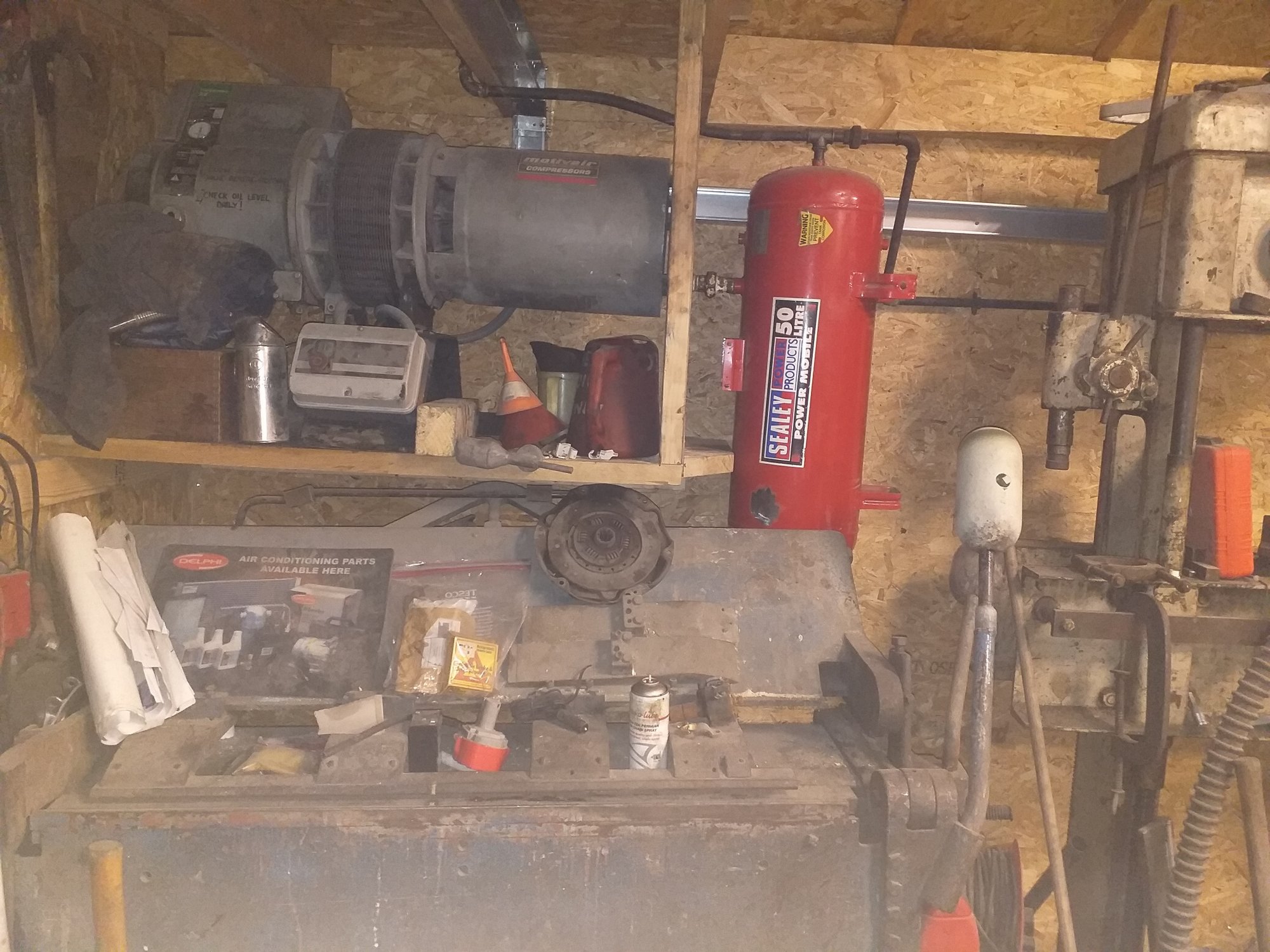

Should I put the final water trap before or after the floor mounted tank?
I suppose if the dust extraction in not enough I can alter it later, will be a big cabinet so may need more, also I had thought that I may add a small say 750mm square table in the corner under the window to use for plasma cutting (Lidl special) as most of what I do will be either on the car or smaller parts for motorcycles then I thought why not plasma cut inside the blast cabinet, well lit, extraction, what have I missed? thoughts on the above please.....
any thoughts?
