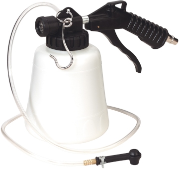

Just rebuilt the master cylinders on the 1963 Silver Cloud III. Cleaned the reservoirs and replaced the flexible pipes on the feed side.
Struggling now to get them to pump any fluid. The design of the master cylinder is very similar to the RD250 I recently rebuilt. I struggled with that too! Eventually I used a pressure bleed system which required drilling a spare reservoir cap. I don't have that luxury on the Rolls-Royce.
Does anyone have any experience of bleeding these things? How do you get the master cylinders primed and pumping?
