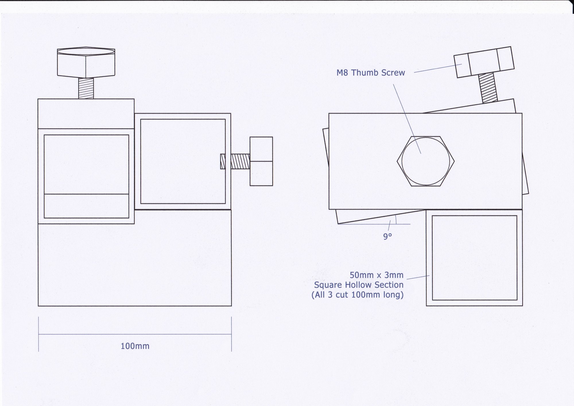

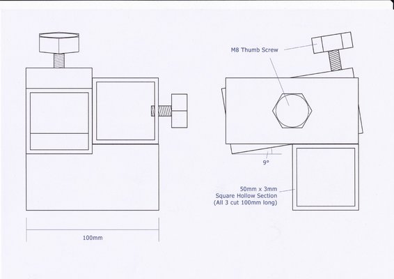

The thumb screws are just to hold the bars in place.
Thanks for the info. If you google abba front lift arm you can see lots of info and pics etc. It looks like this:
The inner tubing will be 40x40x3mm so should fit in good might be a little loose, i think i will just drill a hole and then tack nuts on. Saves me having to tap holes. Thanks
The drawing is clear but it's missing lots of essential info.
No dimension for where the holes are placed. No reference points for where any thing should sit apart from the 9 degree angle. No thread length specified
I can see what your trying to make and I don't suppose it matters so much but on a more critical item details are important.
