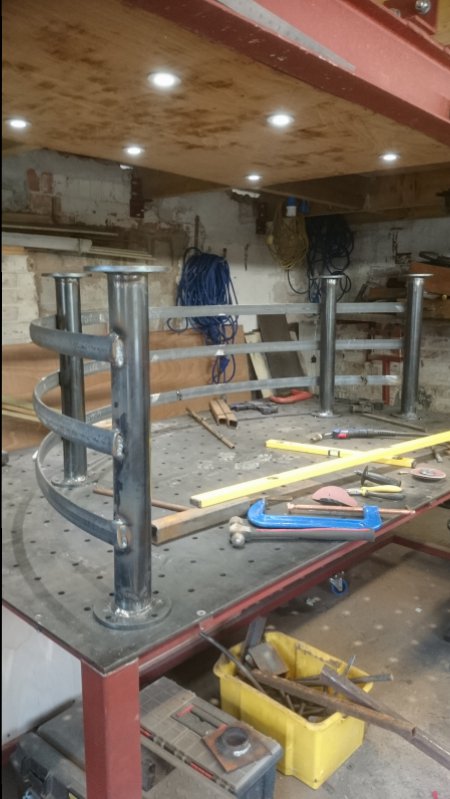

Well the rest of the barge isn't
A fair point to raise though it's 50x12 convex to 5mm wall tube sealed at both ends with 10mm plates
Red oxide primed and will get a few coats of hi build blue after fitting
Guesses how long it might last cruising the canal network rust wise?
My bet is it will meet an immovable heavy object first it being on a hire fleet lol
