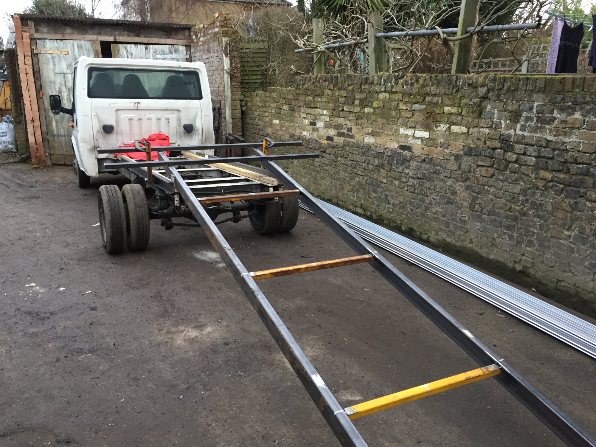

New to this forum,i build my own recovery truck bodys as a bit of a hobby/work and i have built plenty of beaver tails so i decided to try my hand at building a tilt n slide.....as expected my first attempt failed!

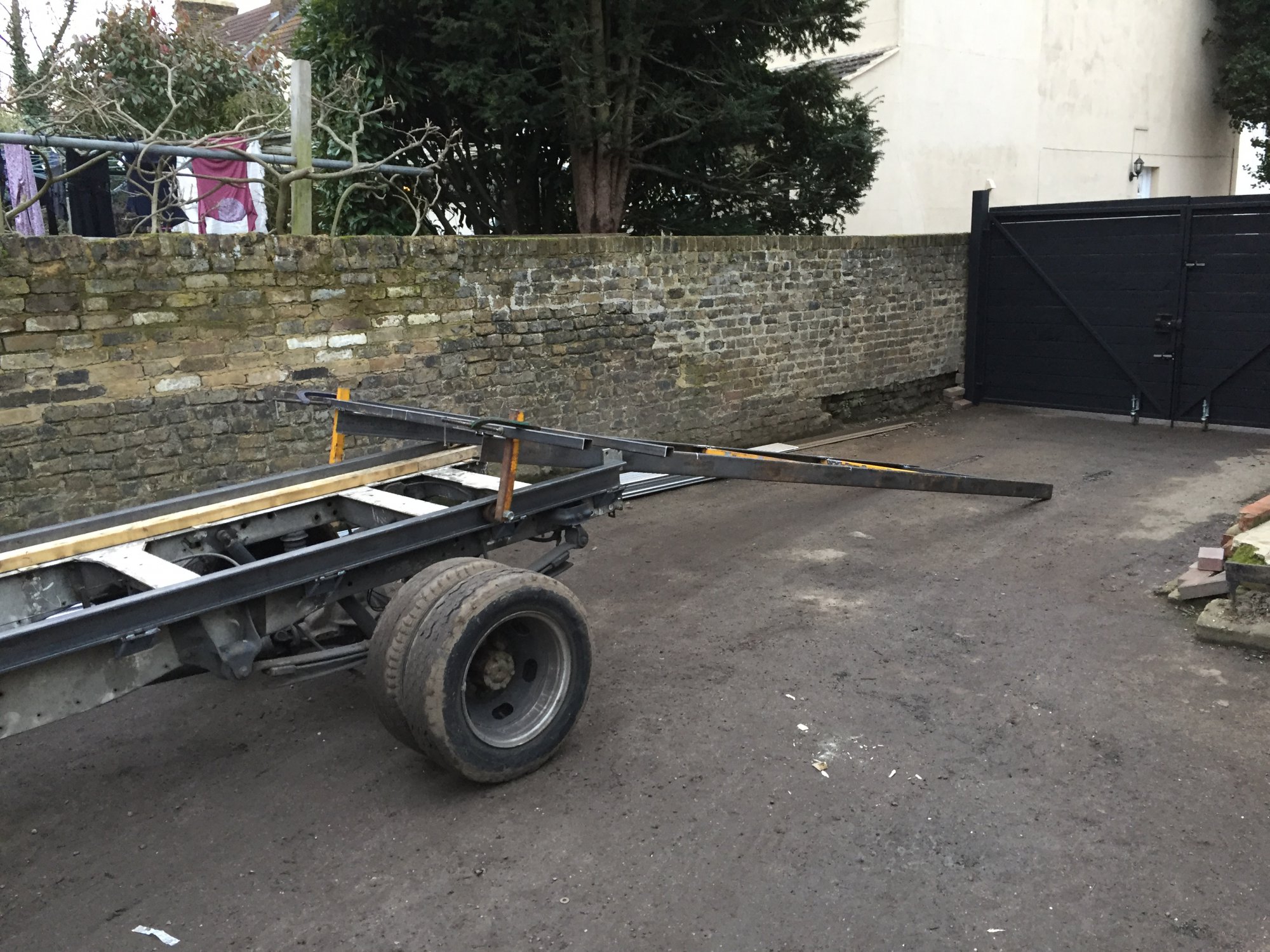

With my beaver tail body's everything is generally 3mm thick 40x40mm box section so on the tilt and slide runners i tried 100x50mm c section channel 3mm thick and as a test trial i loaded it with a 45 Gallon diesel drum (full) and after a few passes sure enough the c section kinked so i sort of gave up with that idea.
so my question is would two lengths of 100mm x 50mm box section at say a maximum of 4m at a slight incline support a vehicle (2.5 ton) and if it would what thickness would it need to be?
all suggestions appreciated

I reckon he was on the right track with the 100x50 C section, by the time the outriggers are added in conjunction with the 40x40 box on top and the floor that lot will be very sturdy. Probably leave very little in the way of a legal payload on a truck like that but that's another fight.
