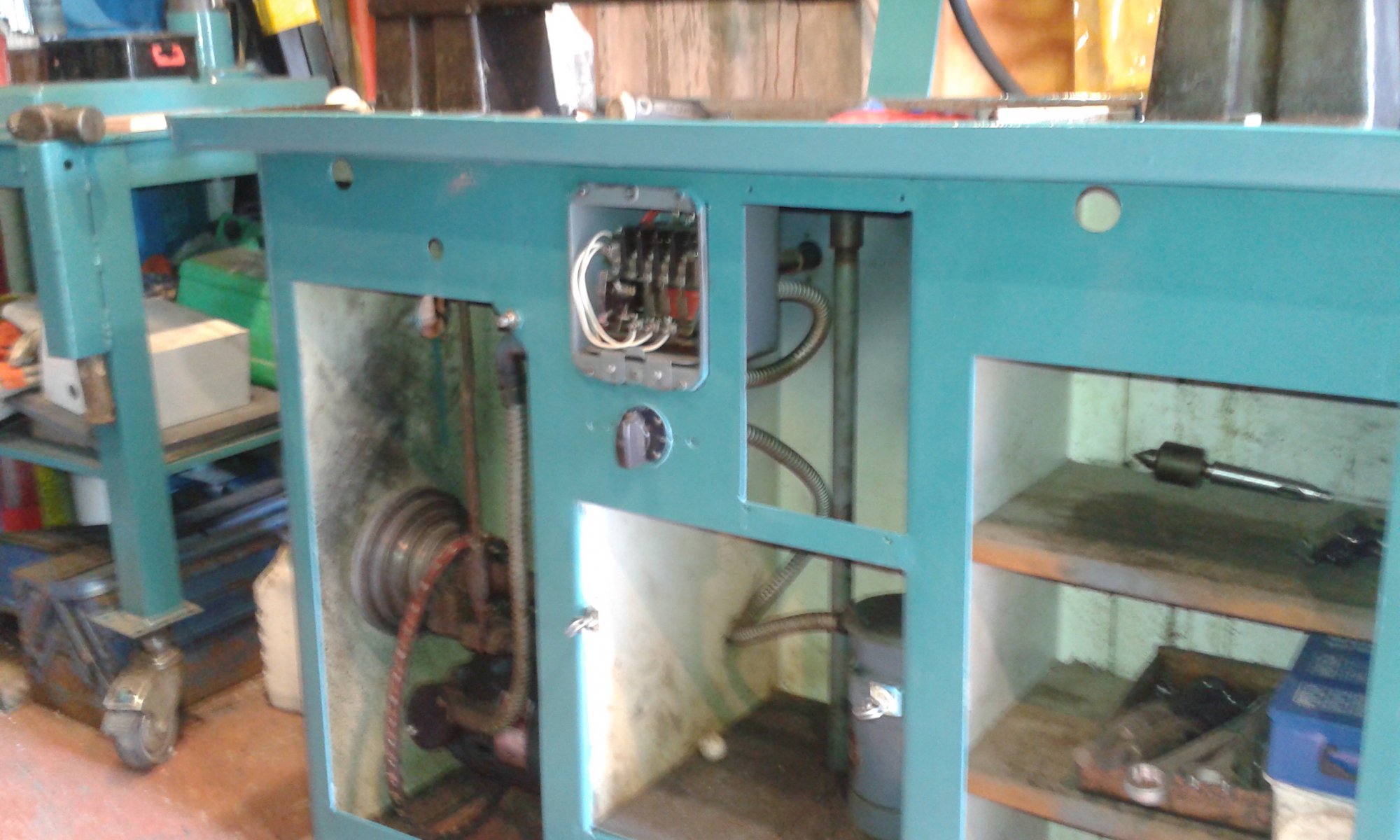

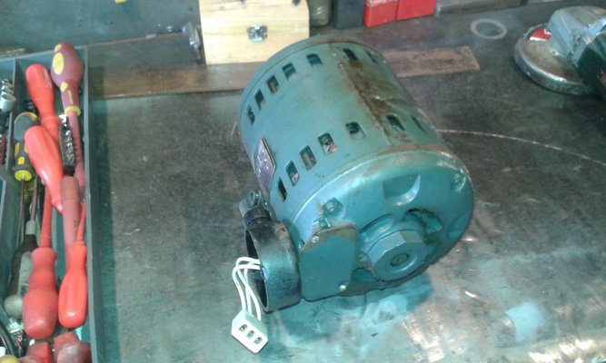

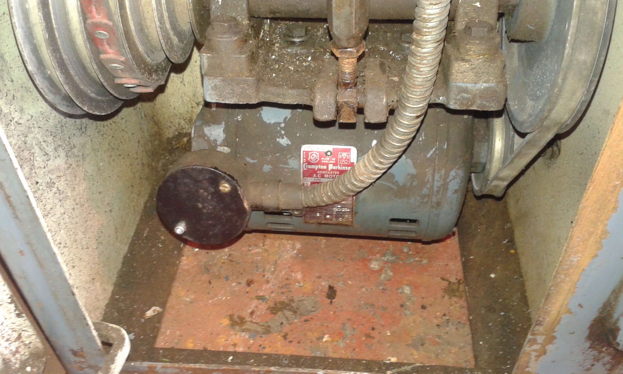

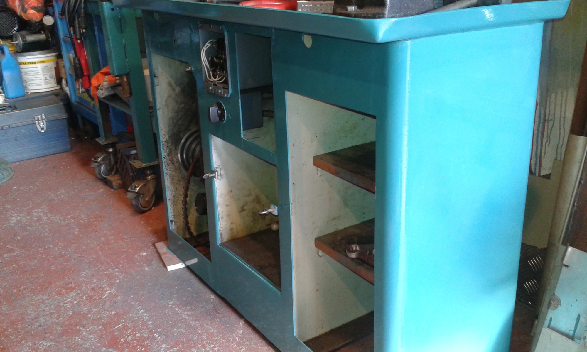

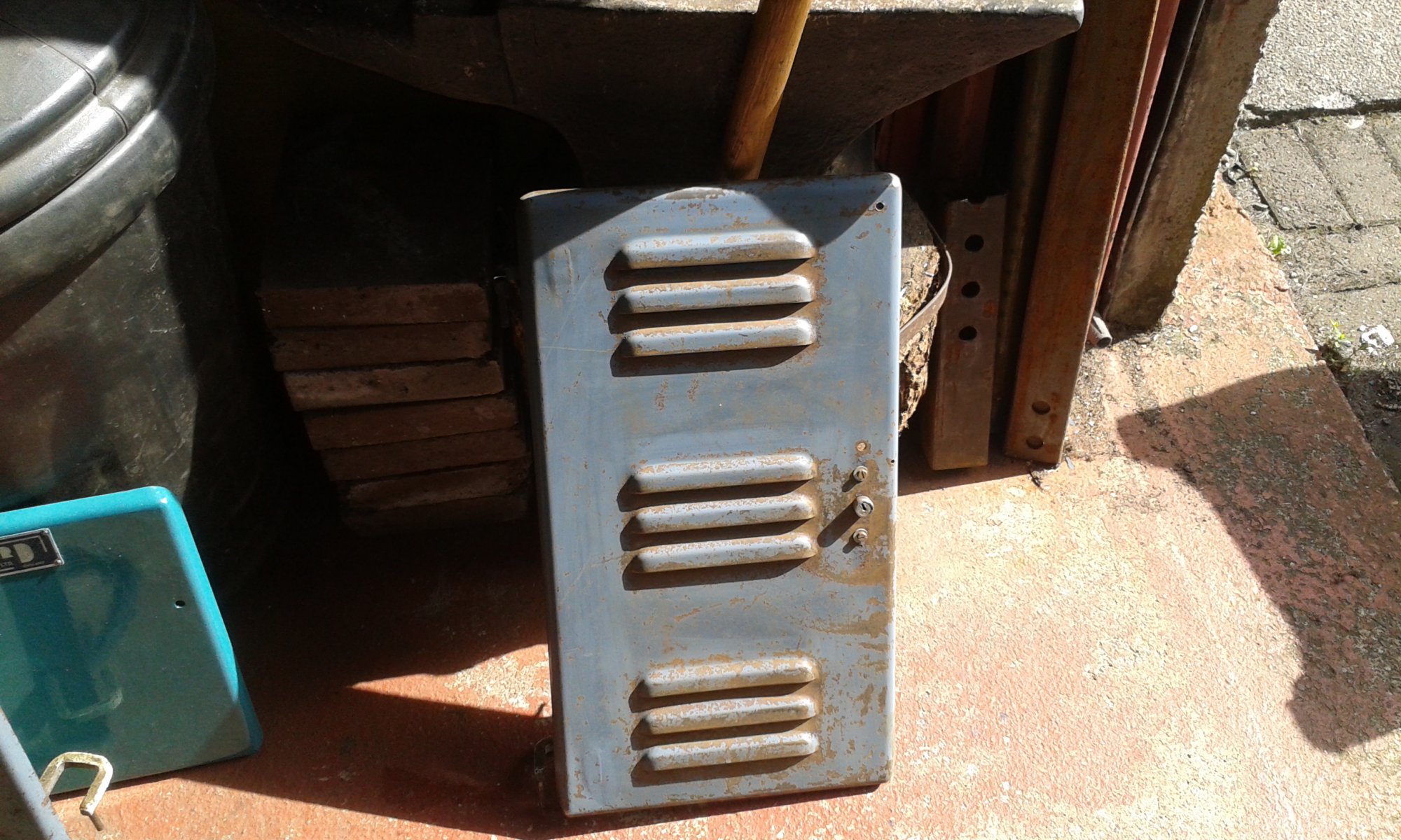

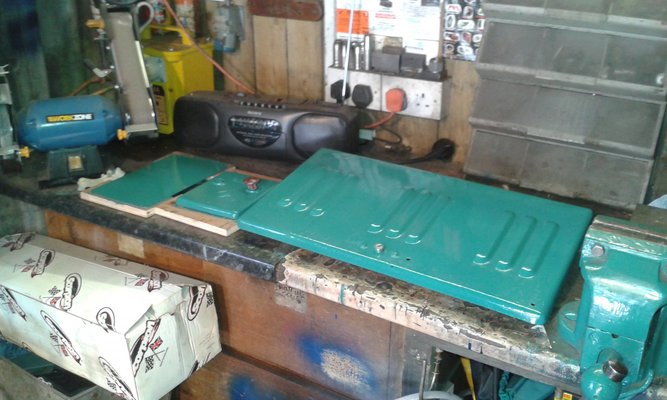

Aint gold... i recently took delivery of a lovely little boxford which looked the part, and seemed to function ok (powered up and spun the chuck). i was out in the workshop today and was swithering on whether to do a complete strip down or a quick paint job just to pretty it up.

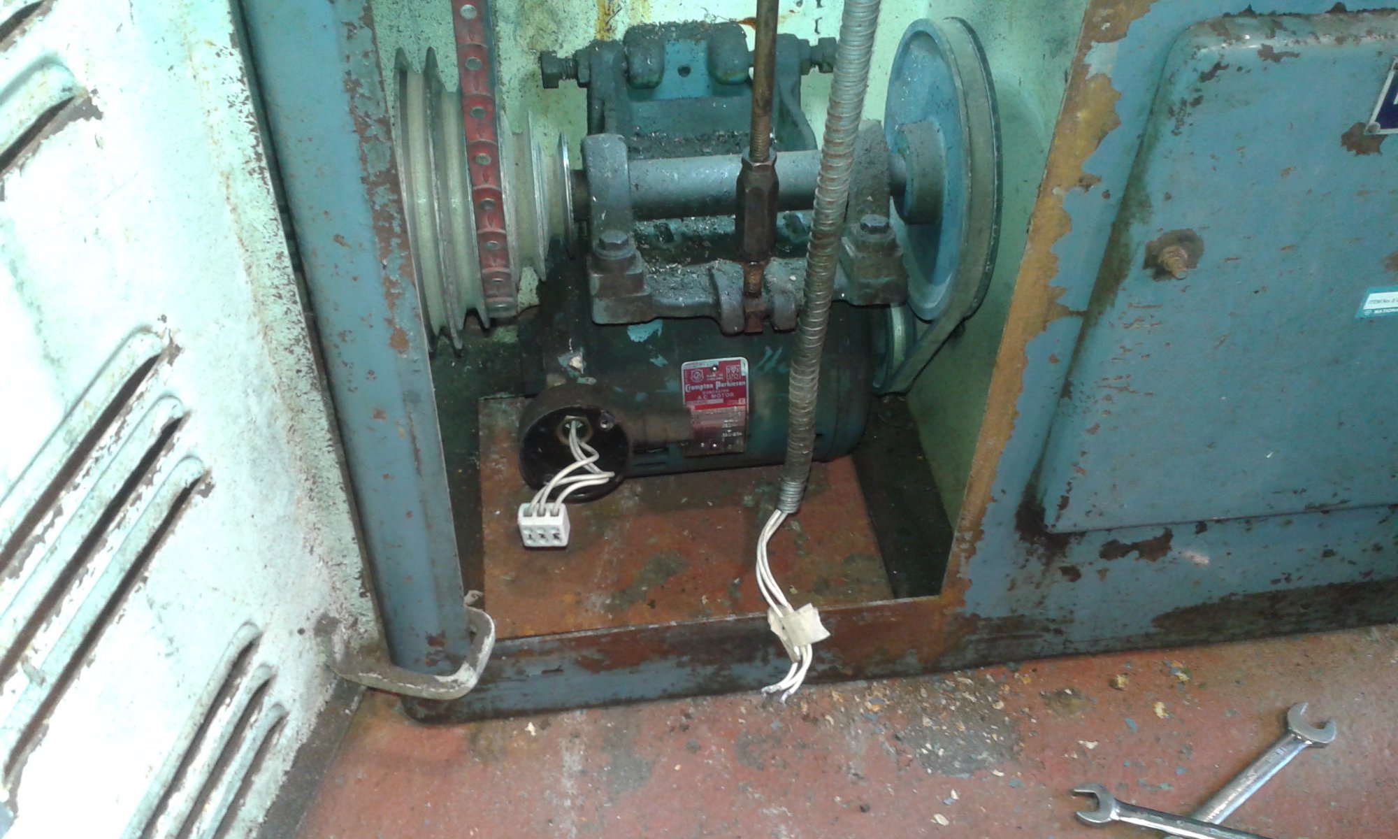

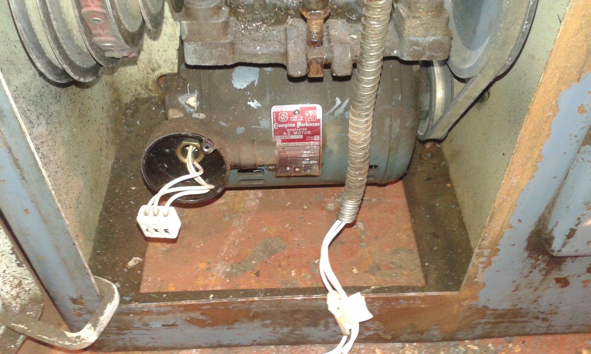

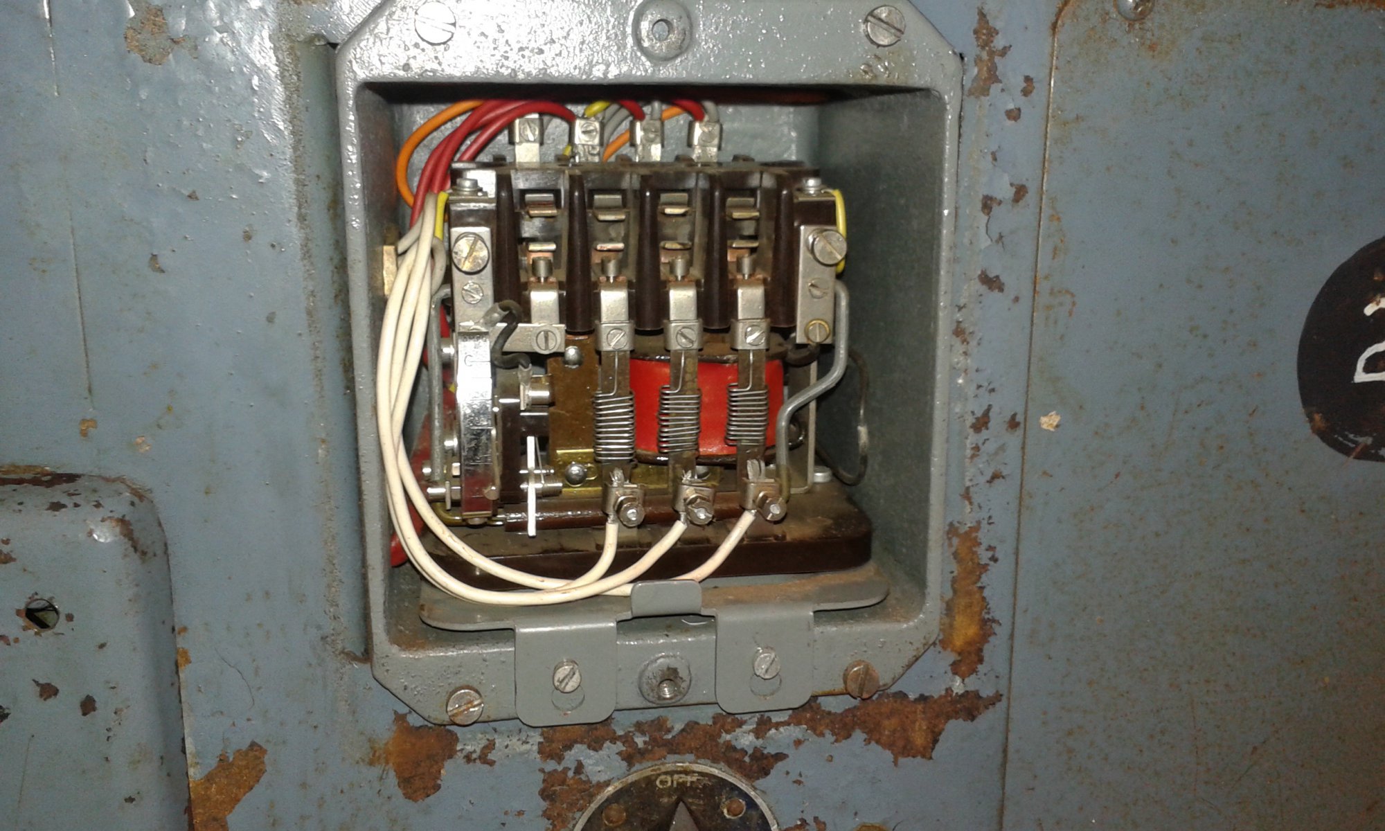

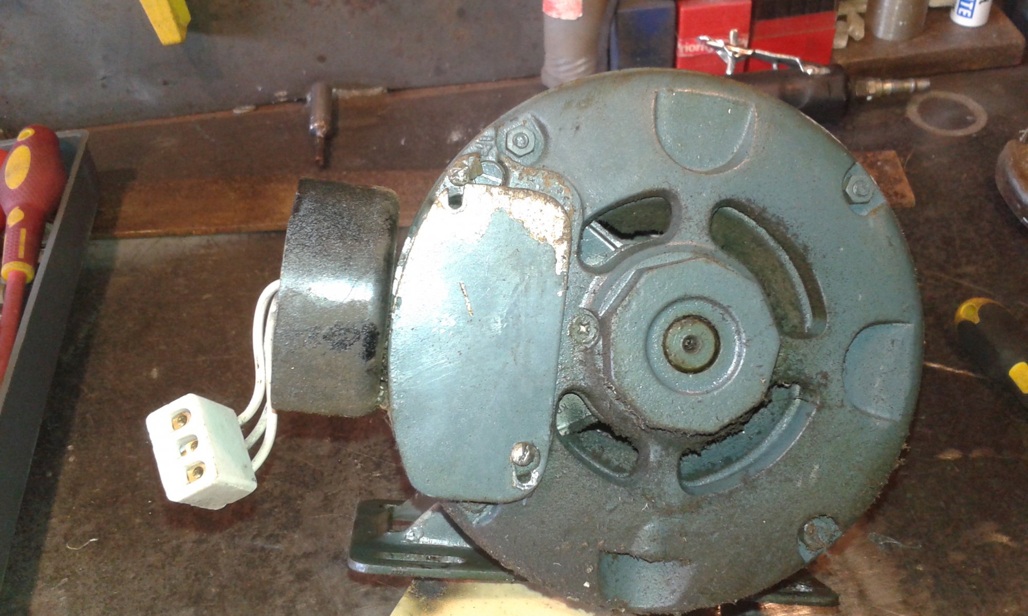

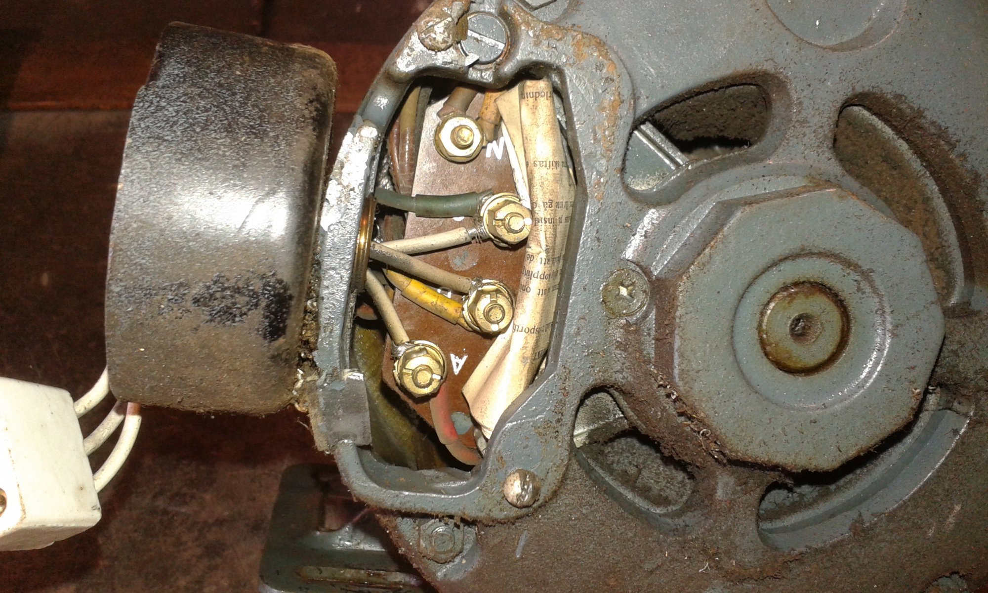

well after wiring the motor for 220 3 phase and re-installing it i hooked it up to the vfd and ....nothing, not a sausage. after a bit of investigation i came to the conclusion the switch doesn't work with 220 3 phase, i think the contactor is a 440v setup. if you manually close the top of the contactor with an insulated screw driver the lathe runs and the contactor will indeed stay closed however once power is shut of and reapplied you will have to manually close the contactor again. looks like i will need a new switching option.

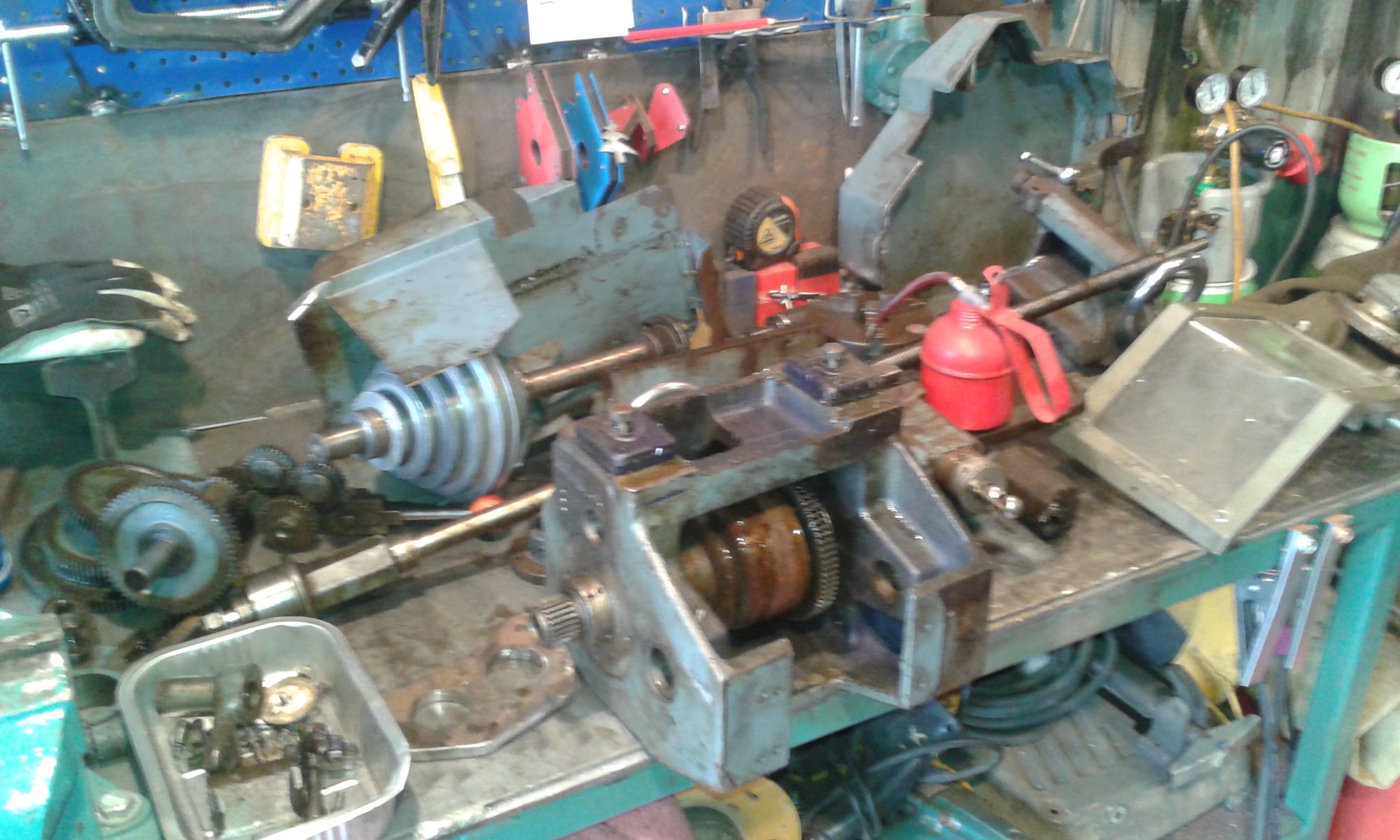

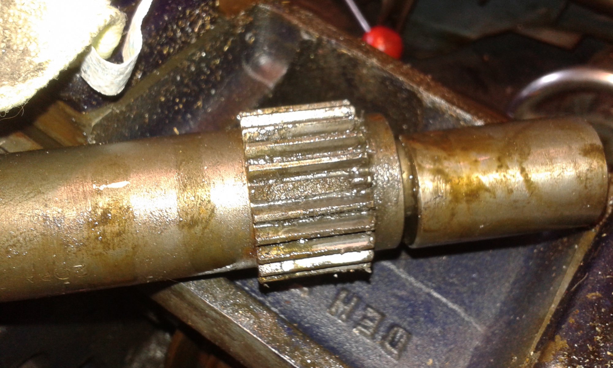

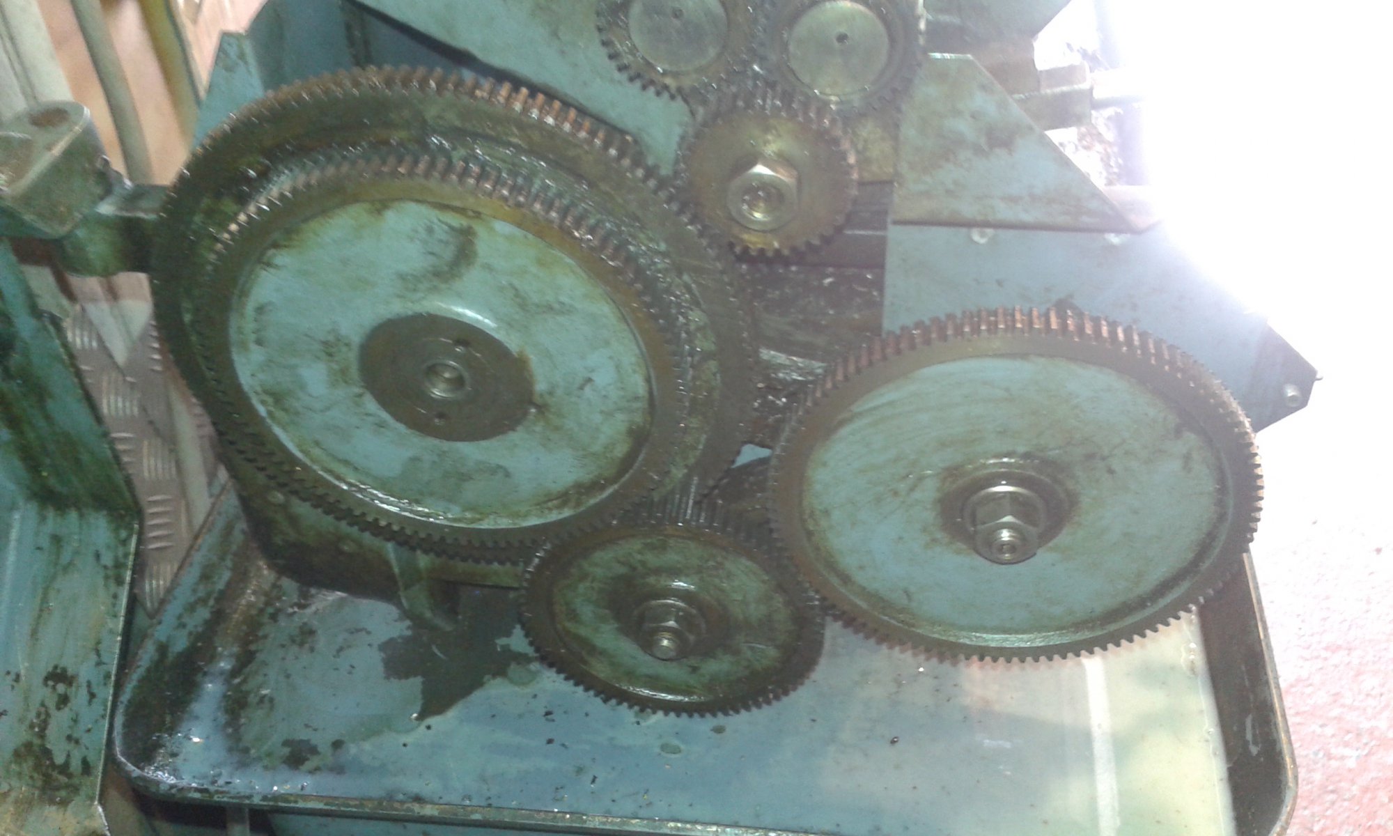

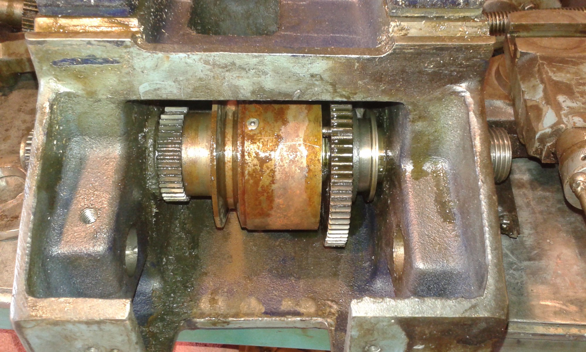

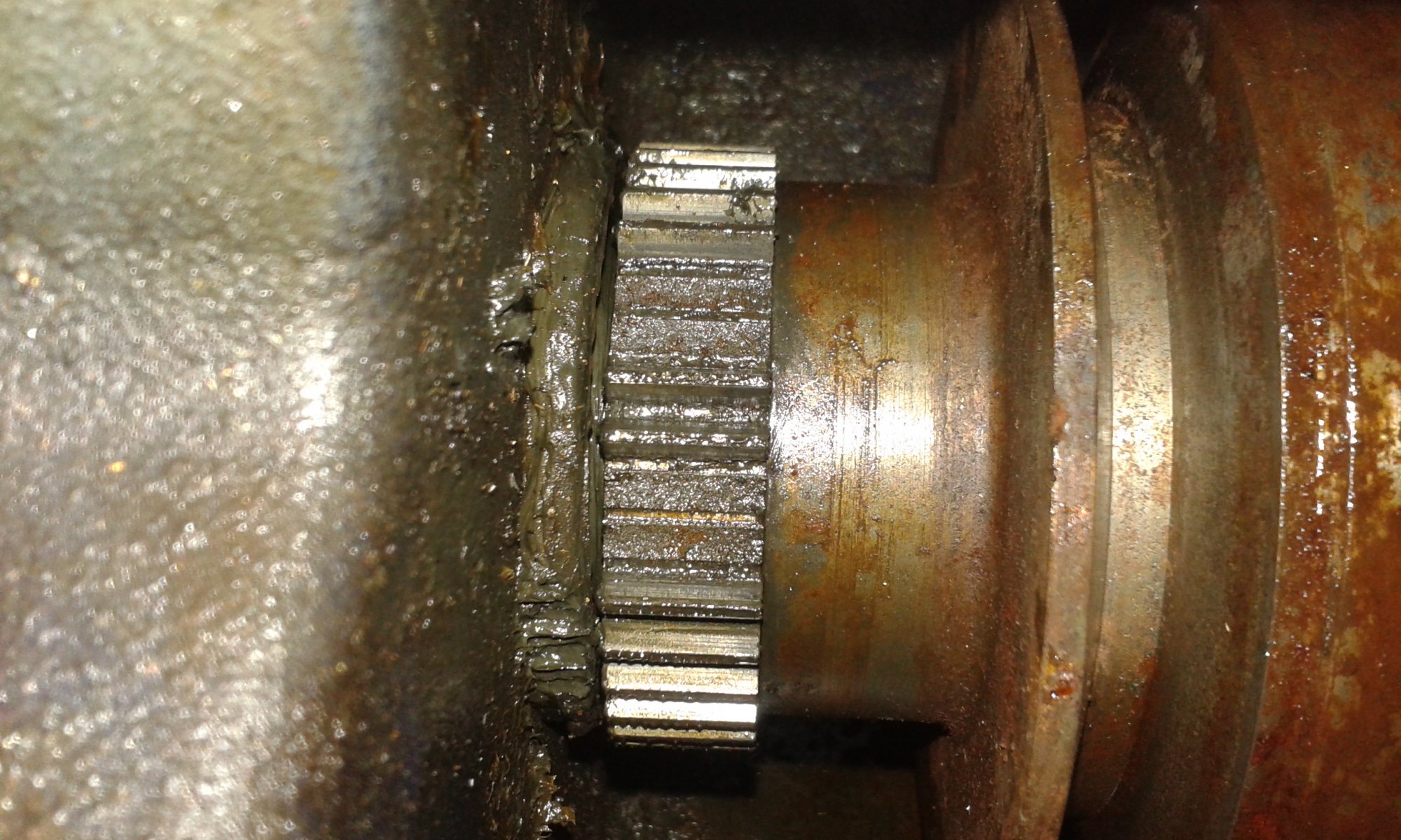

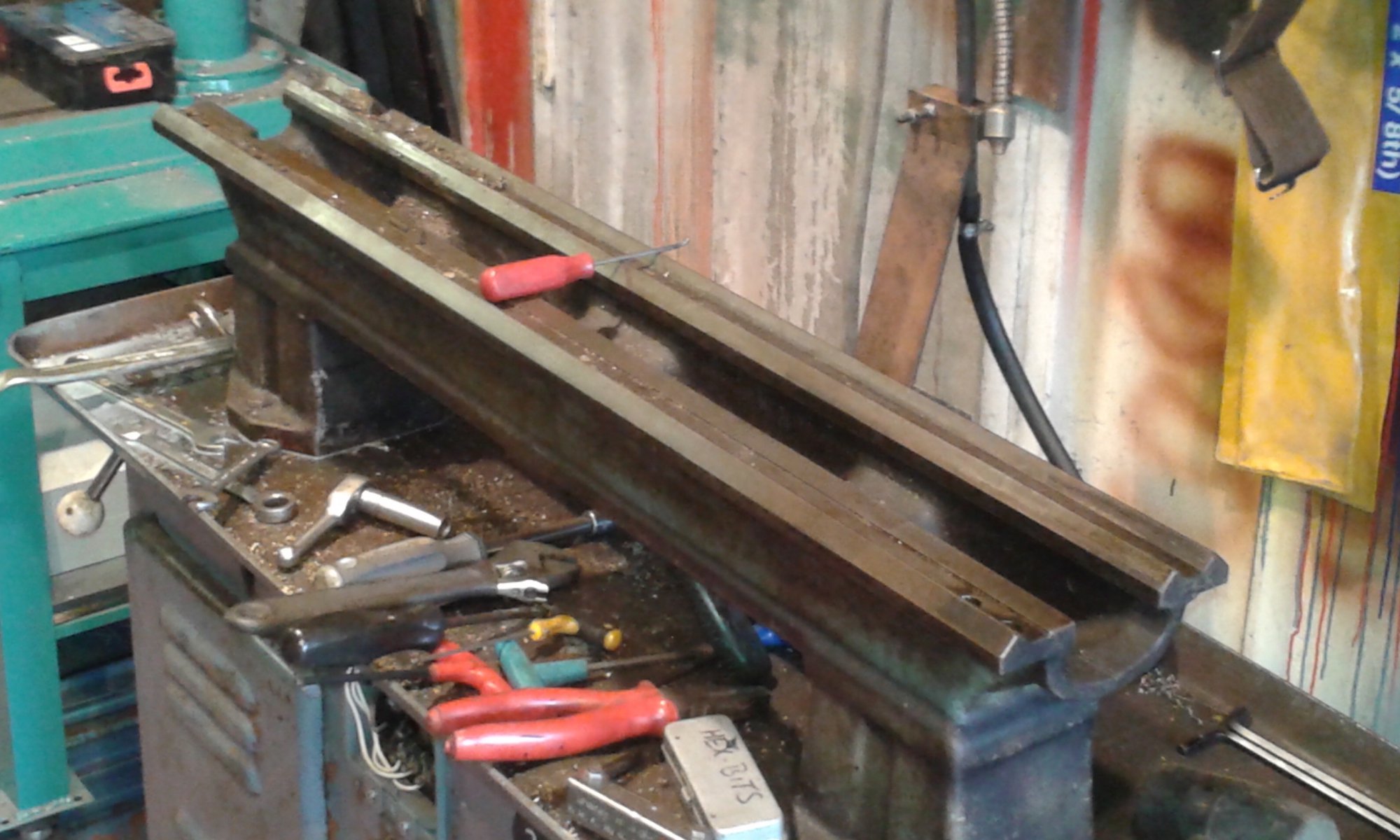

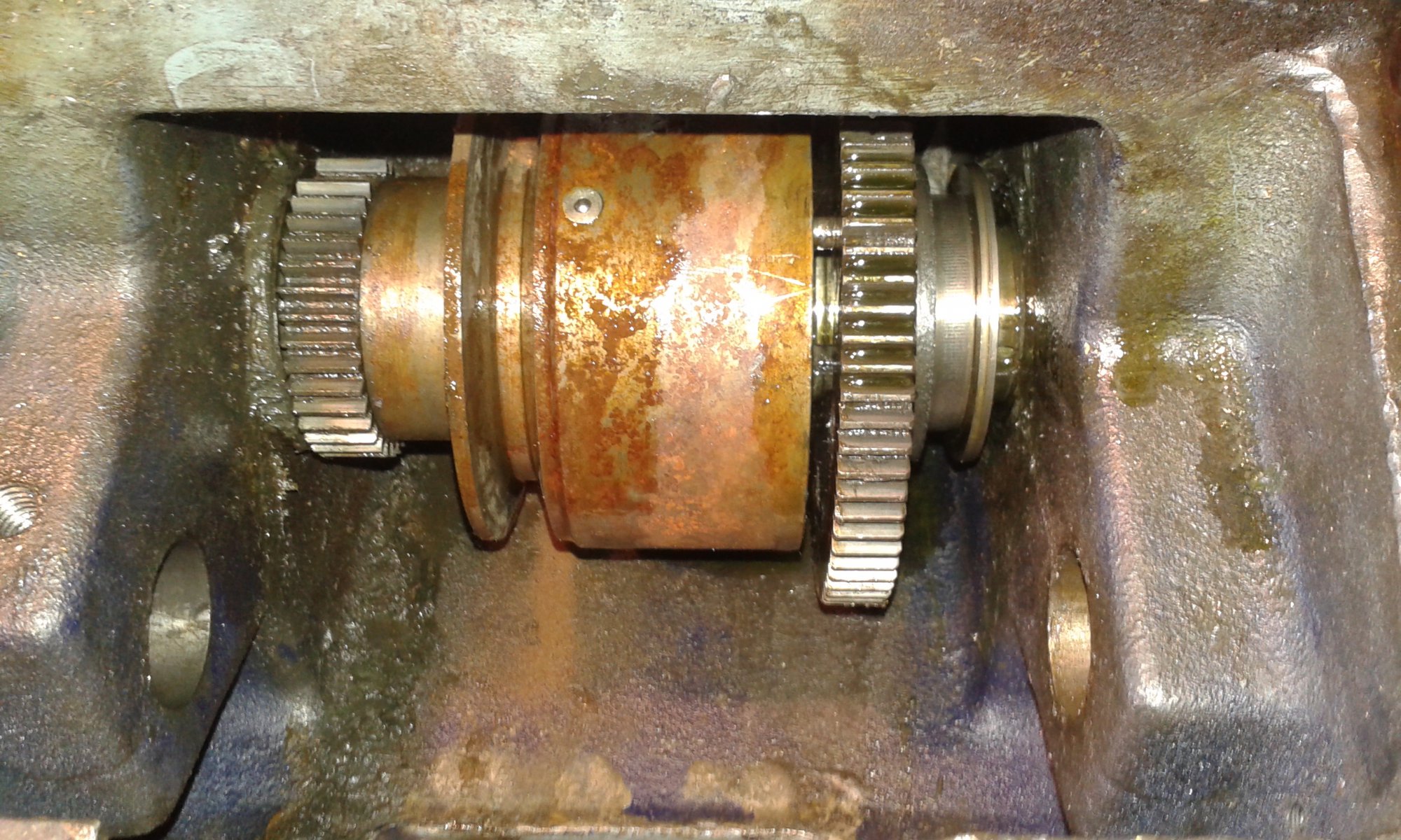

i couldn't get the back gear to disengage so decided to do a full strip down to investigate whats going on with the gearbox, after a bit of work i finally got to the point where the box was sitting on the bench and it looks like someone has been changing gears whilst the machines been running, two teeth are missing from one of the gears which shouldn't trouble the running to much, but the spring and ball bearing arrangement that hold the back gear selector in position is causing the lever to jam, further stripping down revealed the dimples the ball bearing locates in are actually pretty deep with sharp edges and wont allow the lever to move.
does anyone have a link to a manual for the box, and does anyone know how the gears interact with each other is there some form of clutch for back gear?

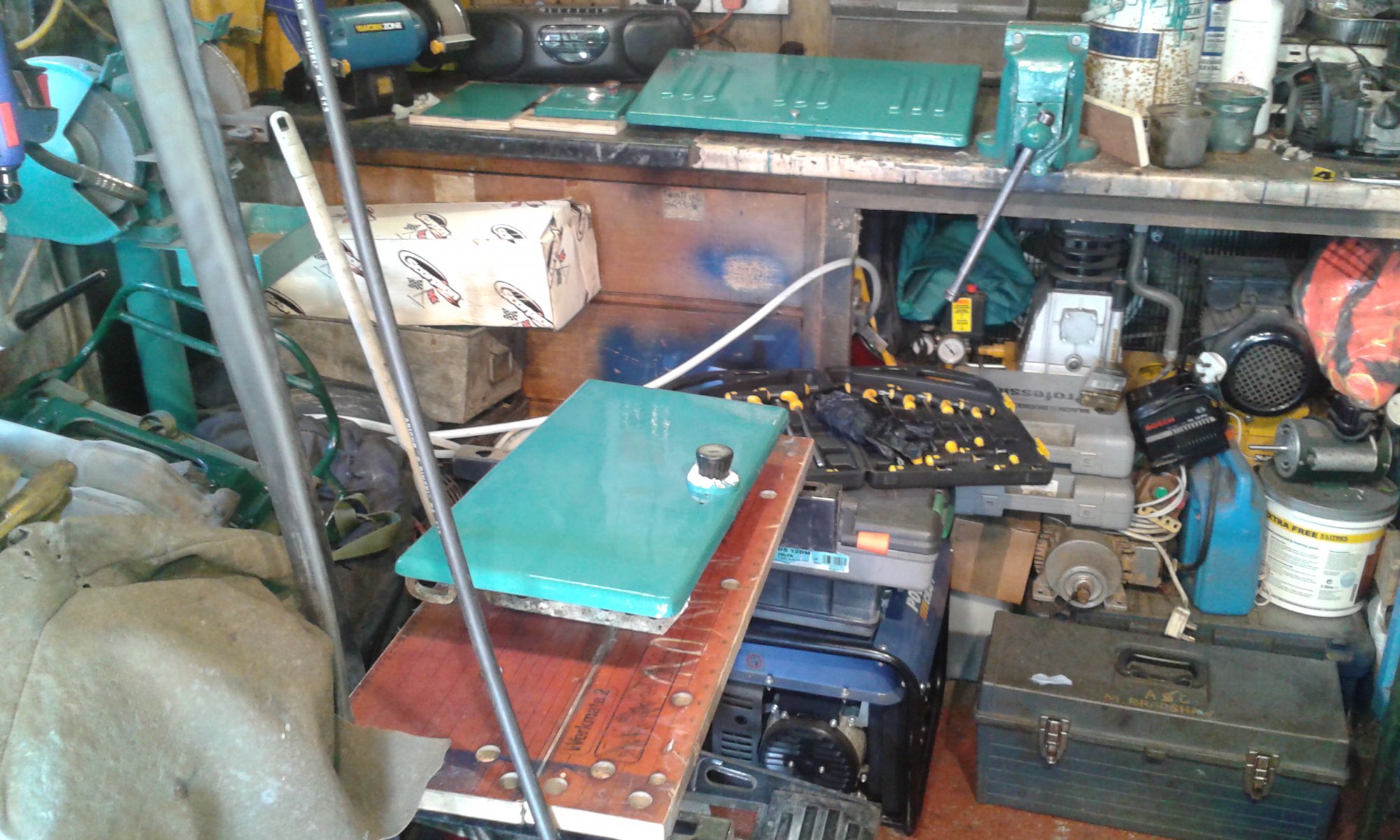

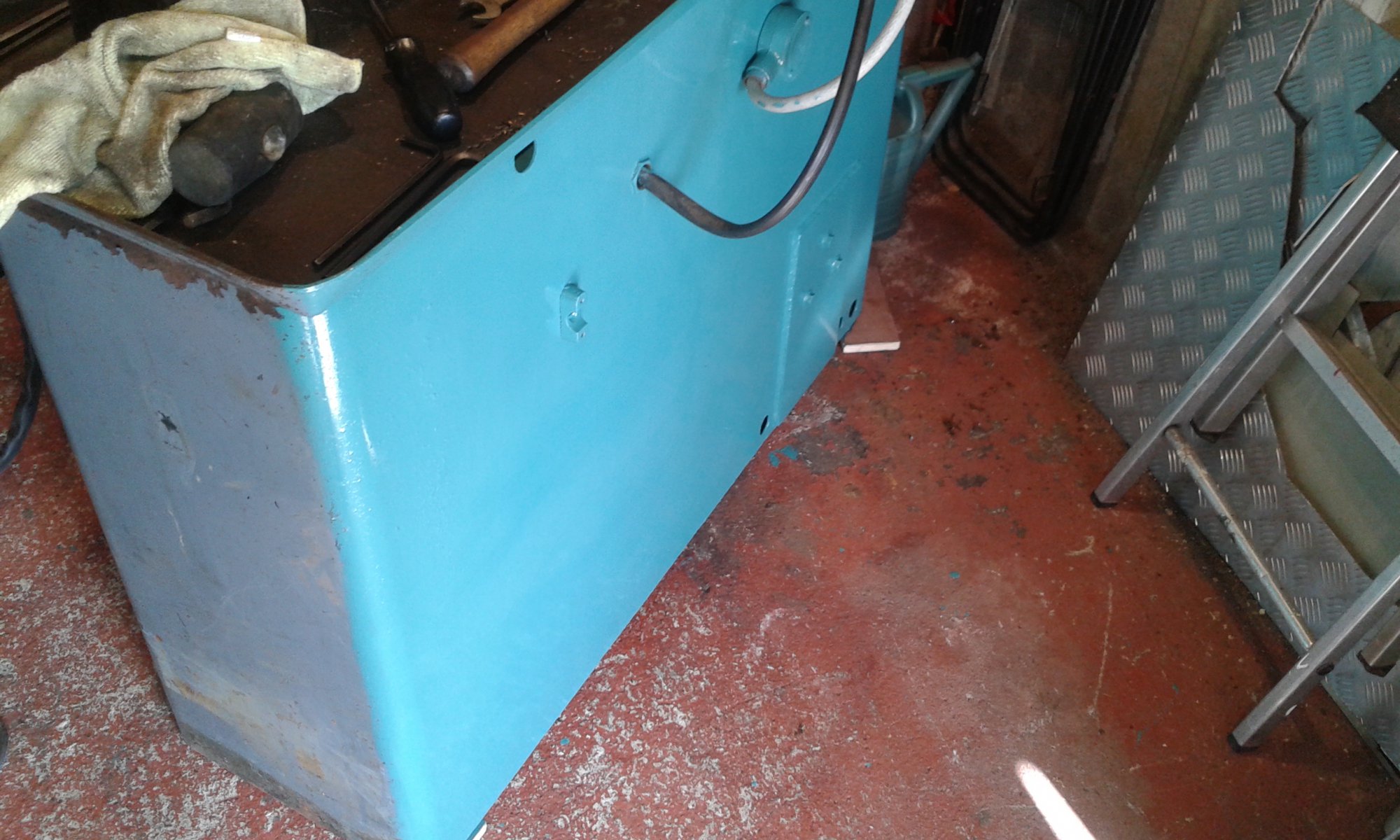

i will post picks as and when i get a chance so stay tuned for a full restoration of this wee lathe...
