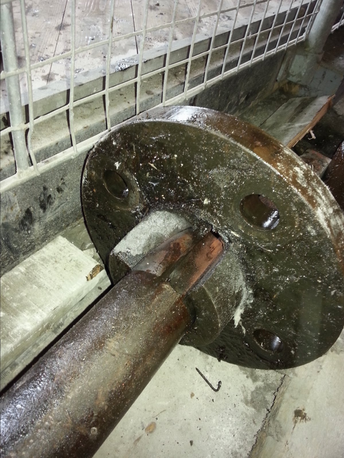

Hi all.
I've been asked to look at ways of fixing a broken flange joint on some line shafting. It's got an old break covered in oil and grease with a new break that is clean. I can either remove the flange and braze up then re fit. I'm concerned that the brazed section wont remain round and in line with the shaft.
The other option is to braze in situ. But is there a risk that I could braze the shaft onto the flange. I'd like to avoid this incase the flange needs to be replaced in the future ( breaks again). Though the shaft could be a bit of a heat sink.
I've got access to Oxy act. Or Oxy propane. It's there any benefits in welding this cast iron? I've got experience in oxy.act, mma,mig and tig welding I've brazed a couple of times on smaller sized pieces. But am not sure how much heating this would take to braze.
