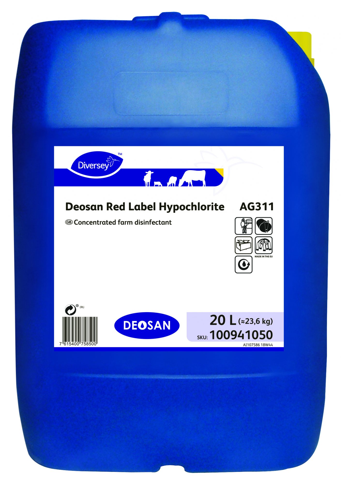

Still available from farm supply stores as chlorinated cleaner for dairy industry.

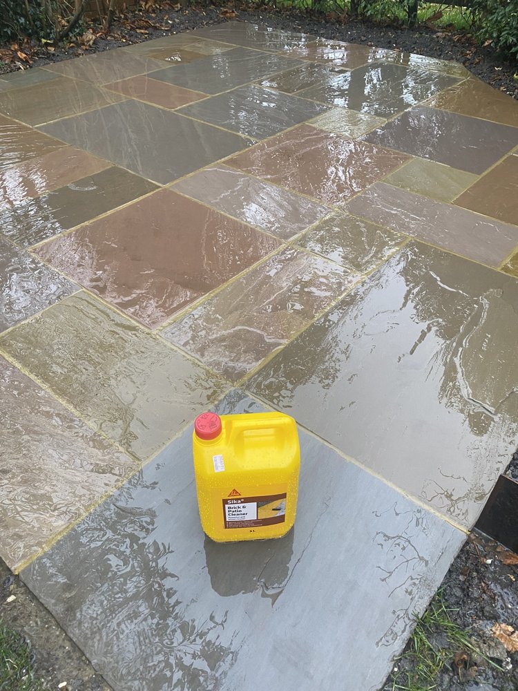

The Siki one just says 'active content', which I assume to be Hydrochloric acid, - 9 - 9.9%There seems to have been a reduction in the allowable concentration of Hydrochloric Acid that can be sold to the general public. Possibly as part of the response to some headline-grabbing acid attacks a few years back.
I really CBA looking up the legislation, but it seems like between the law and voluntary agreements, there's probably a maximum of around 10% Hydrochloric widely available now, where a few years ago, a concentration of 36% was readily available to all. The recommendation with the stronger stuff was usually to dilute it at least 2:1 for use as a brick cleaner IIRC.
Higher concentrations can still be sold to "professional" users, but there seem go be some pretty stringent paperwork and recordkeeping requirements for sellers, including checks on the professional status of the buyer.
In effect for most of us, this should just mean that neat, the current stuff will still work just like the old stuff did when diluted 2:1 with water.

It's still just HCl solution, and whilst the concentration has reduced to 10%, that's still pretty aggressive for a descaling application.Looks to be another product that isn't as widely available as it was, and seems to have changed its name to brick and patio cleaner..I suspect useless.
Any brands that still work?
It's probably for the best that 36% is no longer widely available, hideous stuff to handle with the high vapour pressure and reduced boiling point.there's probably a maximum of around 10% Hydrochloric widely available now, where a few years ago, a concentration of 36% was readily available to all. The recommendation with the stronger stuff was usually to dilute it at least 2:1 for use as a brick cleaner IIRC.

One thing I would absolutely not recommend is mixing deosan hypo with any kind of acid.... gives a strong reaction and produces instant chlorine gas!Still available from farm supply stores as chlorinated cleaner for dairy industry.
Something like duosan red label would be a suggestion.
For example
Deosan Hypochlorite Red Label
All purpose hypochlorite disinfectant for general farm use.www.moleavon.co.uk
