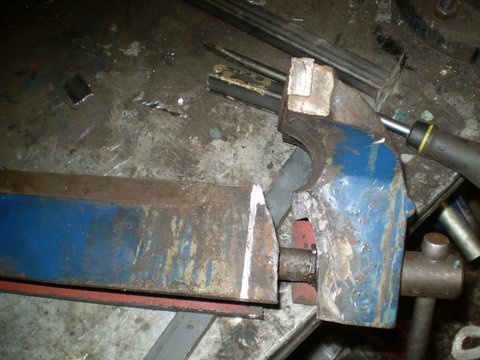

I'd give welding it a go - after all, it won't be any more useless to you than it is at the moment.
Probably will need arc though, rather than mig. Maybe even just bevel the edges and go at it with E6013 rods and see what happens...
I was just thinking it'd be worth a shot with whatever's to hand rather than it sitting broken. I know 6013s are a terrible choice for cast, but it might show that a repair is feasible. Then get the correct rods and do it properly later.
