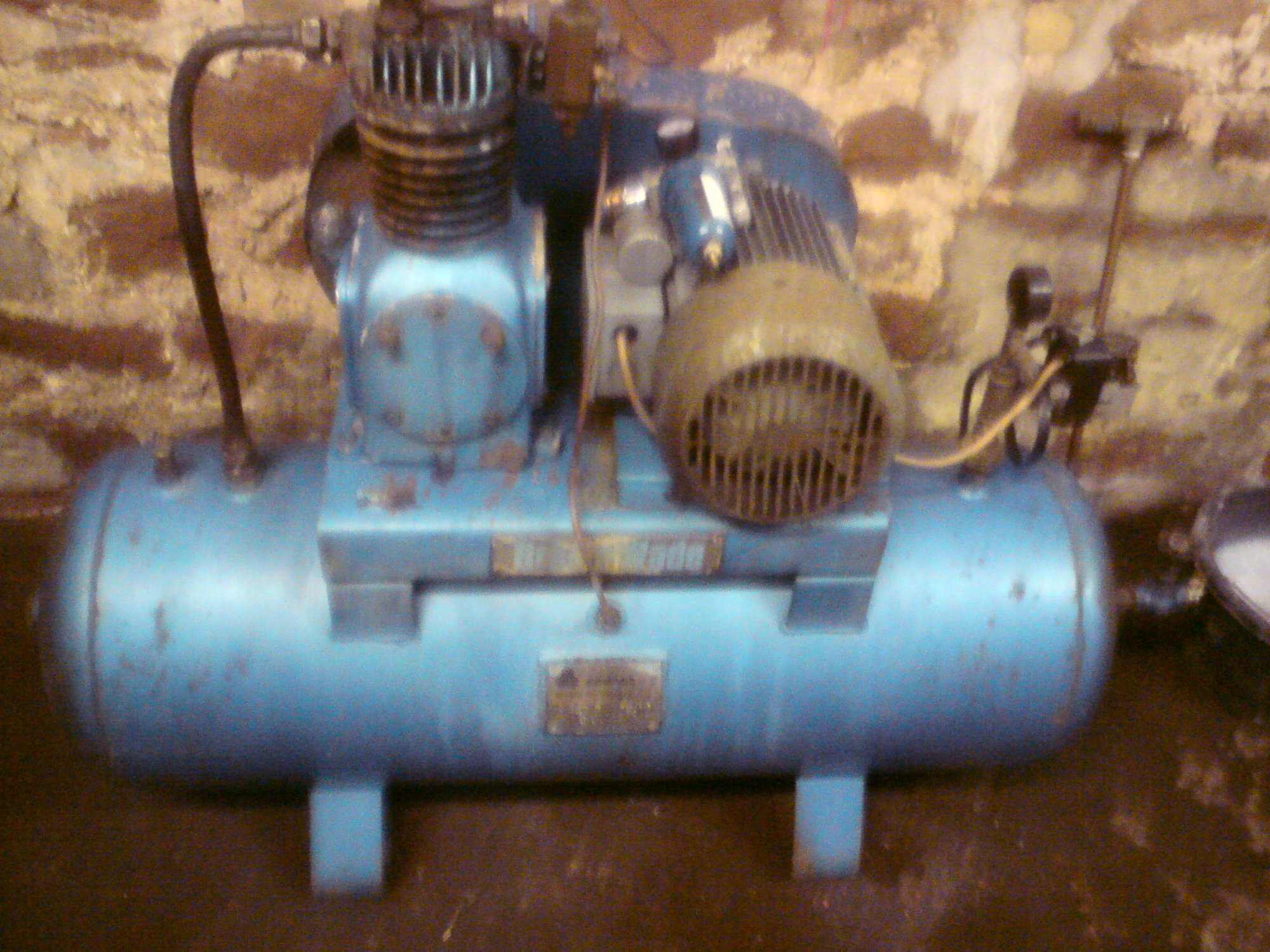

Hi, new to the forum, dont have a welding problem as i just do basic stuff like fixing exhausts of motorbike etc, however as this is the place to ask about air compressors and as i have a problem with one, possibly of my own lack of understanding this is the place to be.

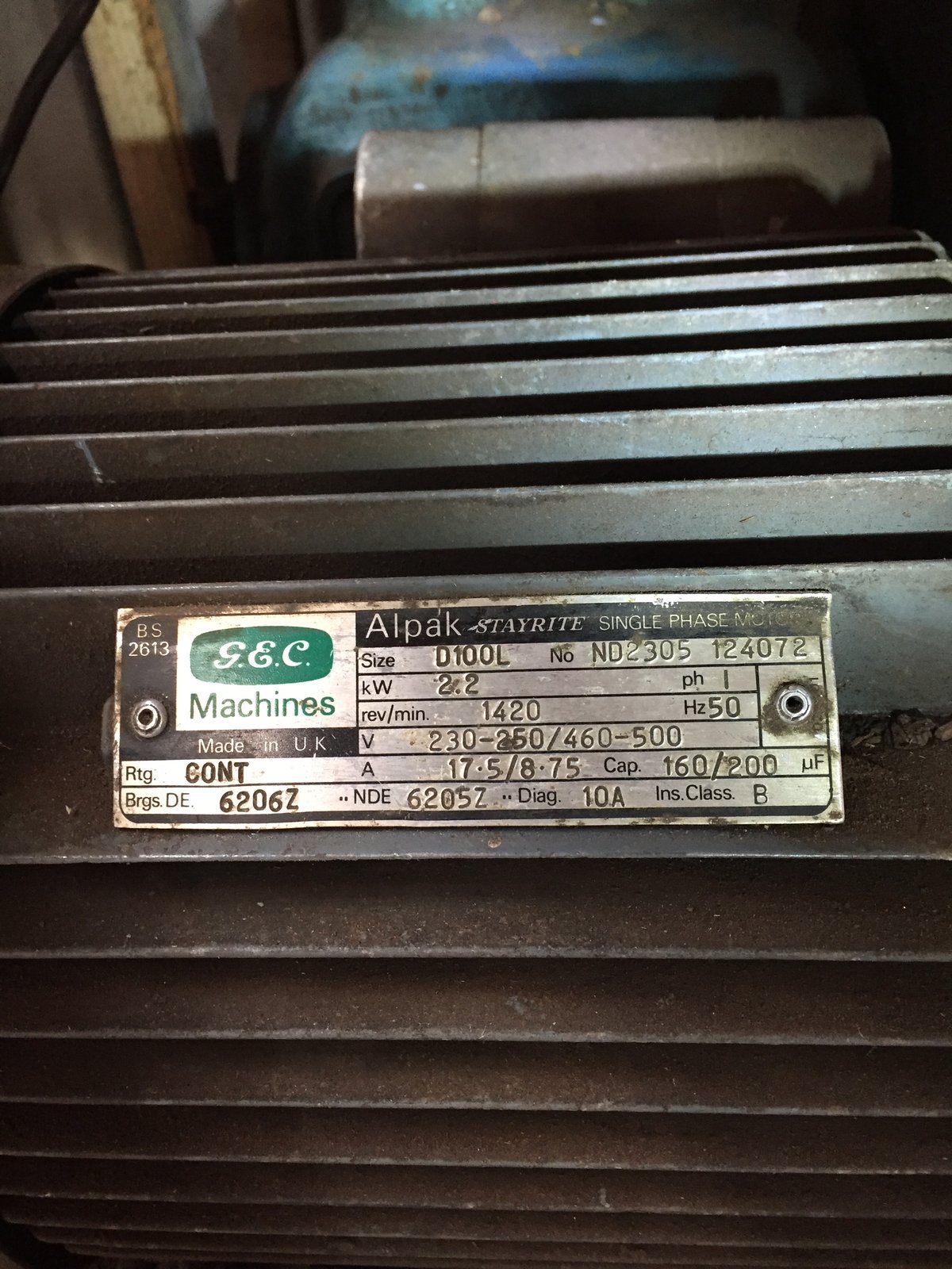

i recently bought a broomwade/compair 120l ac10 with a gec 2.2kw motor, it wasent a lot of money and as with the case it does have one or two problems, i must stress it does work just not correctly.

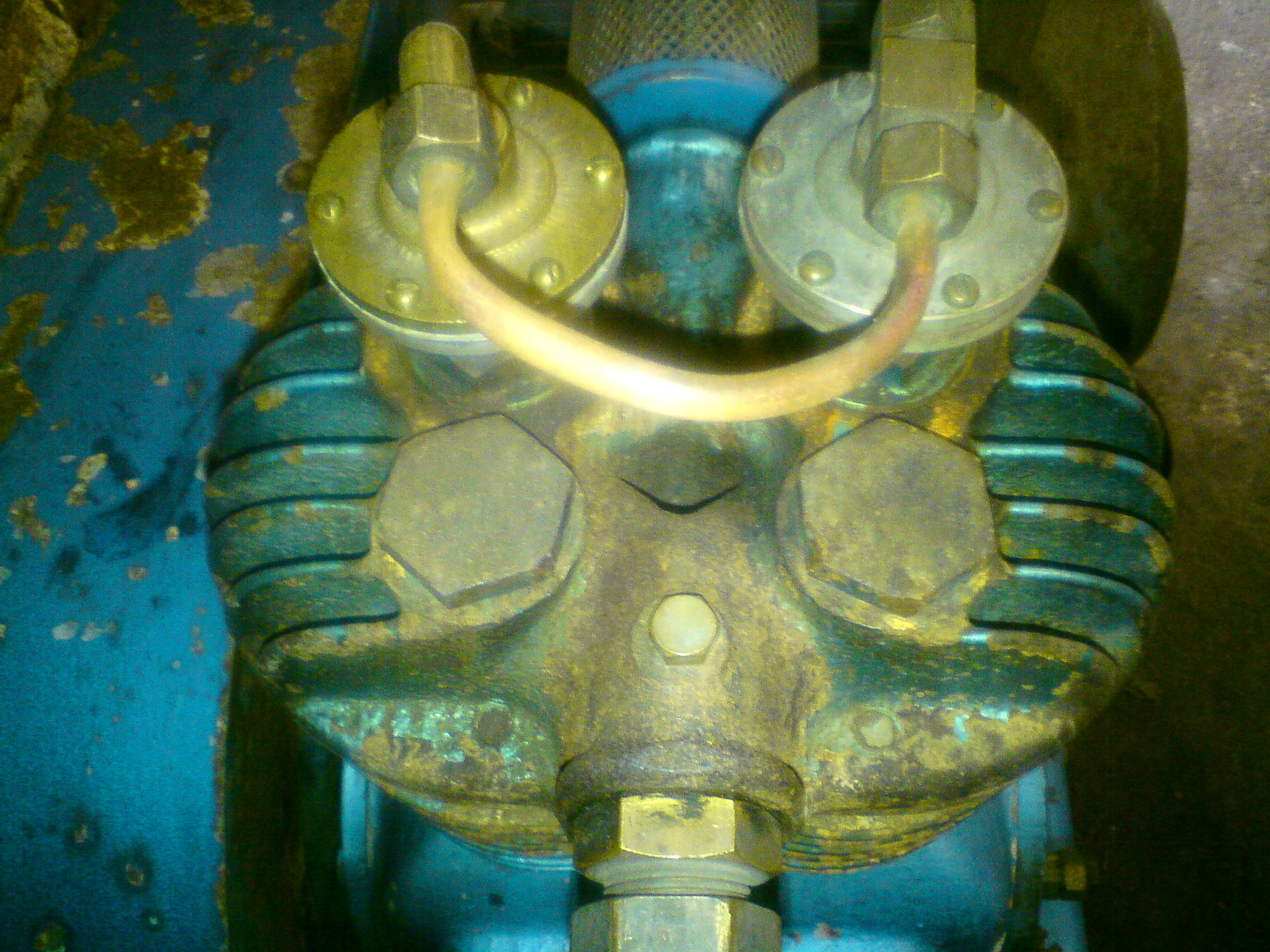

as i bought it, one of the head unloader valves was broken and i have sourced another and fitted it,

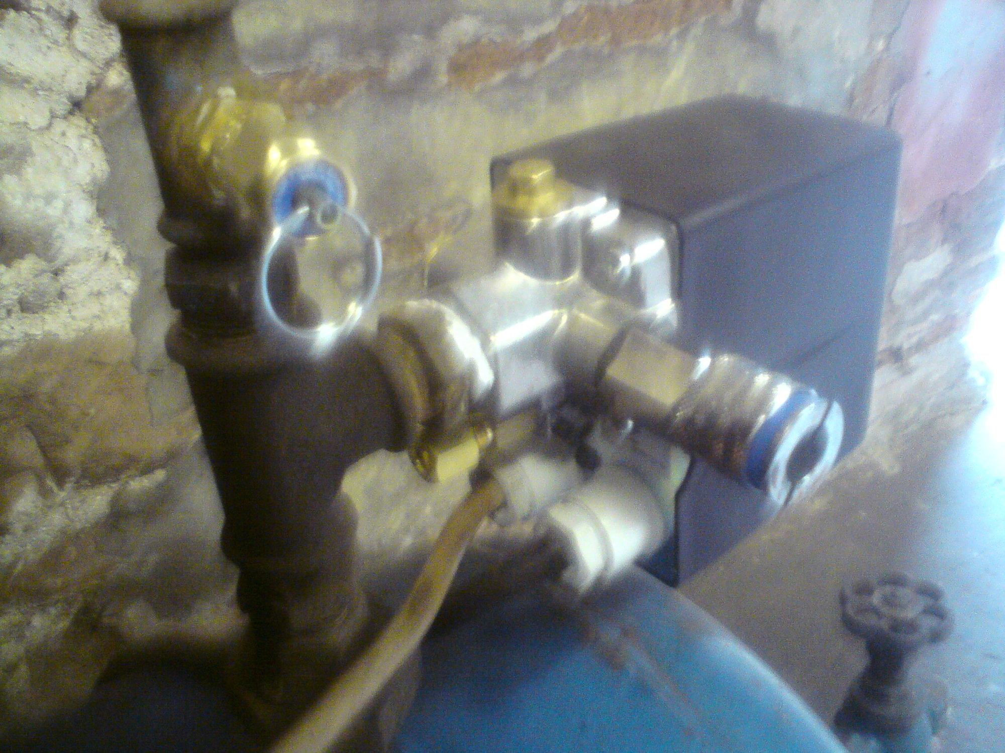

the comp also needed a new pressure switch as the old one was broken, the only one that would fit the outlet pipe was a condor mdr3/11 which is the correct spec as the old switch was 9 amp.
now down to what i am either a lack of knowlege/ confused with.

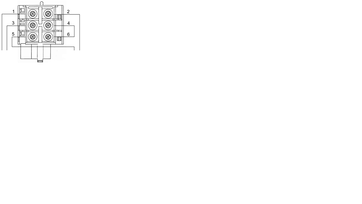

The wiring connections on mdr 3 is not good and i had help from a sparky friend, the instructions tell you where wires go not which ones,(single phase) so as we understand the live direct to motor live, and neutral goes from 3 to 4 looped to 6 and then to 5 and then to motor, earths are self explanatory, though with live and neutral i have never been 100% percent shure of this.
there is an unloader valve on rear of switch which is not connected as the old one wasent and i have no idea where to connect it to anyway.
you can turn on comp at switch and it will run and build up air fairly slowly until it gets to about 4 bar and the switch will cut out, the comp takes about 3 minutes to do this, if you wait a minute or so you can turn it on again it wont let you if you do it too soon and it will run about 3 minutes and repeat only done this 3 times in total, at that time it will read about 110psi, i have adjusted the pressure switch a little and that made no difference, also the switch does not cut in.
the compressor is connected to a 30 amp fuse on the fuse board with 32 amp connectors and an isolator switch inbetween.

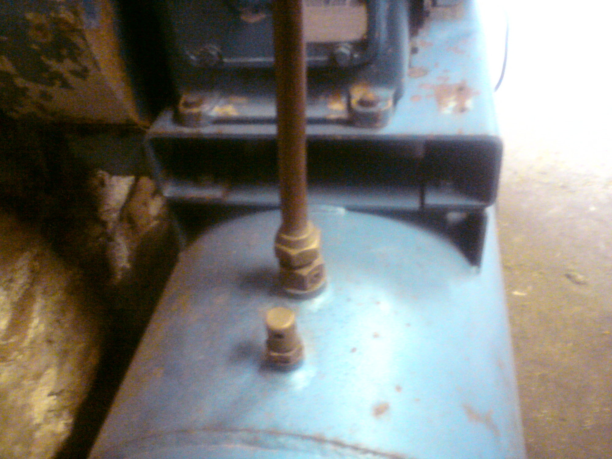

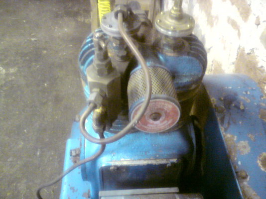

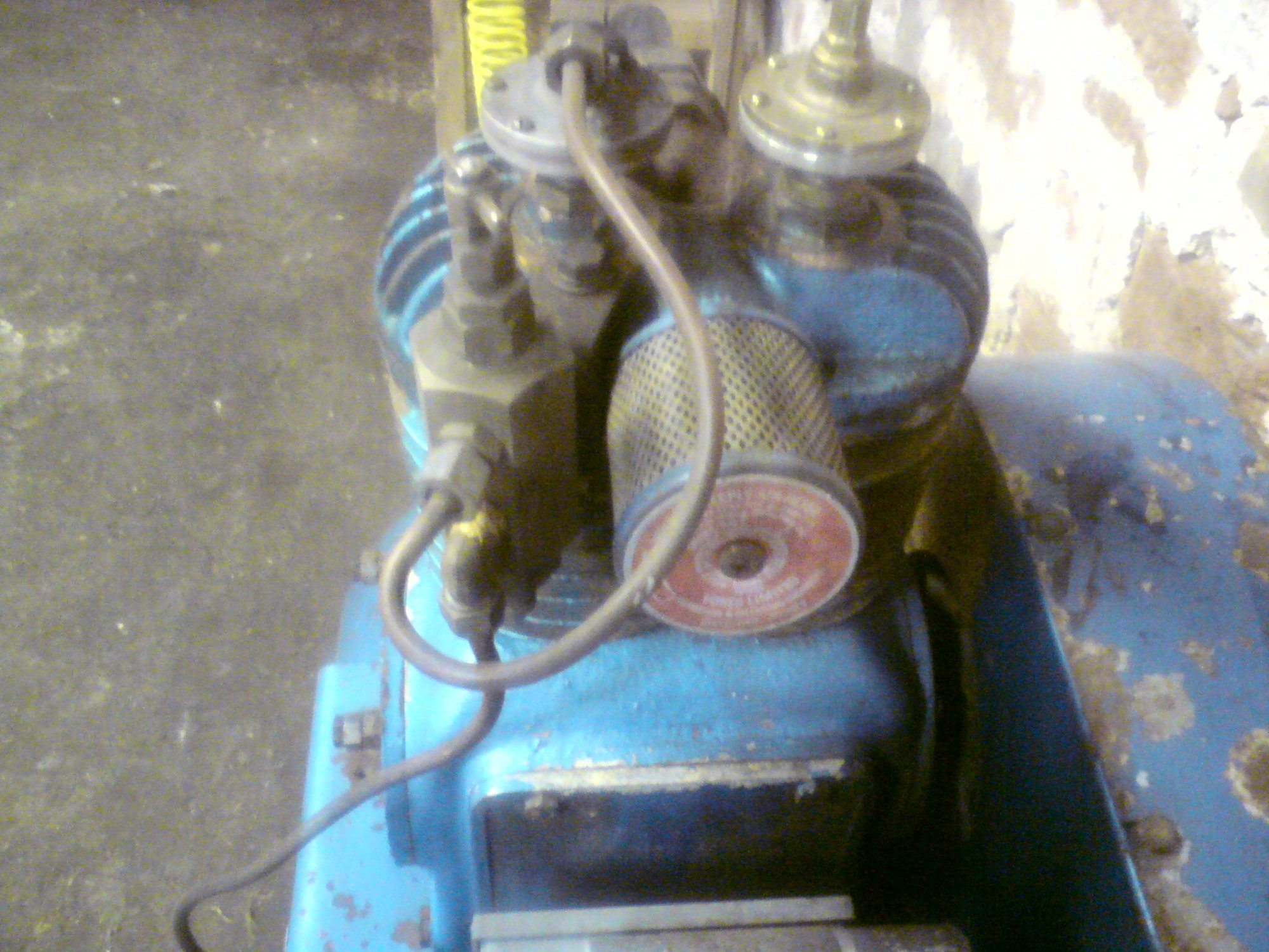

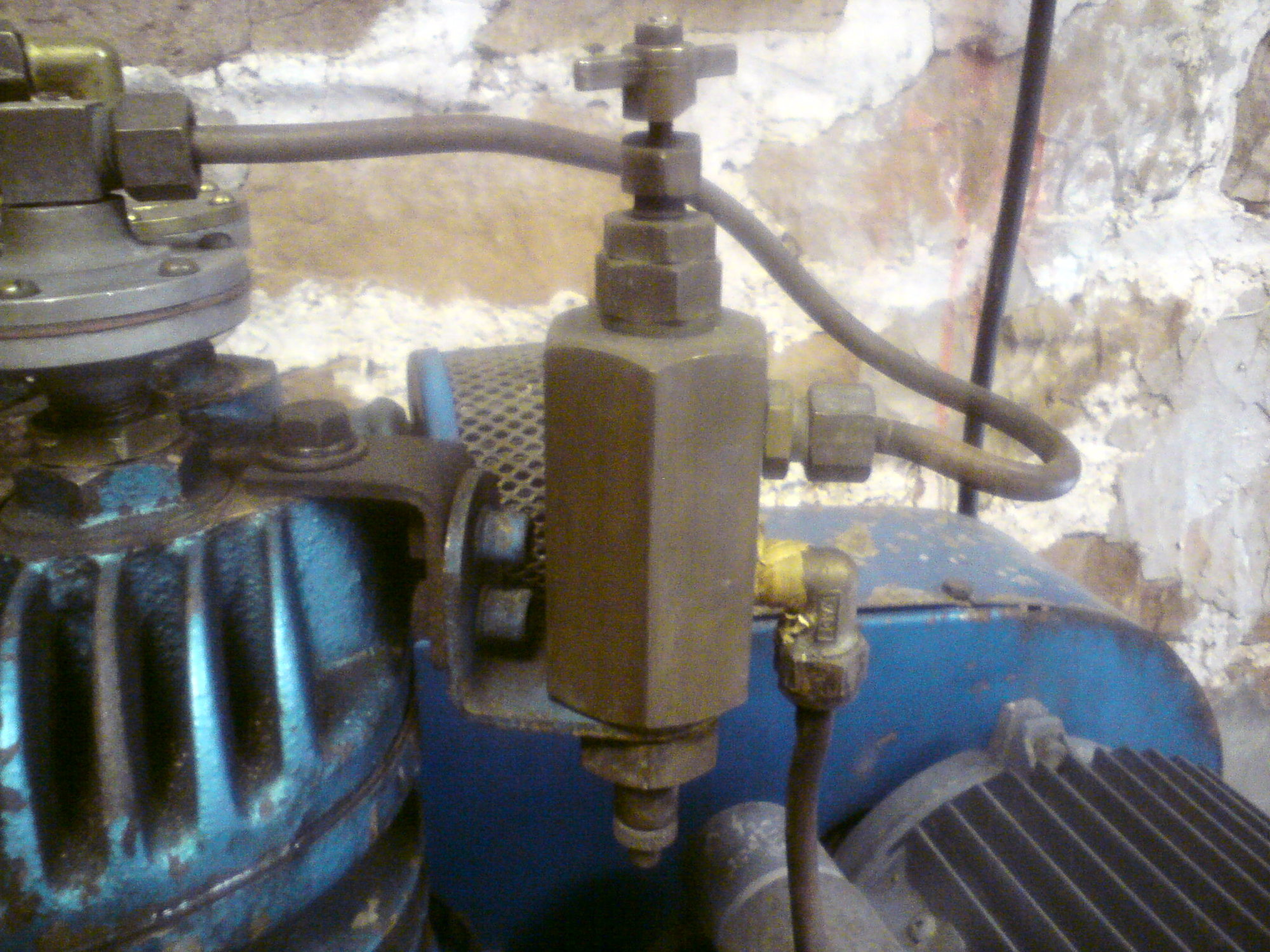

the compressor also has what looks like a govenor which is connected between the tank and then to one of the head unloader valves, i have not touched this,any ideas appreciated i only want it to work correctly,many thanks, can do pics if needed
