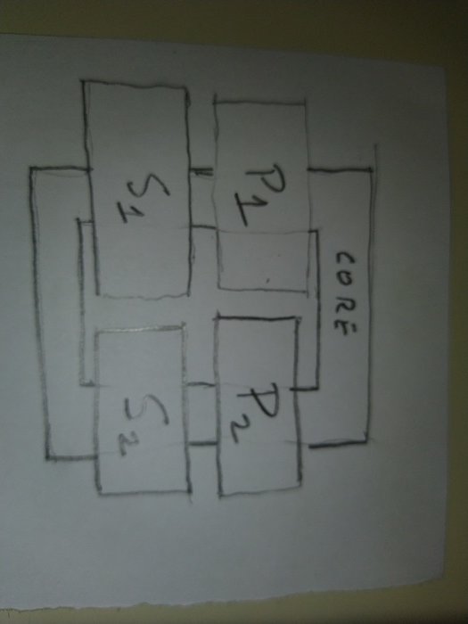

The box has different taps on the primary, and is a core type, primaries on top of secondaries.

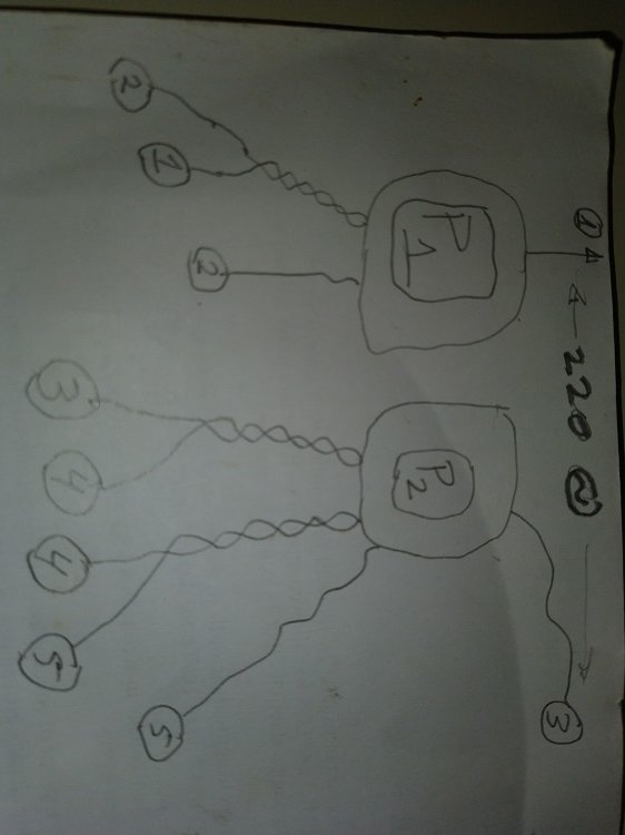

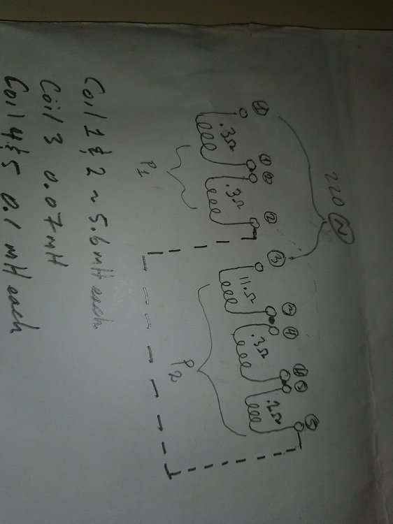

I'am guessing that the "pairs", 1&2, 3&4, 4&5 of coils get terminated/bridged on the switch lugs?

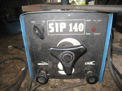

I've attached a pic of the welder and some sketches of tracing the primary coils
I would appreciate it, as this is a bit puzzling...
