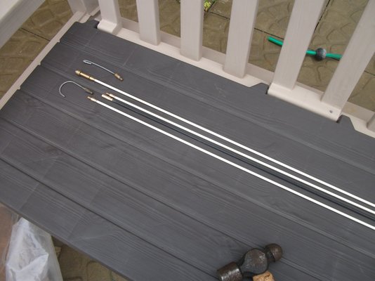

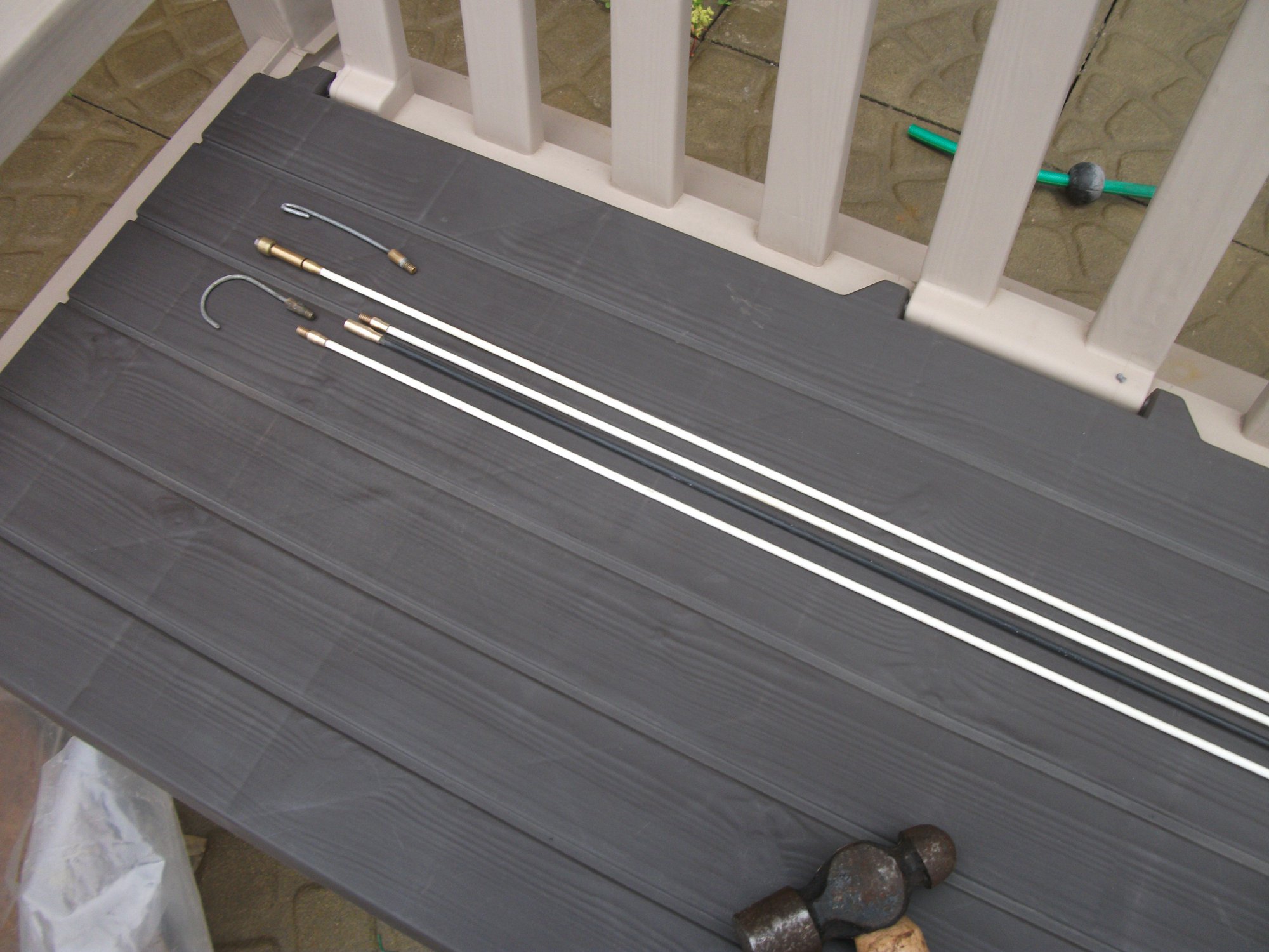

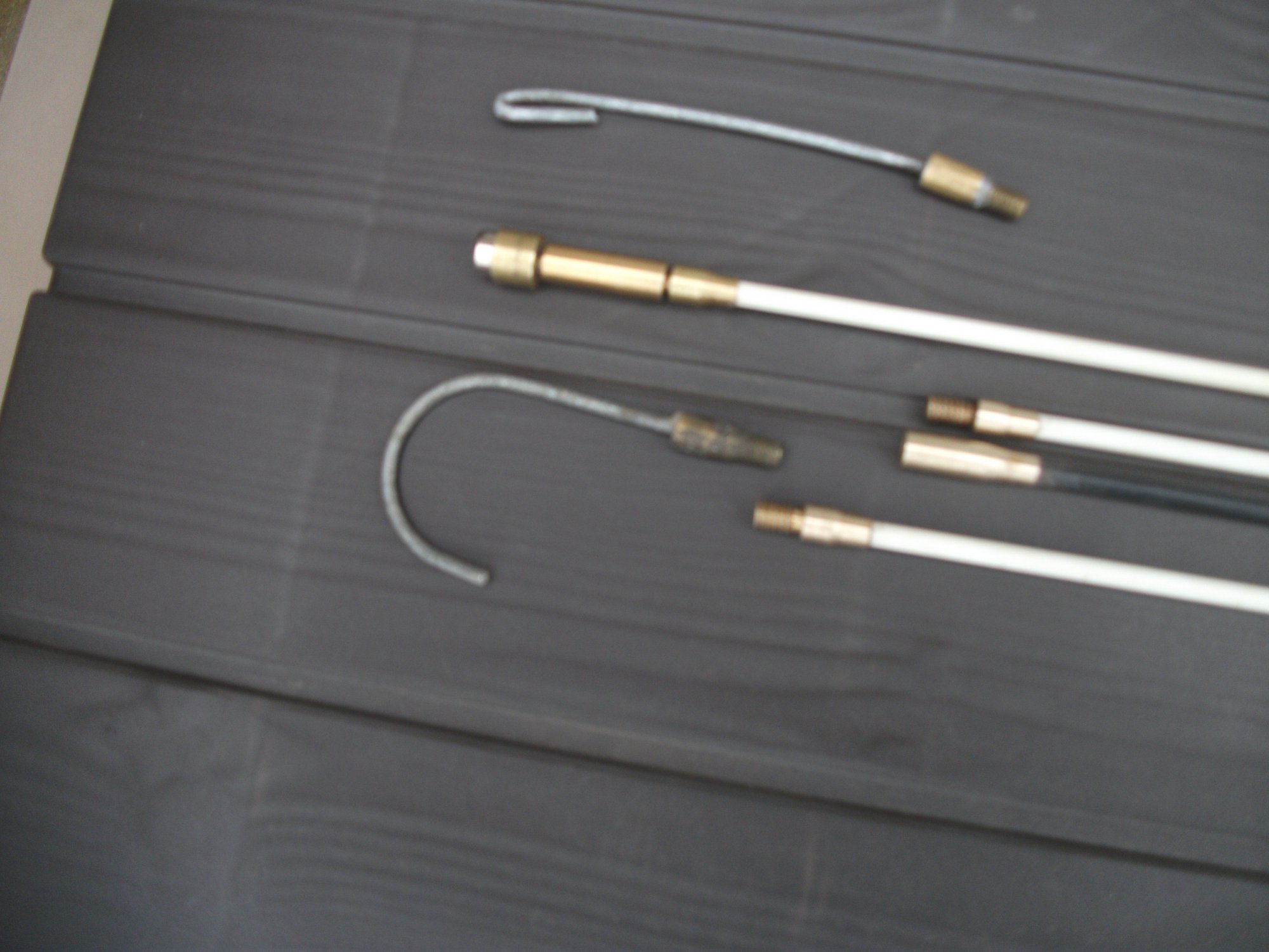

the cheap sets are too thin and not realy up to the job. they flex too much 0ver false ceilings and under floors so I use the thicker ones but I'm not paying over 40 quid a set when u can get the fibreglass rods for 2 quid each .the brass couplings are easy to make and are just glued on to the rods with araldite . the magnetic pickup is handy when u drop tools or fit to end of rods and use a compass to pinpoint where the rod end is in hollow walls
