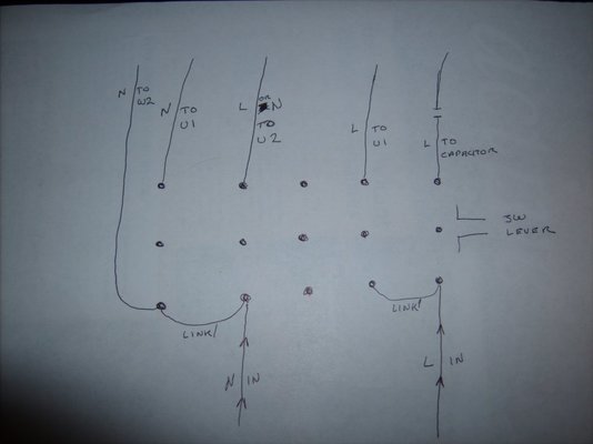

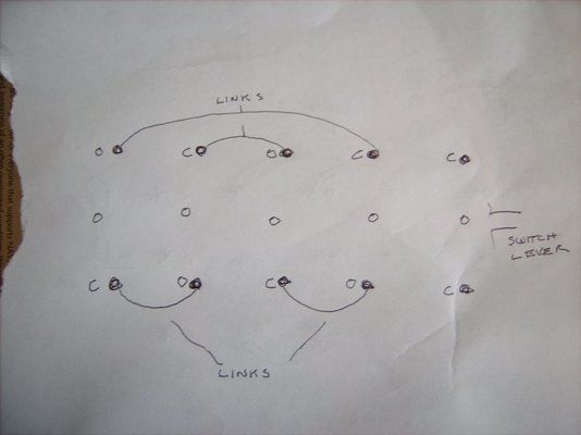

Elect has drawn me up a diagram so I can wire my lathe with a reverse switch, he told me to get a piece of 6 core cable on Monday for between the switch and motor. Can someone tell me what size of cable I would need to ask for please? If I remember right it's sold by 2.5, 3.5 etc.
1,1/2 hp motor 1.1kw 1420rpm.
