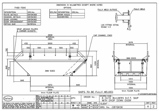

if anybody knows where I can find specs and drawings for an 8 yard skip could you please let me know.

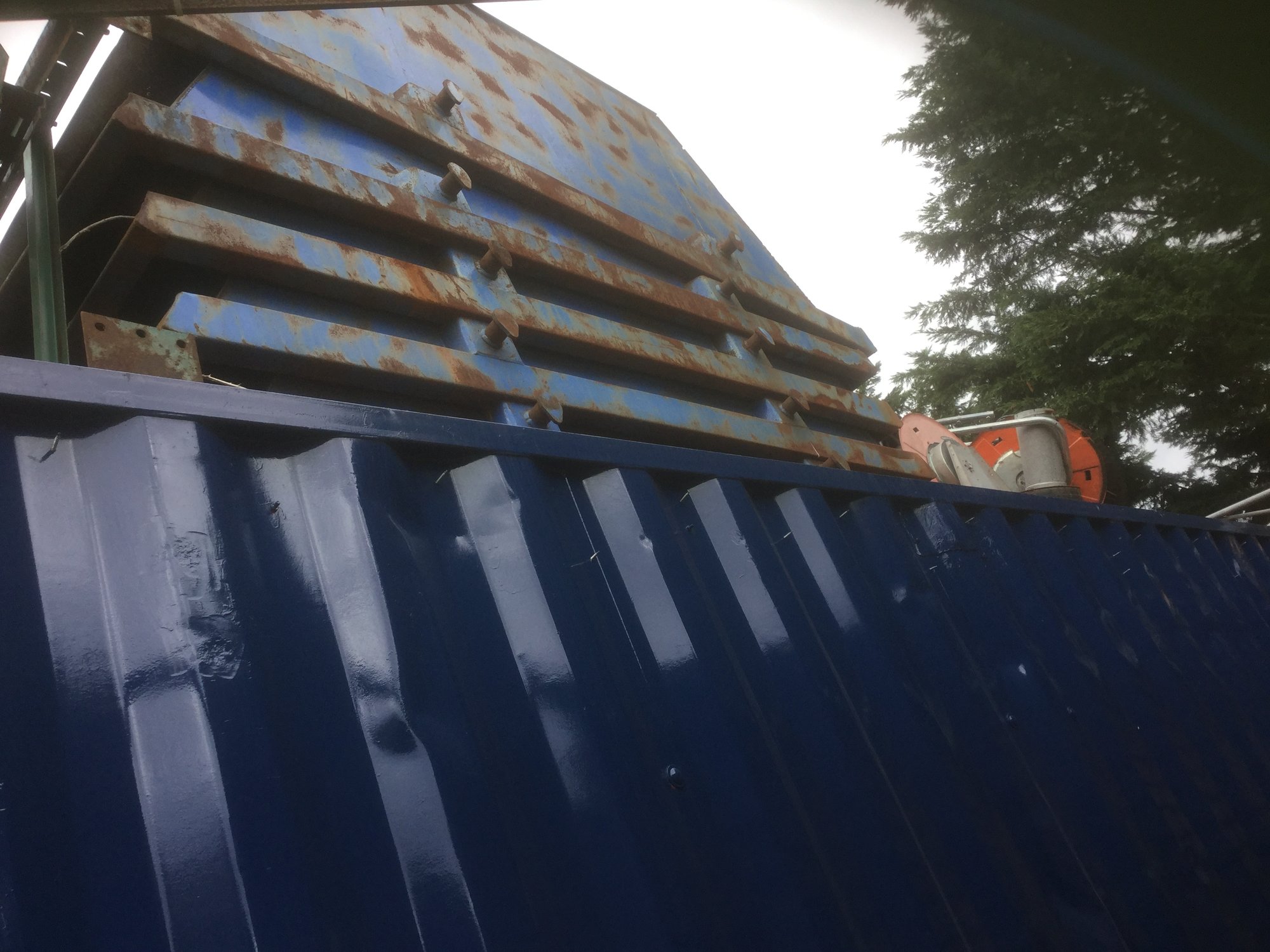

Probably from Poland?, lots of bits coming out of there at the moment.Can we still make things like skips in this country? The last lot I had made were delivered in for less than the price of the steel/folding.
Where is this drawing from please?

...they turned up a week later painted in our colours for £180 each, that is a lot of steel, folding,welding , painting and transport for £180 all in. He also pointed out they were made in a high grade steel

Spot on Chris, never knew that at the time. It was an ebay purchase and I needed six four yard skips fully welded so I could float them in the river, company said no problem and they turned up a week later painted in our colours for £180 each, that is a lot of steel, folding,welding , painting and transport for £180 all in. He also pointed out they were made in a high grade steel
