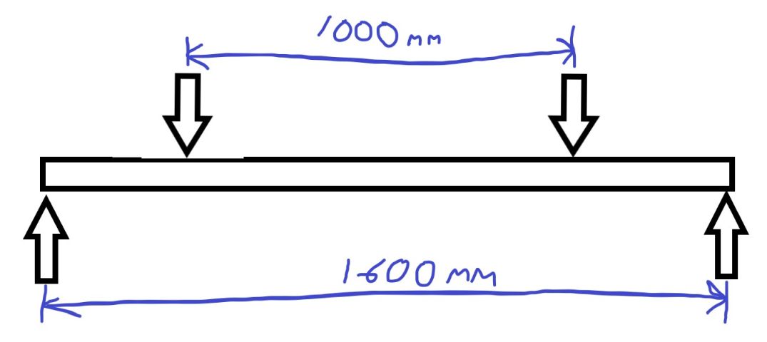

Anybody know what kind of load a single length of 50x50x3 mild steel box section loaded as in the drawing below, no points are fixed.

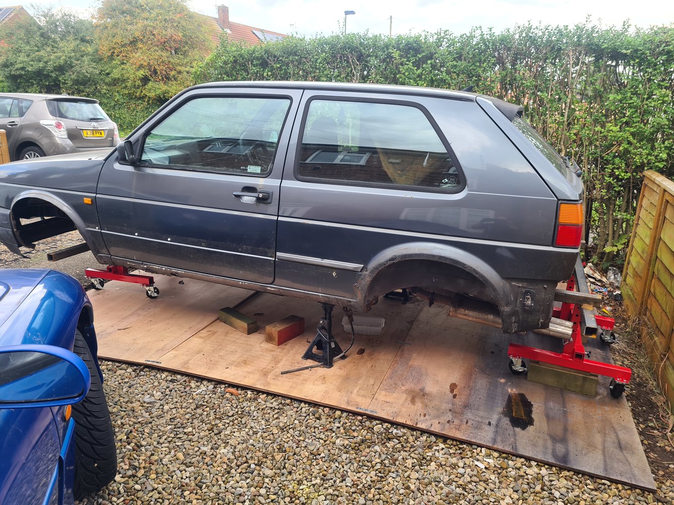

The plan is to support the back of a car with axle stands wide enough to get the front of another car under it as I have no space after losing 2 lock up garages.
