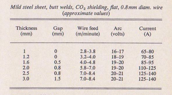

Hi All,
Is there a way of calculating the welding amps, if you know the wire speed and the volts?
I have used in the past 3 phase welders (when I had a proper job) and they had volt and amp gages on them.
I also use on occasion a new Esab 3 ph Mig and that has a digital read out of the amps.
At home though I only have single phase and I have in the workshop a Lincoln 210 Mig, and I often wonder
what amps I am welding on for a given setting.
The label on the machine says:- 35A / 15.5V - 180A / 23V
It has 8 voltage settings and this works out to 1 volt per step. ( maybe ? )
Wire speed control knob is 1 to 10.
A common setting I use is V6 with the wire set to 5.5 ( 4 to 6mm plate, ish )
Measuring the wire this works out at 6.7 meters per minute.
So how many amps is 20.5v and 6.7 mpm ?
Wire is 0.8mm dia and I am using CO2 gas. (Pub supply)
Is there a way to work it out ?
Cheers in anticipation,
Paul G
