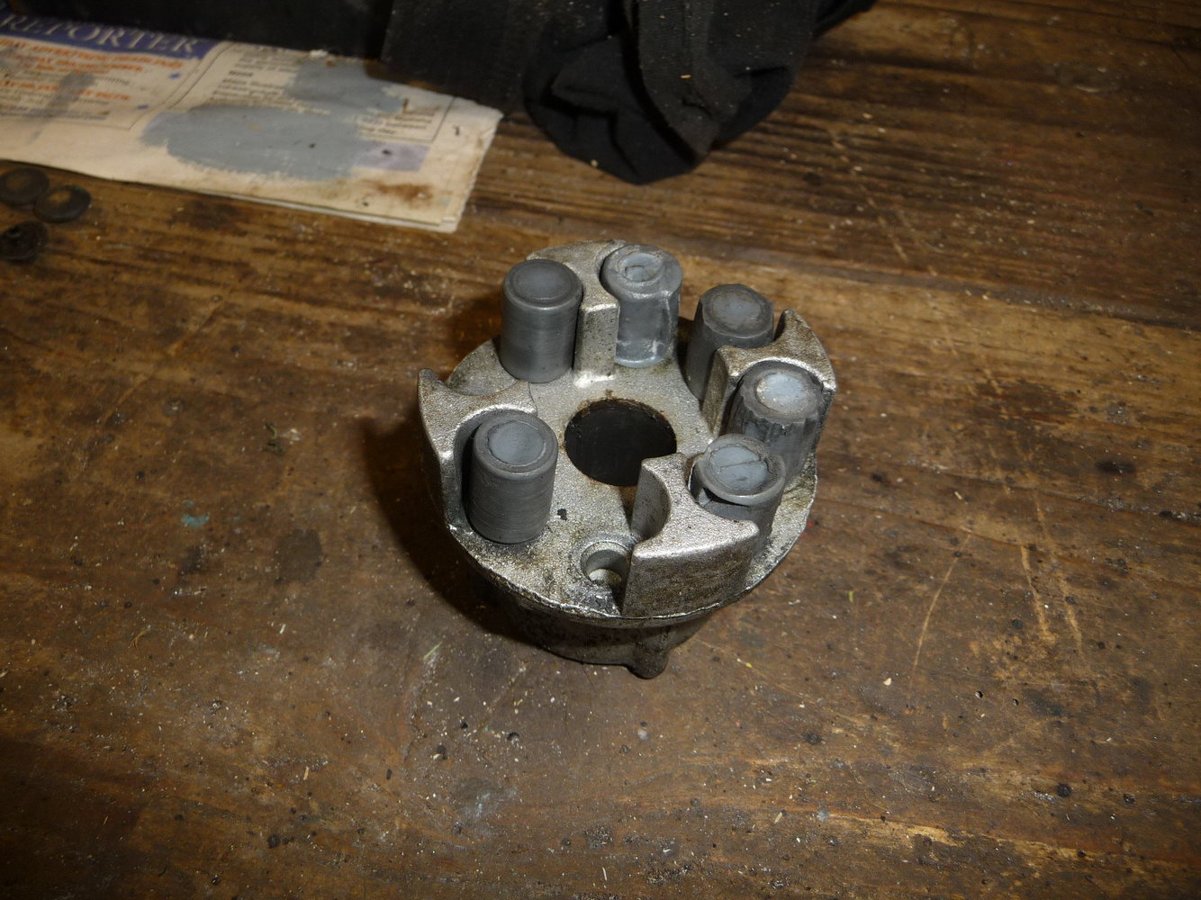

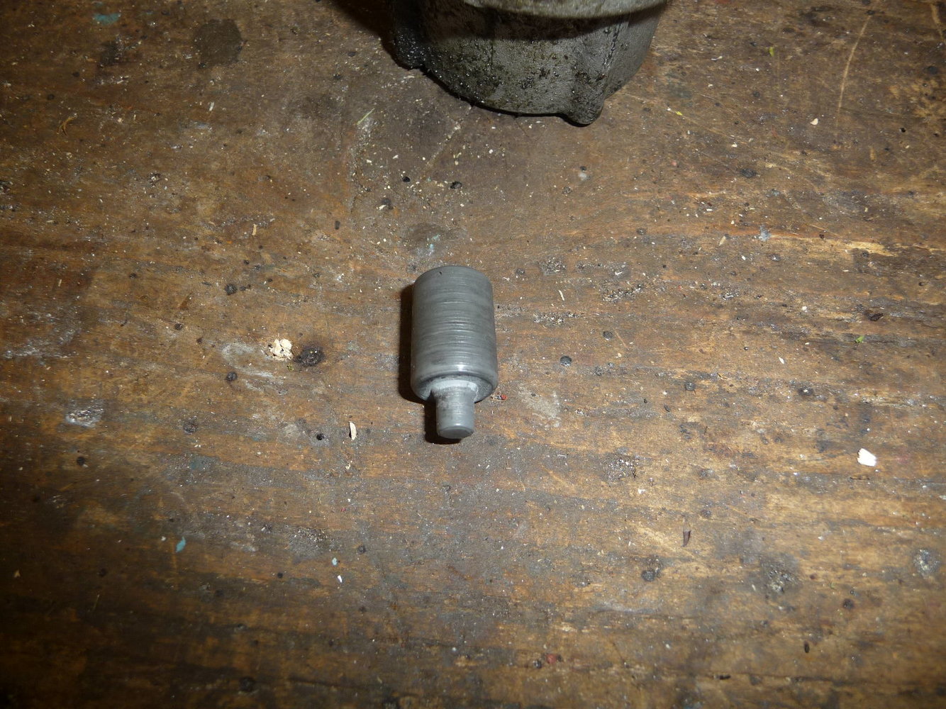

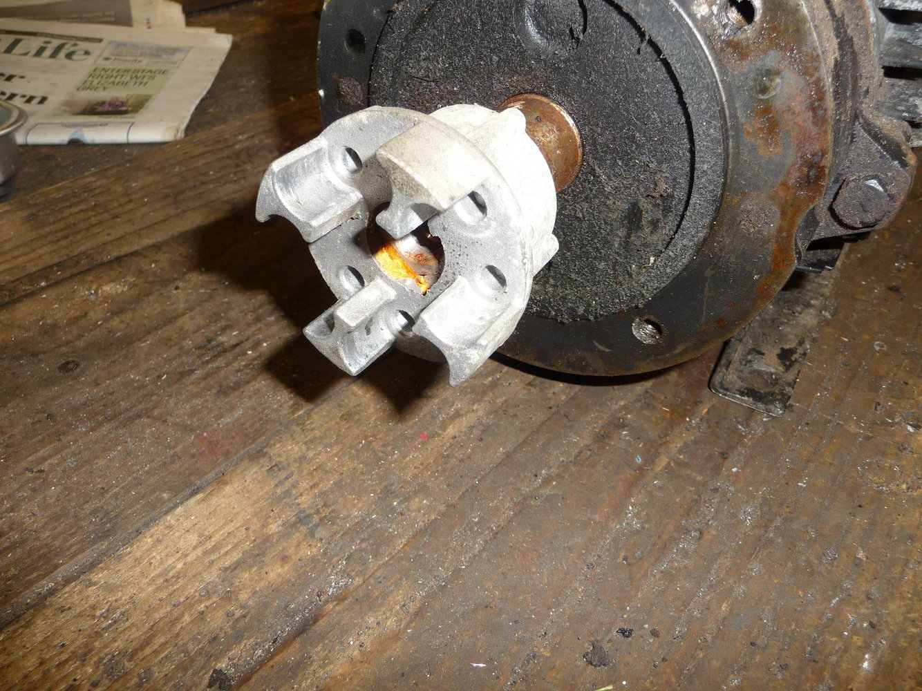

Its a flex coupling between a 3hp motor & a pressure washer pump. Instead of the usual star shaped plastic/rubber thing between the 2 halves this has 8 hard plastic rollers. Out of the 8 there are only 2 I would consider usable, the rest are damaged or completely busted.

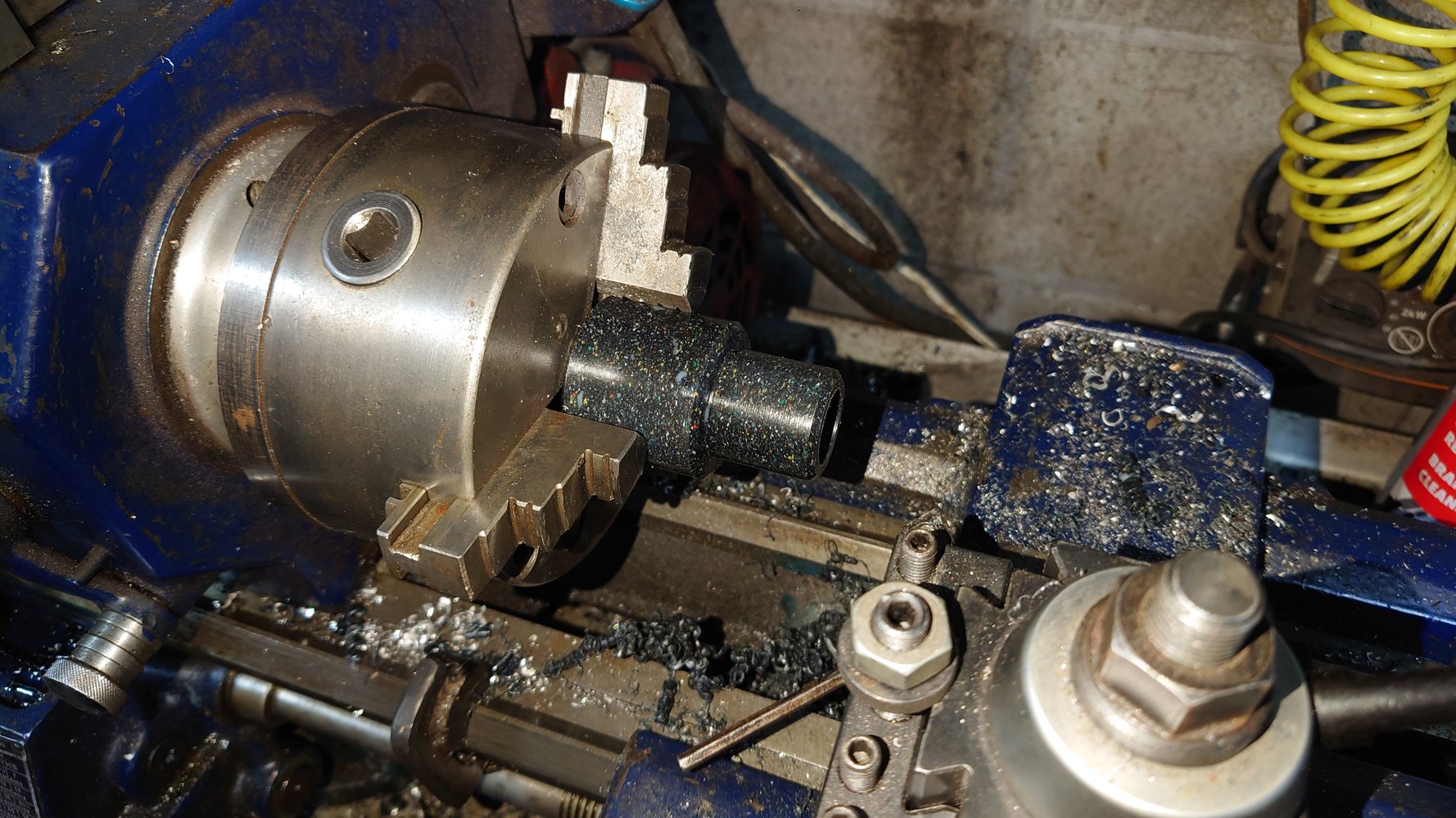

If I can ID the coupling I can see if replacement rollers are available, if not I can make new rollers on the lathe.

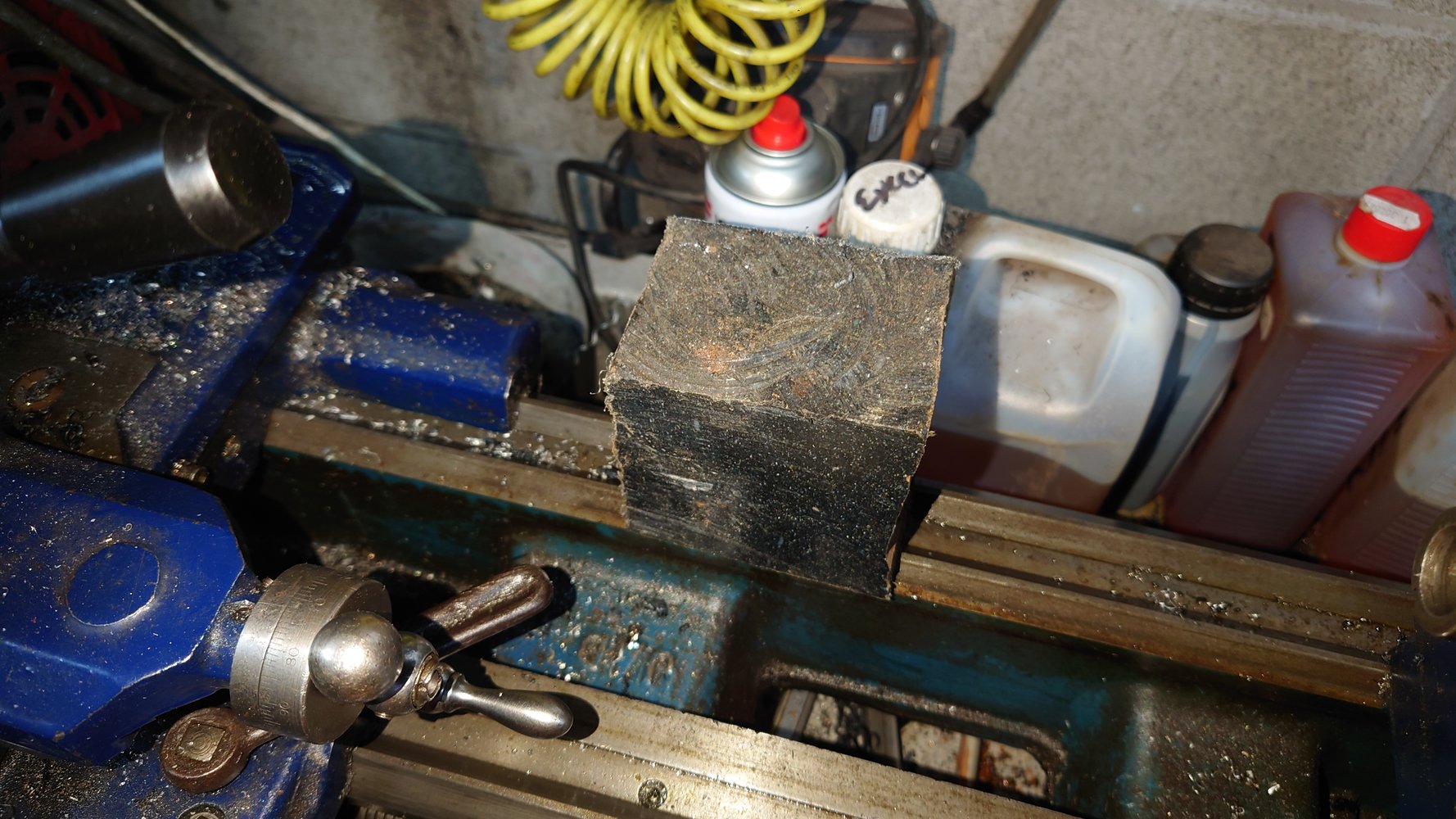

What would be a suitable plastic to make the rollers? Delrin? If anyone has something suitable I might be interested, the rollers are 1/2" od.
