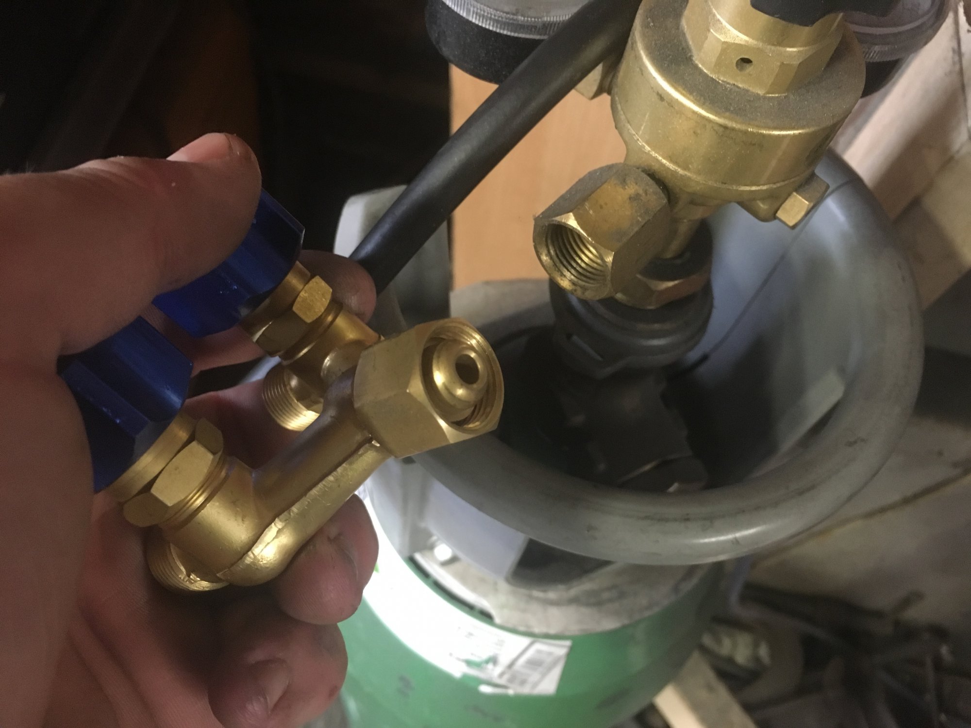

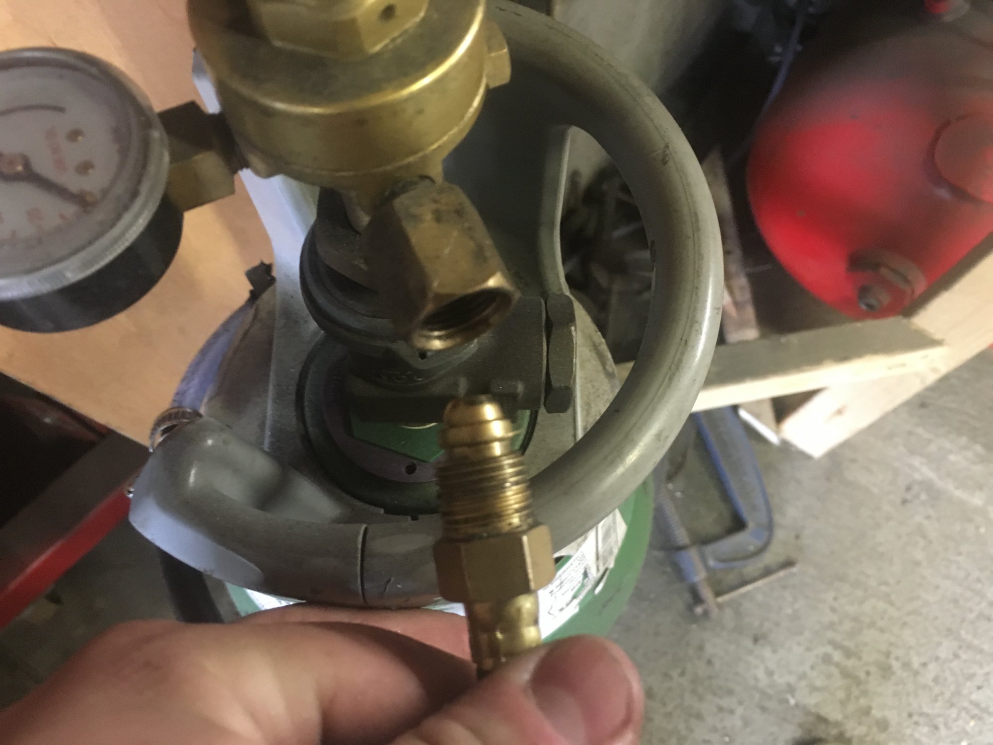

Got a mixture of 3/8" UK spec and 5/8" American style stuff there friend. You need a 608605 Adaptor from Parweld to fit the y-piece to the reg, then cut that 5/8" fitting off the hose and get some 3/8" nuts and 1/4" tails to fit your hoses to the y-piece.
