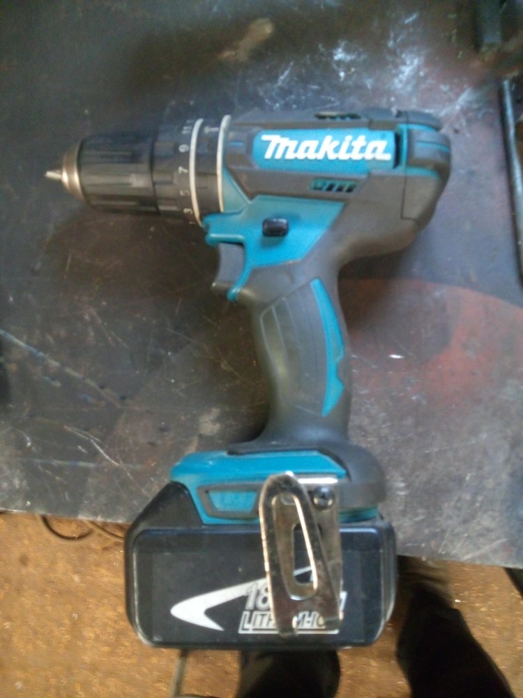

The battery is fine. The motor keeps turning, but the chuck doesn't spin!Could the battery be on it's way out? I could also suggest brushes, but I have no idea if rechargeable items have brushes'?? I can't imagine a powered toothbrush with brushes-how do they work?
Yep, that's what I thought. Or clutch maybe?that sounds like a gearbox issue
It's this one:
Oooh, I forgot about that!If it is two speed, try in both speeds and make sure the gear selector switch is fully home in whichever gear is selected. Work it back and forth a couple of times to make sure.
See if Makita do a standard service repair cost?It's this one:
