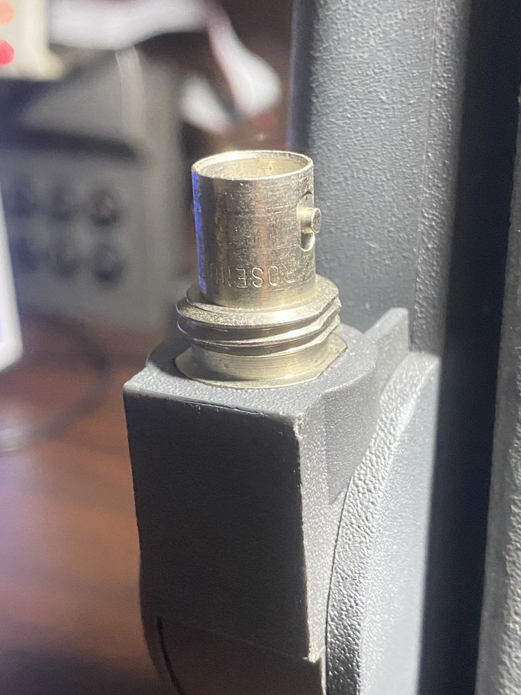

Intention is to print a cone which screws down and supports the whip aerial which is 1m long and about 10mm thick.

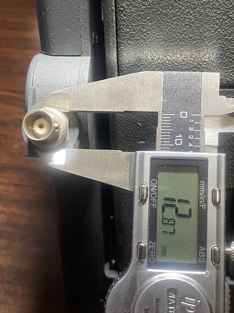

Inner dimension is in the region of 13mm.Need to measure the diameter on the other bit of the jaws
Not many threads so the pitch needn't be spot on

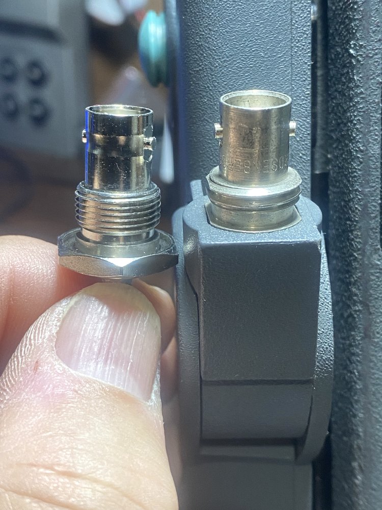

Is it the dame as a BNC bulkhead fitting. 3/8" x 32 tpi ME if it is

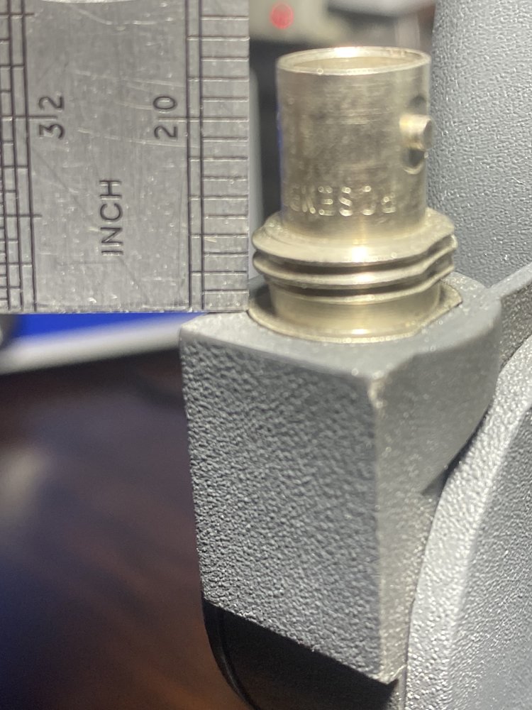

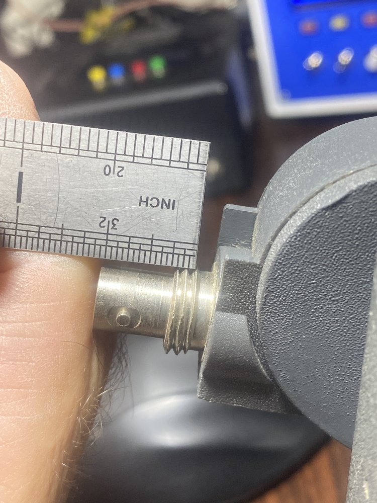

Looks like M14 x 1.25 would be close.
I did a 9/16 x 12 and it starts but jams because the thread on the new part is too coarse. I'm going to try a 16TPI and see how that fits.
This would be my guess, I presume you do not have a thread gauge so get an M8 screw and test the thread with it.Looks like M14 x 1.25 would be close.
