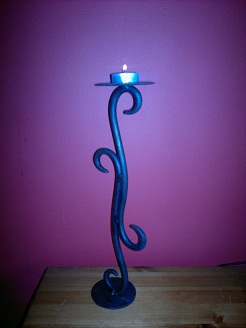

I am going to improve the design slightly, I dont like to see the welds joining the two scrolls, I will either wrap welding wire round or make a small strip of sheet to wrap round, I also though by flattening the top and bottom scroll slightly and then cut a slit in the discs that go at the top and bottom I can then weld through the slits so the welds are invisible, this one is finished with beeswax, I guess I could paint them, then there would be colour options...
I aim to sell them locally, I am going to make a smaller one to make a pair, the larger one I have made is 14-15 inches tall so I thought one 11-12 inches high would go well, I am thinking £18 for the large and £15 for the small and around £26 for the pair, what do you think ?? is that too much ?? I do see a lot of hand forged stuff on sale on the web and it is always a lot higher priced, but I want to be able to sell them. What are your thoughts ??

1. Don't get into painting them, especially at that price bracket.
2. For the joints you could keep the welds (keep them small) and wrap a length of bar round them (to cover the weld) - taper both ends of the bar first.
3. They look a little unstable to me, and slightly out of proportion (stock size vs height etc), do some experimenting...
Other than that, try it and see. The round tapers look nice and clean - seems a good start.
Hi Al, thanks for the input, I used 10mm round bar, each part of the scrolls is about 10 inches, giving the 14 inch height. I didnt want to use any thicker bar as I wanted them to look slender, I wouldnt make them any taller in that size bar, I was thinking a shorter one to go with it. the top plate is about 1.2mm sheet, the base on this one is about 2.5mm but I have some 4mm plate scraps I can use. I was thinking about making some sort of collar to go round and hide the welds, I have some 16x3mm flat, that should do it, maybe make it look prettier some how.
What do you think of the prices, I am a bit slow at the moment being a learner an all, so it probably took me about an hour and a half taking my time etc, do you think I am wanting too much for them ?? I dont want to under value my effort but I do want to sell them reasonably easy, what would you charge for them ??

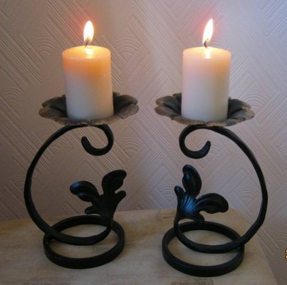

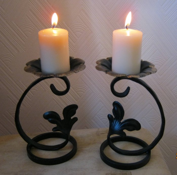

I have attached a photo of the ones I used to make and sell and I sold a lot through a couple of local art and craft and flower shops.
There is no skill involved, a few tacks, a spray can of matt black, touch of gold and a candle, £20 a pair they sold for, cost about £5 a pair and ten sets an hour was very easily achieved with another half hour to paint....it gets boring though and there is no self satisfaction or feeling of pride...it's just an earner.

Hi Steve, I didn't see this until now! Nice candlestick, the design flows nicely, I'm not sure about the flat candlecup though, and it does look a little crooked, whether that is the angle of the camera or not, I don't know but if you're going to try to sell these people will notice things like that.

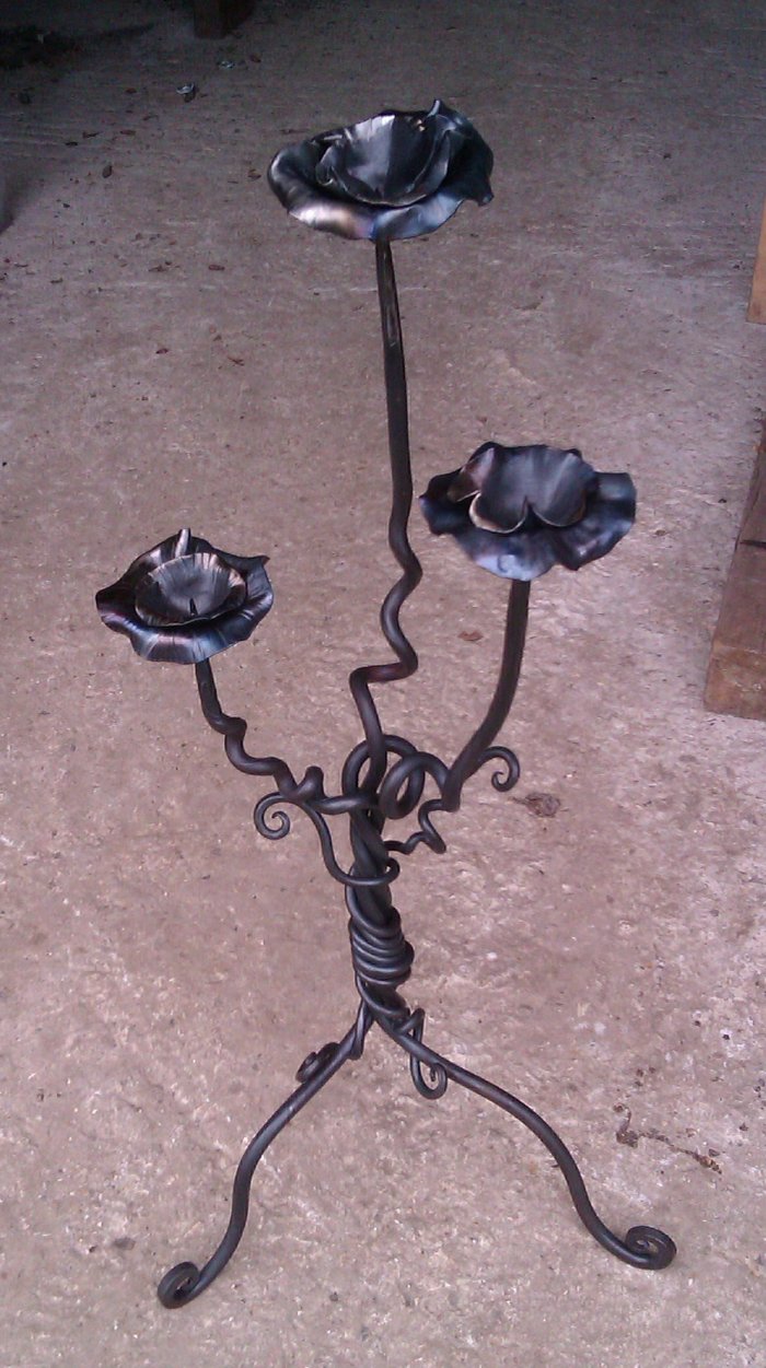

I buy in discs for candles cups, and flowers etc, I don't tend to use bought in components like scrolls etc, though, and if you're into forge work than buying in components and welding them together is not very satisfying, but it all depends on what you want to do. I've attached a pic of a candlestand I've made using the discs - like what astro al was describing, really- using the bought in component and modifying it.
You will get quicker at making, things like the heart hooks and simple flowers that I make and sell rather inexpensively will take me about 15-20 mins to make. I have to say I am getting rather bored of doing them now, but they have been a good earner while I am getting known in the area, and now I am doing less of the smaller work and have more commission work on the go.
The candlestand in the pic took me just under two hours- finished with wax, will take taper candles. These sell for £125 to £225 depending on size and where they are sold. This one is one of the smaller ones is about 50cm tall.
