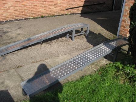

I made some virtually identical to Davenports... not tall enough for working under the car, just to raise it 6" or so for jacking (even the dailydriver is too low to get a jack underneath)
hotrodder- exactly the reason i made these... the 2 post lift in my dads workshop wouldnt go low enough to get under a few customers cars and yanking up on the wheelarches is a bit risky!!!

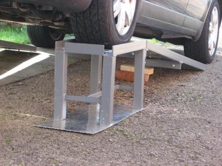

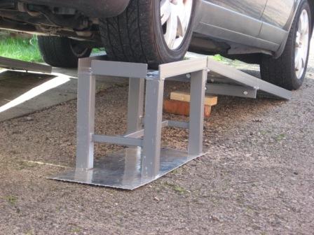

They are in 3 sections and when you have drove up them the 2 ramp sections remove leaving better access. you can see this better on this photo. I need to weld on some load spreading pads on the feet and make a support bracket that bolts between the 2 ramp sections instead of the brick and wood lol
Looks good. I think i would probably want the angle to meet up in the corners and be fully welded to increase the stability, and as you say, some feet are required - i would be tempted to use one piece of plate underneath, again for stability and to prevent one of the legs going wayward and toppling if it was over a soft spot.
l've started to make as set the same as the, restorationramps,l have one completed just the other to weld up.Its the big ones you drive onto and use a jack to bring level,only thing is l think there will be a bit of grunting moving them about.
