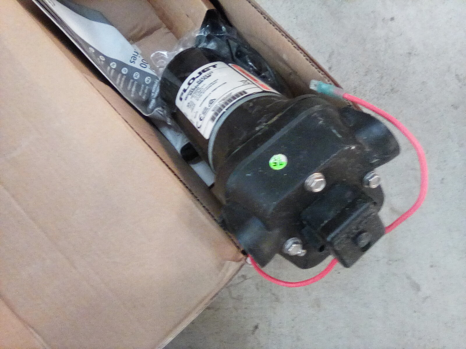

Hi All,

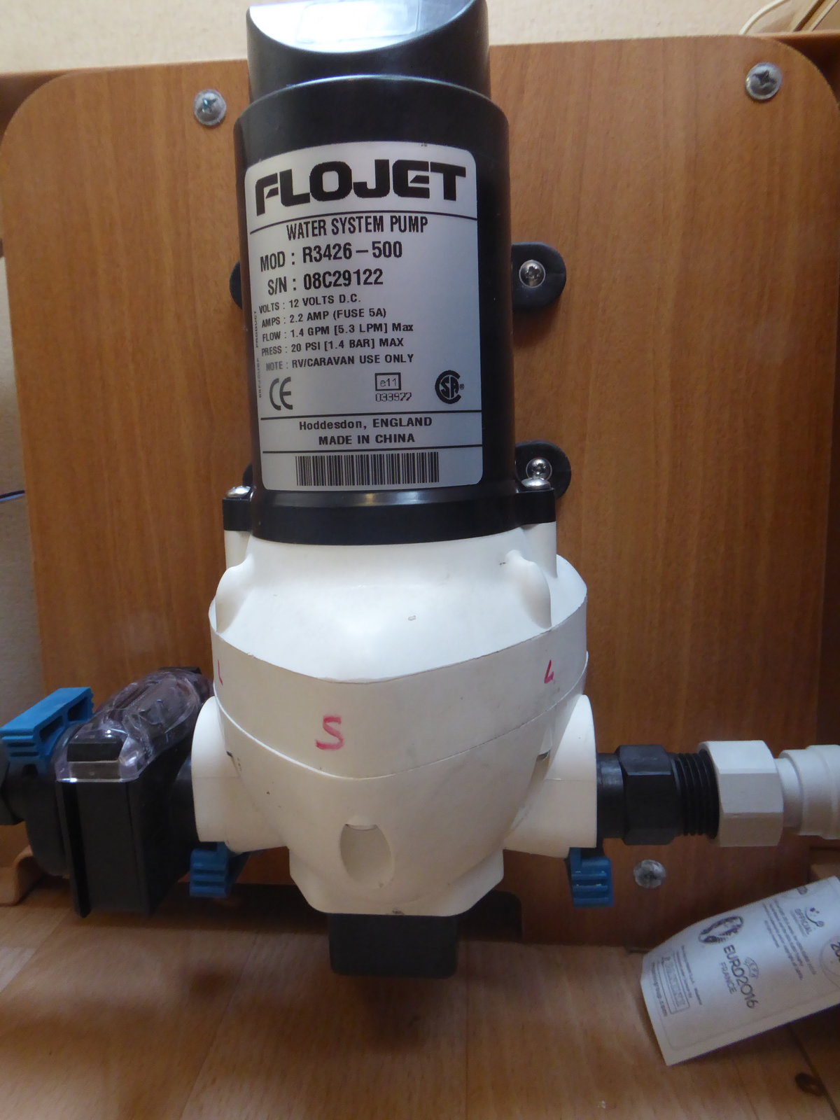

Just had a trip away at the weekend in my van.

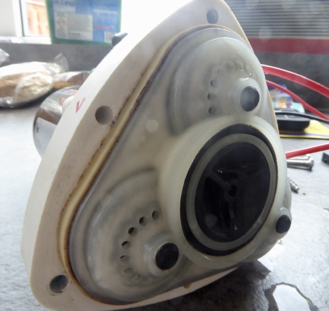

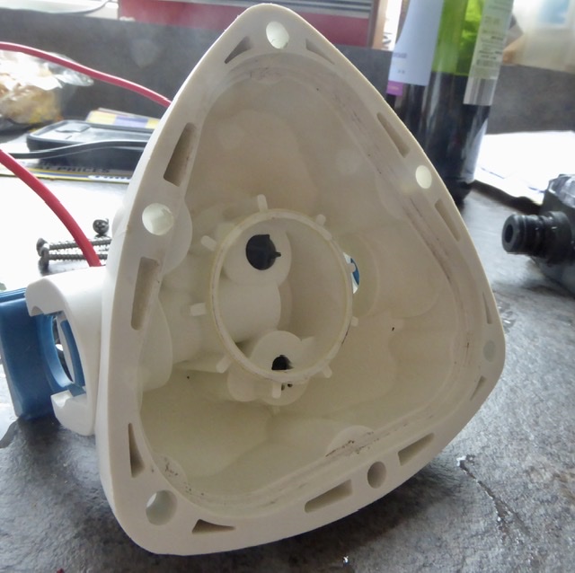

The Flojet R3426-500 water pump fitted to it has started to click very fast & decided to take it apart to find out why. Think I’ve found the problem as the pressure switch fitted on the bottom has water in it. A replacement switch is available & I will order a new one.
However while inspecting the pump I noticed the split body of the pump (see pics) has a small leak (possibly the reason the switch has water in it). Tried a few flow jet spares companies but don’t seem to do the seal (off white in pic)
between the two halves of the pump body.

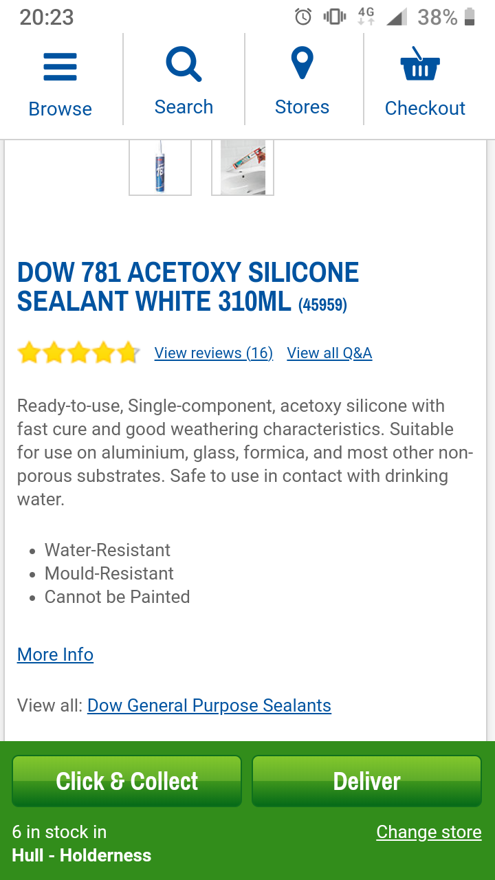

Anybody know where I might get one or failing that a suitable sealant, bearing in mind it’s potable water.
