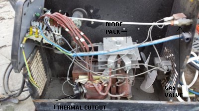

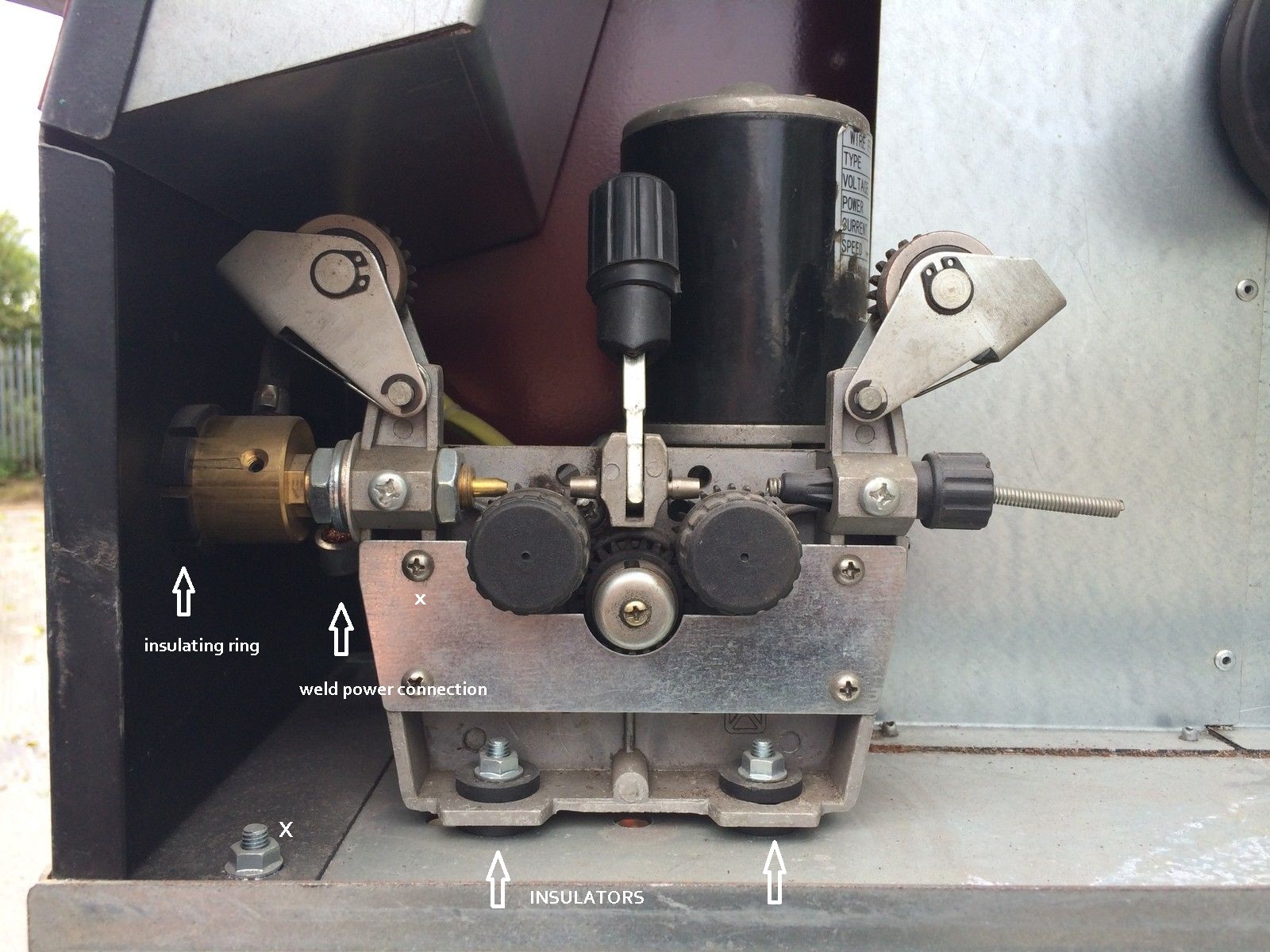

Hi, I have a cebora jaguar 200, the single phase one. I had a problem with it blowing fuses, which seems to be ok now. But now something has broke on it, it will feed wire and puts out gas but it won't arc. The wire comes out, touches the job but doesn't have enough power to melt the wire, the wire just glows and curls up. Also the Euro torch fitting on the front of the welder is getting hot. Can anyone help?
