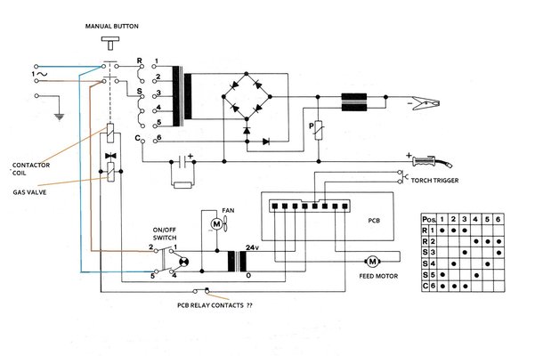

I am fitting a new 6 position rotary voltage switch on my old Cebora machine. I understand wiring mains to transformer except I don't see how the smoothing condenser is wired into the switch - wires C and 6 which are white in the machine and joined with a cable tie.
Has anyone got experience of wiring this switch?
