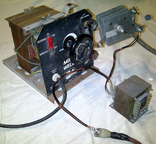

I joined and posted about help on a MIG welder a little while ago. Well that died because it was the main transformer primary was blown. However - there's nothing wrong with the rectifier and choke.
I'd been reading around the forum and DC seemed a good idea.
So I lashed on the rec and choke. First I laid a bead with 1.5 rod on 0.7 sheet without any hassle.
Next I had a small frame of 20mm dia tube to put together. Well impressed, nice and smooth, easy to strike. And then I noticed - no splatter. I ran my hands around all the welds and couldn't find even one spot of splatter, none! Amazing. So I'm going to build a box underneath to hold the extras plus the fan.
The open voltage DC is 67V. I noticed compared to previous, the current needed to be higher about 20%; that could be due to the choke I guessing.
I bought the Cebora Mono Welder mod.1722 when I was 19, and apart from a brief spell with an oil-cooled AC, it's the only welder I’ve used; and it’s worked without problem for 44 years.
