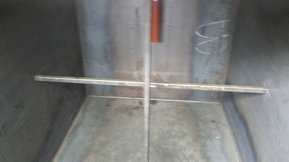

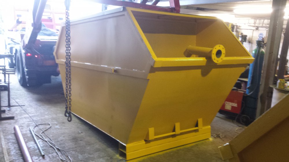

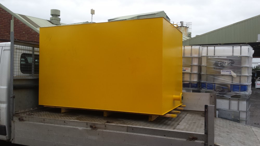

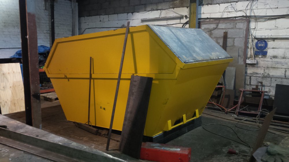

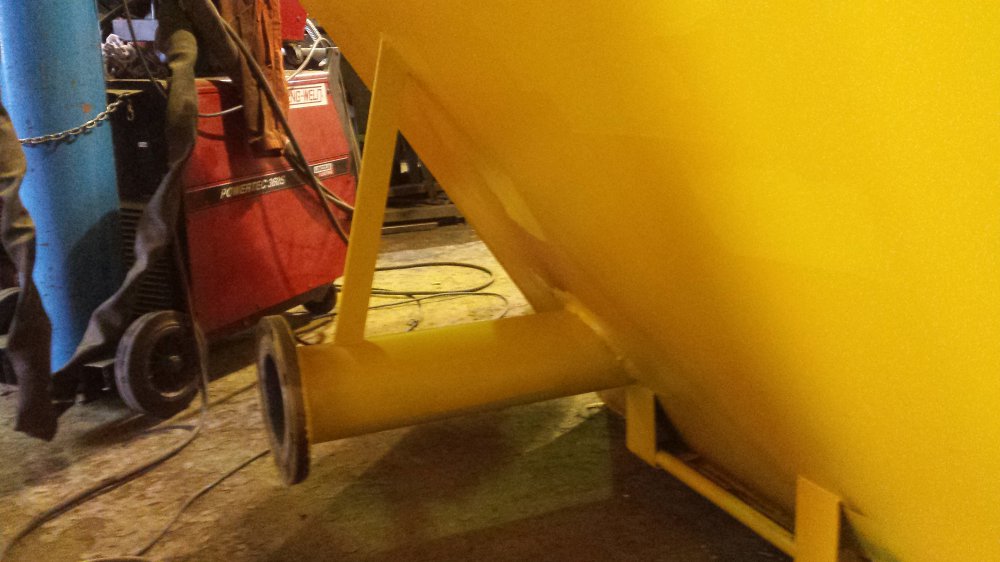

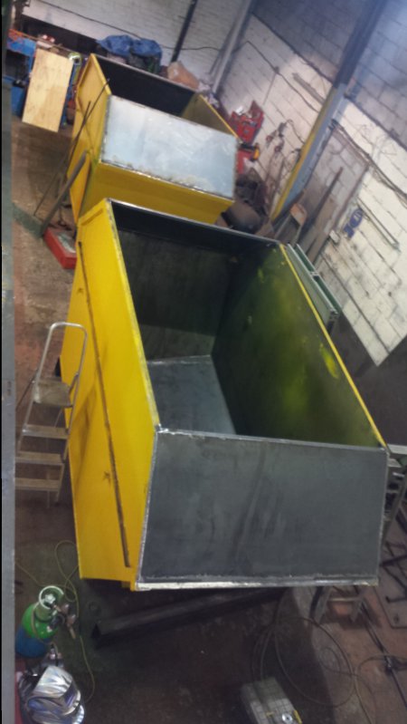

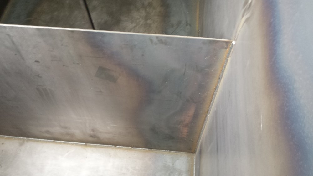

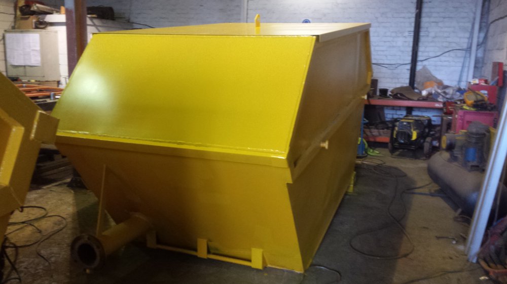

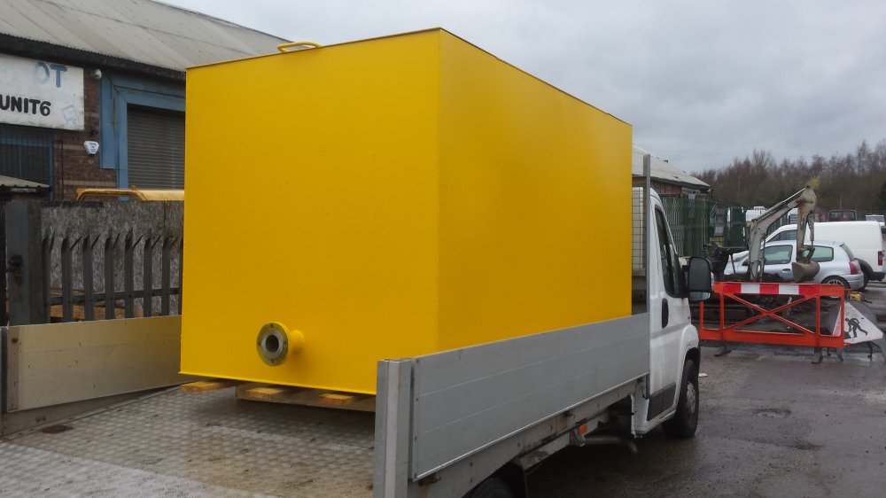

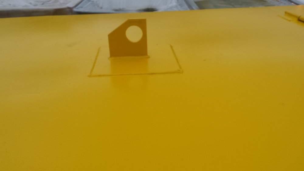

Had a job from a local oil cleaning company to build a centrate tank and modify 2 14yard skips into filter tanks.
Not a great deal of work in them but it was fun all the same, skips have a lid made from 2mm sheet stich weled to a 30mm box frame and a lifting eye on top. Inside there is perforated steel sheet for the filter and a bauer connection to be fittedto the pipework. Inside on the floor is a sheet seam welded to form a 'drop' so the liquid can run to the out let pipe. 2 sections of 200x100 box section prop up the front of the skip.
