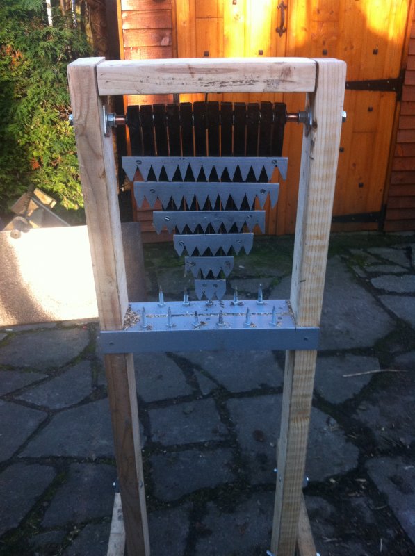

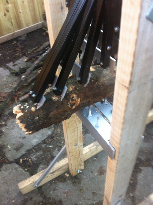

had been using b&d workmate (slow and tips over)..jamming against fence(not good)..and just sawing on top of wood pile(unsteady)..i decided i needed something better, was going to make simple trad saw horse or buy cheap metal one....anyway whilst looking on ebay/youtube i noticed a different type, quite fancied one but not at £70 approx, so had ago at making one using angle iron ,box steel(from an office chair)4x2 timber, threaded rod and assorted nuts bolts and washers, surprisingly it works a treat,self adjusts from1" to12" dia and i had a 5m 8x3 timber in it with me sitting on the end! great to work at a comfy height and no need to re clamp or adjust.. think i will make a lighter/smaller one, maybe from alloy to make it more mobile,
anyway well chuffed for the under £5 it cost in materials!
