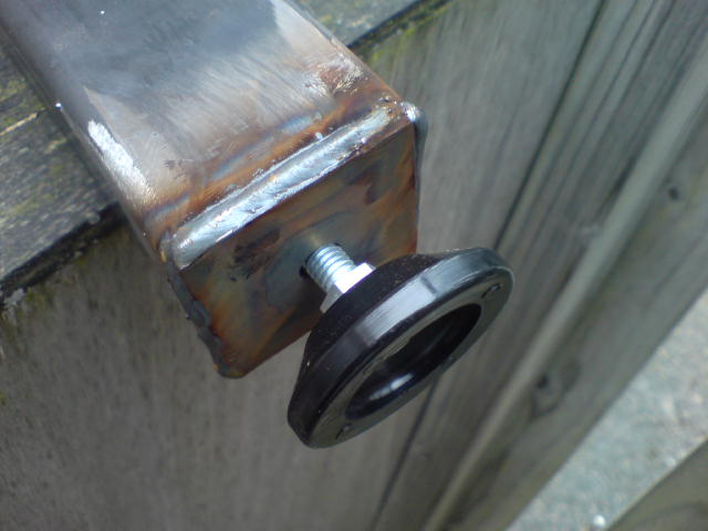

then welded some nuts onto some square washers for the base of the legs
so that I could use adjustable feet on it

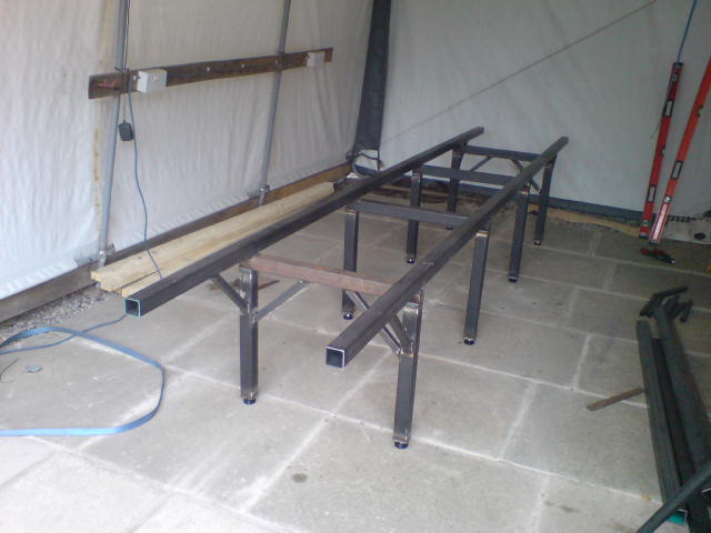

the main rails were then squared up so they were level

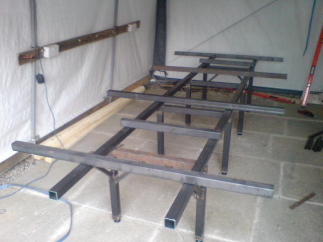

and then the cross rails were welded in place. there were just 2 50mm seams welded on each of the ends, one was welded and allowed to cool before the second seam was welded.

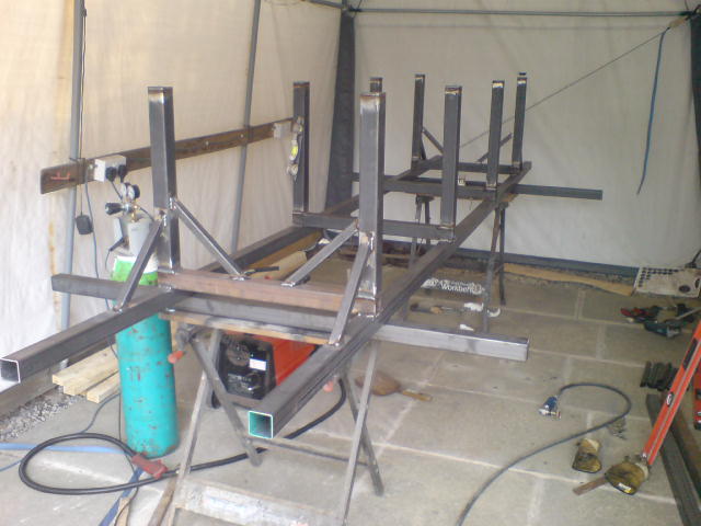

the legs were then welded on
and some diagonal braces were added

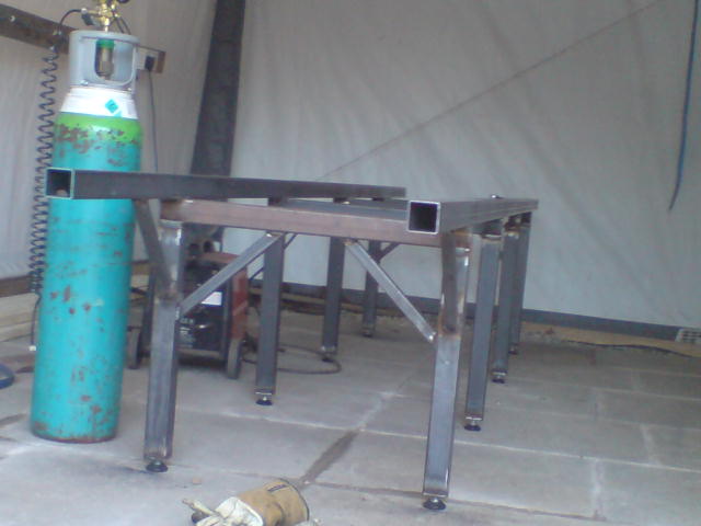

and the finished article......
...... well I wish it was but the main rails have bowed slightly due to the heat from the welds on then.
If I weld some beads in top and then grind the bead off, is it likely that the rails will straighten, its only 2 or 3mm but I'd prefer it to be straight. the other option would be to tack some pads on to on the rail at strategic points to measure from. what do you guys who know about these things think.
