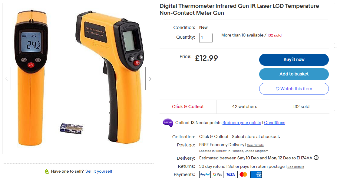

From what sort of 'distance' can this item take the reading?I bought this fella a few years ago for a tenner. Now a princely £13 but it's lasted several years, so....
0Digital Thermometer Infrared Gun IR Laser LCD Temperature Non-Contact Meter Gun | eBay
Auto Shut-Off in 7 seconds to extend the battery life and features a low battery indicator. [TEMPERATURE RANGE in CELSIUS and FAHRENHEIT]: -50°C to +400°C /-58°F to +752°F; Accuracy: ±1.5% or ±1.5°C.www.ebay.co.uk
Good point - mine seem to be fine at 6 foot or so - never really tried further away.From what sort of 'distance' can this item take the reading?
The further away the wider the area measured, so pointing the dot at say each plug lead to check the firing from 6 ft away doesn't tell you much.Good point - mine seem to be fine at 6 foot or so - never really tried further away.
I use mine on HGV brakes to check for bind.It depends what you're looking for. If it's pinpoint accuracy then £13 probably isn't going to do it but, as Fizzy said, from 6" to a foot the cheaper option should be good enough for most, I'd think.

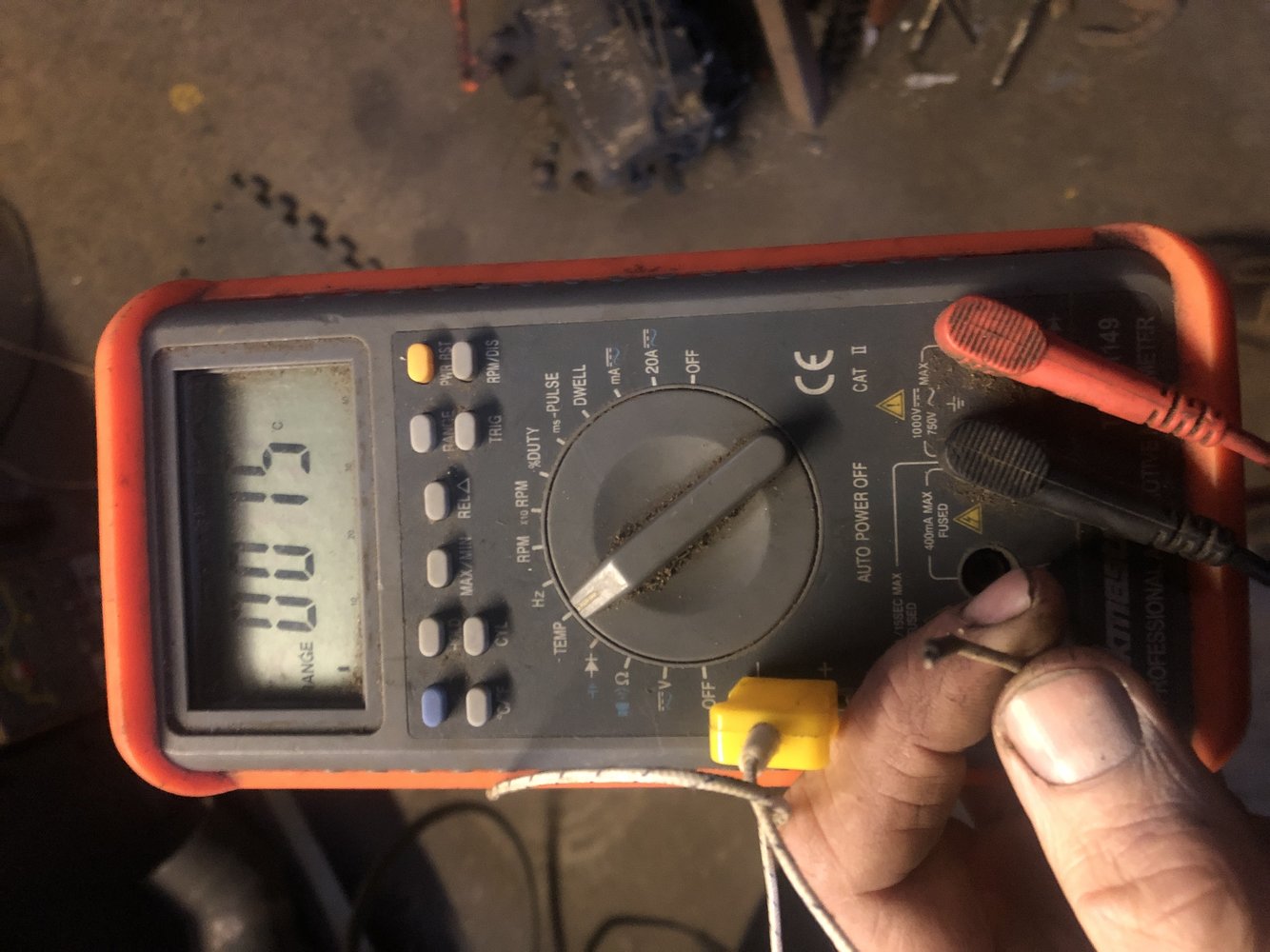

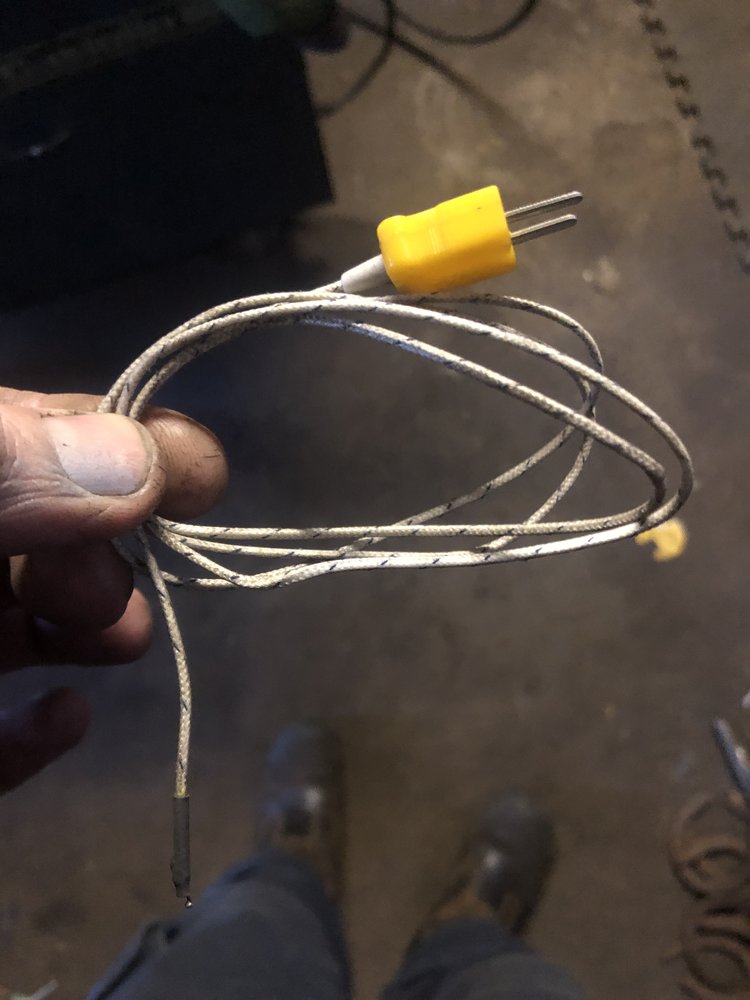

Have you got a multimeter that will take a k type thermometer?@bricol has guessed what i am doing. We have recently installed our Rayburn and thermal store and I want it to set up the system and roughly check the calibration on the thermostats on the thermal store etc so we can make sure the pumps are coming on at the temps we want them to. So pinpoint accuracy isnt too important. Reading within a couple of degrees would be nice.
