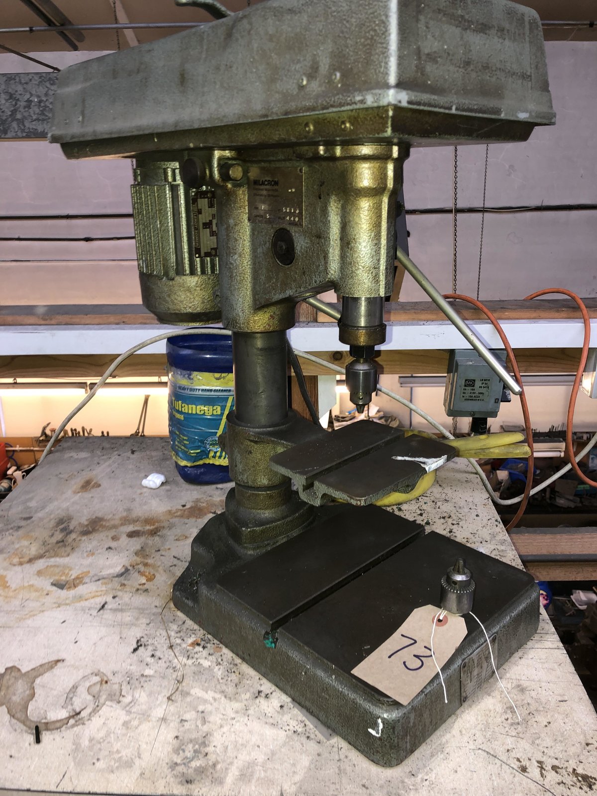

or... to be more precise Cincinnati Lyon Chomienne drill.
5mm drilling capacity, with speed from 440 to 18000.
Originally it had 3 phase 440V motor (I think) 0.25 kW.
Now it needs new motor (and I need advice, please).
I am assuming that 1 phase motor will be larger and heavier than original? and my best course of action is small 3 phase motor with VFD to run it?

If you get the number off the old one, any belt supplier will be able to match it for you.
