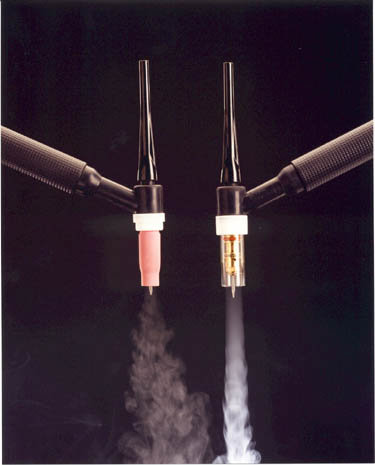

Here's what I found with the above kit. I purchased the biggest lense with the Pyrex cup.
I paid £70 inc postage etc which I thought was expensive, but been sold as a "gas saver" I thought it might pay for itself.
Anyway i've tried it for a few days, its fantastic when welding on flat plate, so my first impressions of it were very good, it certainly doesn't save you any gas, I went up from 7-8lpm to ~10lpm to get the same shield. (expected as the cups bigger).
However, as soon as the weld comes out from under the cup, i.e. you've welded more than 2cm your really struggle to get any coverage and the weld ends up black. I found the same with pipe. At 12-15lpm the coverage is better, but still nowhere near as good as my normal lense. With the tungsten out more than 20mm you've got nochance.
The quality of the product is amazing, and there collect is really good.
There are the odd places I use it when you can't see past the normal cup but thats about it.
I'm not sure if anybody else has tried them and what they found.
I'll post some welds with it later.
