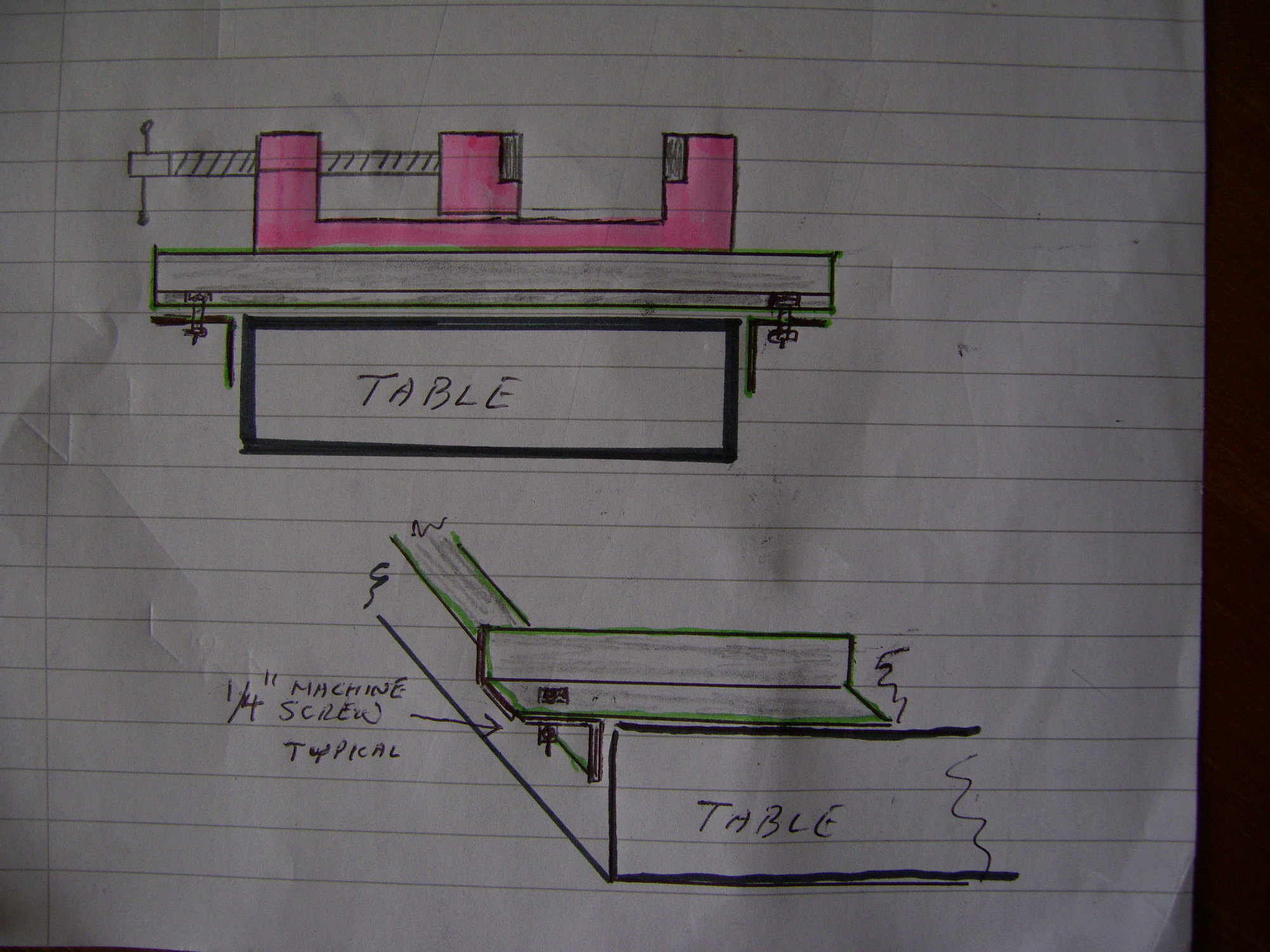

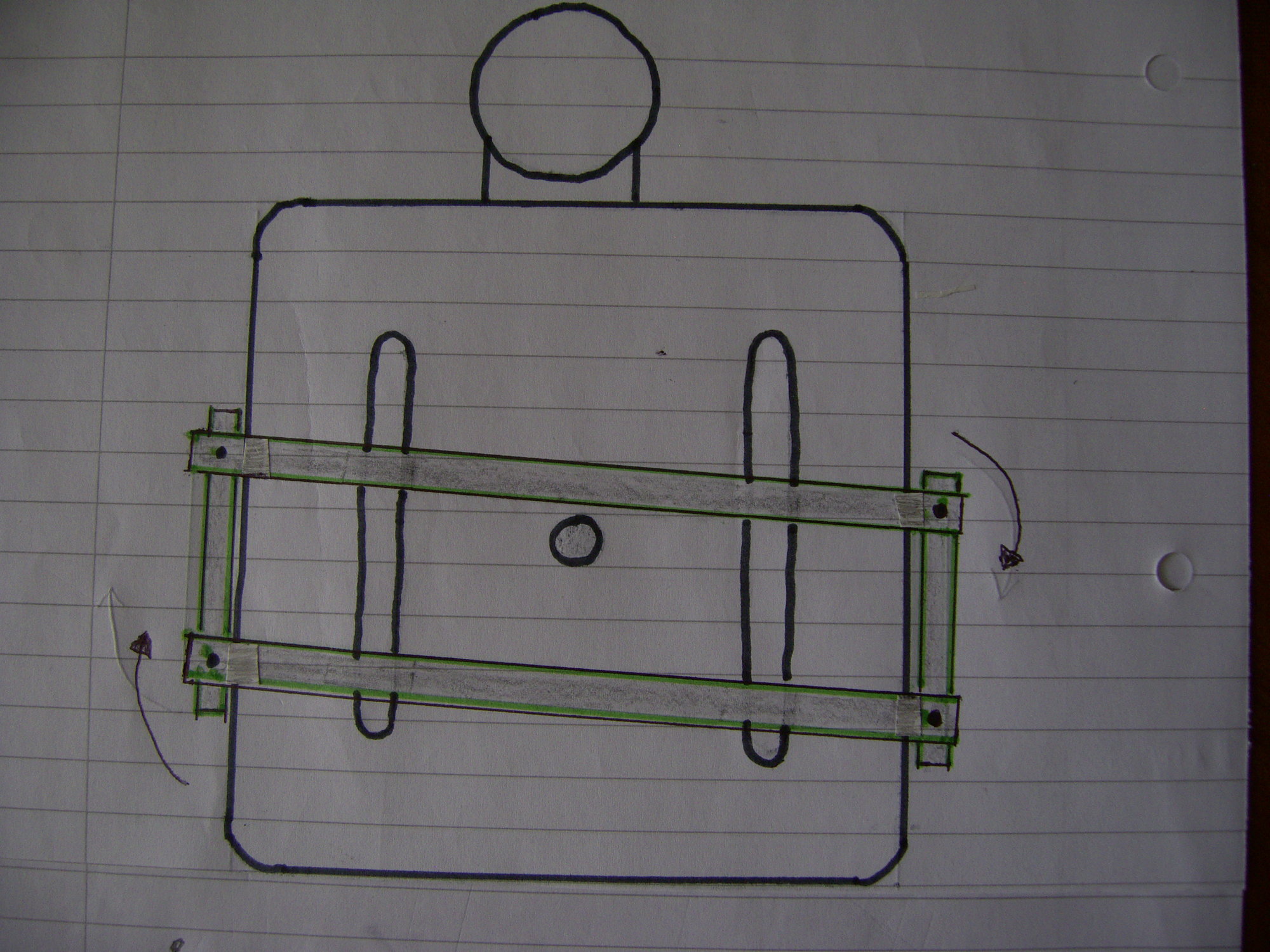

I've got a solution buried in my storage unit which I've used for decades. a simple sliding frame track you can make up with some 1" angle iron. It slides loosely back and forth on a "square" table like yours, and the vice slides left to right within the frame to position the work under the drill bit. With a simple twist of your hand, the sliding frame jambs itself against the vice and the table at the same time with adequate grip to keep the vice from moving or lifting. I'll try and work up a sketch for you John, as I won't be able to get to my storage unit this week. Its a simple brilliant idea that my Junior High School metal shop teacher devised, and has stood the test of time for me.If a person wanted to secure a machine vice like this to a pillar drill or mill table, how would he go about it? Are 'off-the-peg tie-downs' to fit the edge holes [which are 10mm in diameter], or do I have to make my own?

EDIT: Forgot to mention. When you jam the frame by twisting the vice, in either direction, you need to hold pressure against the vice while drilling
Thanks for noticing, you are correct.That is superb, thanks. Could I prevail upon you to do some light Tippexing on it and reupload. The direction in which you show it being skewn is, I think, incorrect. From the top, a normal twist drill will rotate clockwise, so the skew should also be in that direction so the drilling force tightens the clamping force rather than loosens it.

Ahh, bless, he's even coloured it in!Thanks for noticing, you are correct.Sorry, it was late at night and was a quick sketch to show the concept. I can't edit the previous post, but here you go, a corrected table sketch with the frame skewed the opposite way. I'll ask the Moderator to delete the photos in post #9.
