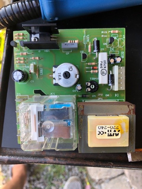

I recently purchased a "preowned but never used" Clarke 150en turbo welder. After installing a male plug on the welder power cord and connecting to 240VAC, the wire feed isn't working. My assessment on this seems to be an electrical issue with the drive circuit. I've been reading posts on this topic on this forum and tried a few things, but now need some help digging deeper into this issue.
When I power up the welder, the fan kicks on.
When I pull the trigger on the torch, the relay on the wire speed PCB closes. I have a gas bottle connected and I get gas flow out of the torch.
I don't seem to be getting voltage to the wire feed motor.
I removed the wire feed motor assembly and connected to a variable bench power supply. The motor spins via external power so that's not the issue.

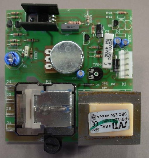

I replaced the MOSFET on the PCB as this seemed to be a common issue/repair. My PCB is an older revision so it has a MOSFET and not an SCR (upper left in image below riveted to heatsink)
At this point I'm stuck and need some guidance on what to look at next. There's a small transformer on the wire feed PCB. Maybe this could be the source of my issue, but I recall reading that if this isn't working, the relay won't close. In my case the relay is closing when the trigger is pulled on the torch.
Below is a pic of the PCB in question. I grabbed this image from an ebay listing (unfortunately this PCB is sold out) but my PCB is similar.
2 pins (pins 3 & 4) on the white 5 pin connector go to wire feed motor.

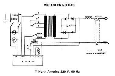

I was able to find a post that contains pics of the 150EN user manual.
Below is a image of the schematic from this manual for the 150EN model.
I'm looking for and open to suggestions on what to do next. Appreciate any guidance on this!
