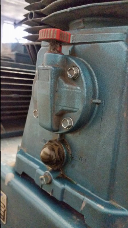

Doesn't look like a leak more a build up of oil mist attracting dust, the filler is also the crank case breather so a small amount of oil mist will escape over time.
Sorry been offline for a couple of hours. Yes it will charge to 150psi. Constant hiss whilst sat idle. I ran it upto 50 psi and it was discharged after about 2 hours. Thanks for the replies. Took the cover off and air seemed to be coming from main bearing (crank at a guess)?
Ok. Thanks for all the suggestions. The unit has been unused for some time and after a few re charge cycles it seems to have stopped. Maybe a valve not seating? It has a very slight leak from the pressure switch, which I'm going to leave alone unless it gets worse. Cheers
