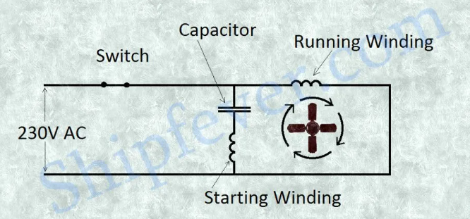

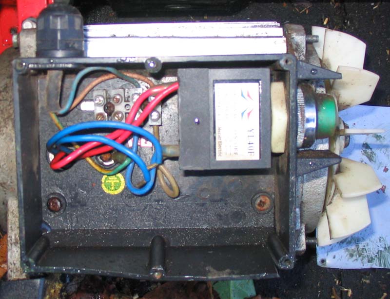

As I have several trees to cut up for firewood, I decided to get a log splitter. The electro hydraulic models all seem to be of the same basic design, so when one came up at our local machinery auction I decided to take the gamble (everything there is sold as seen, no warranty implied or given). Anyway got it for a reasonable cost, but it doesn’t work. Plugged in, pressed the button, it gave a slight buzz and blew the 13amp fuse. Took the cover off on the side of the motor and someone has been messing with it before. I am used to cap start, cap run, adaptations of three phase motors, where you test that all phases are equal resistance and no shorts to earth, but this one isn’t. It has two red wires and two blue. The reds are connected to the on/off switch, the blues are not connected to anything, I assume a capacitor has been removed, connected to the blues? So, I don’t know how to test it, but set the ohmmeter to 20M ohm scale and get 1.32 across the reds, same across the blues and same between any blue and red, does this make sense? Between any wire and earth the meter wanders about. Also the on/off switch doesn’t stay latched. Instructions are a bit vague, but imply you need to have your finger on the button and press the hydraulic lever at the same time to make it work, is this correct? The cover plate has been replaced with a piece of sheet metal, so no motor details, but the machine is a Clarke log buster 5, I can download a manual, but it doesn’t have a full parts list.
