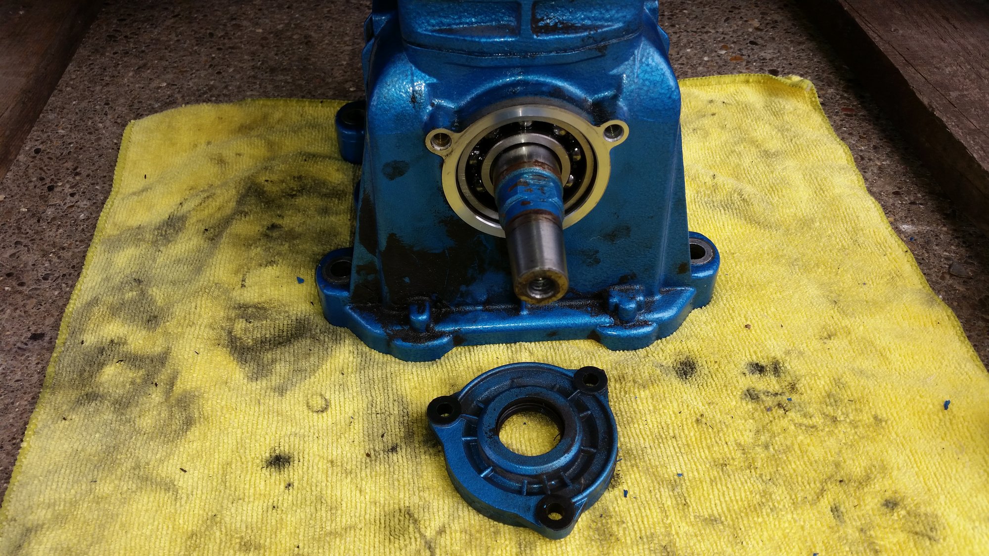

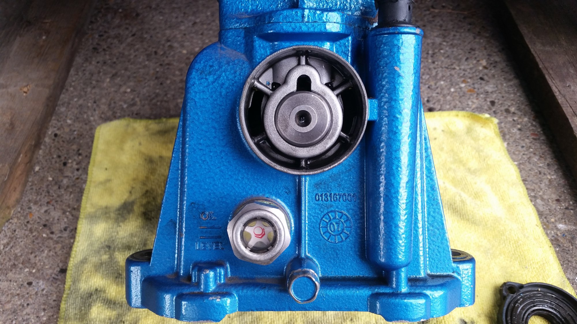

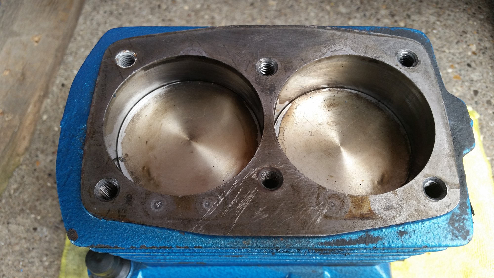

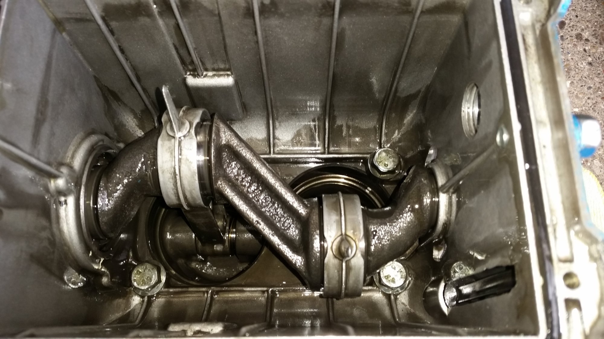

I've been stripping the pump down and there are some differences to the SE16C150 which gasket999 rebuilt four year's ago.
Only one crankshaft bearing at the pulley end, a bush at the other end. No big end cap so the connecting rods will have to slip off the end of the crank.
How to remove the crankshaft, press it out from the bush end?

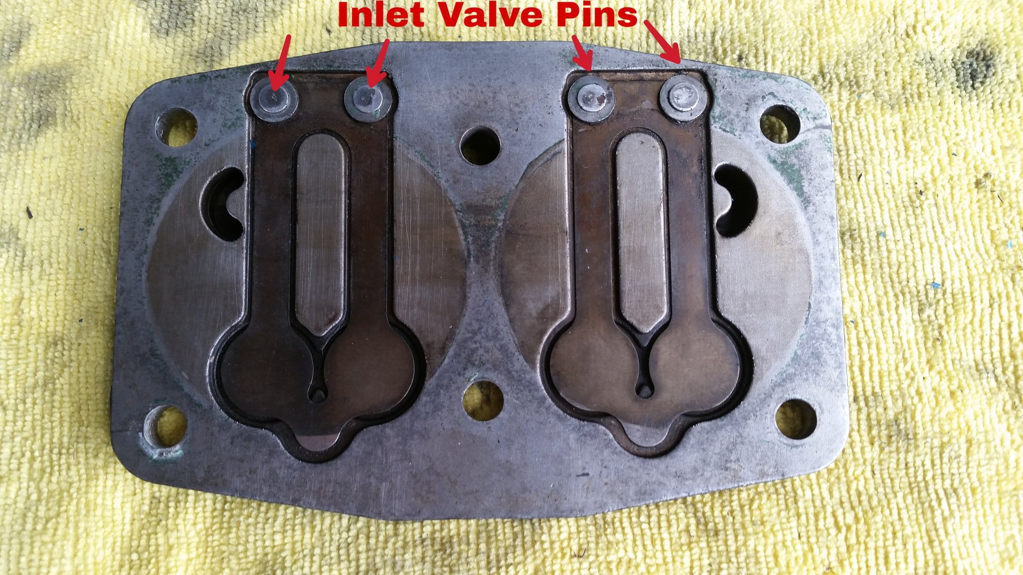

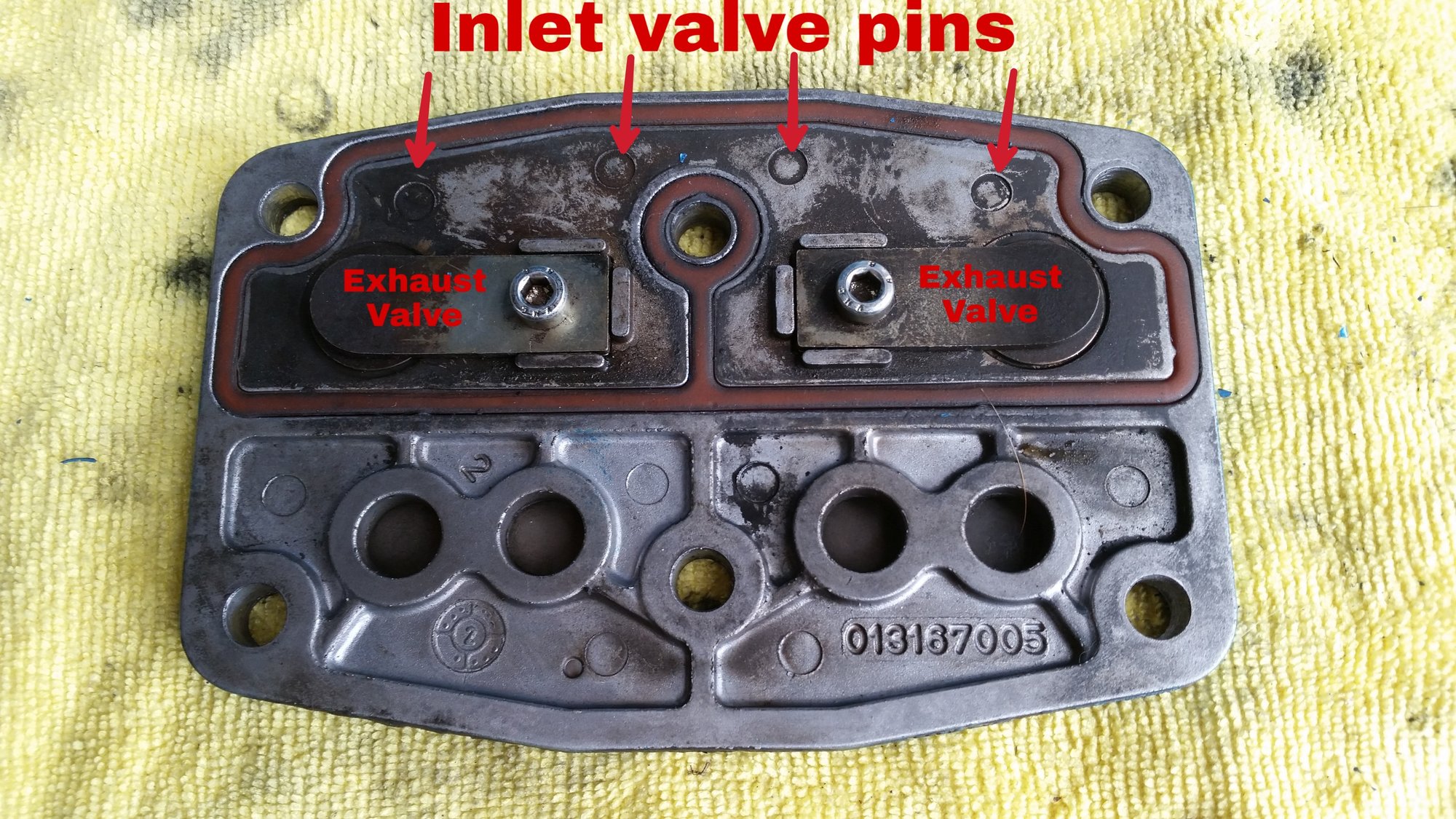

Also, the inlet valves are pinned onto the valve plate. I was thinking about grinding off the heads and knocking the pins out, I can then tap the holes and use some stainless socket head screws to fit them back on.
