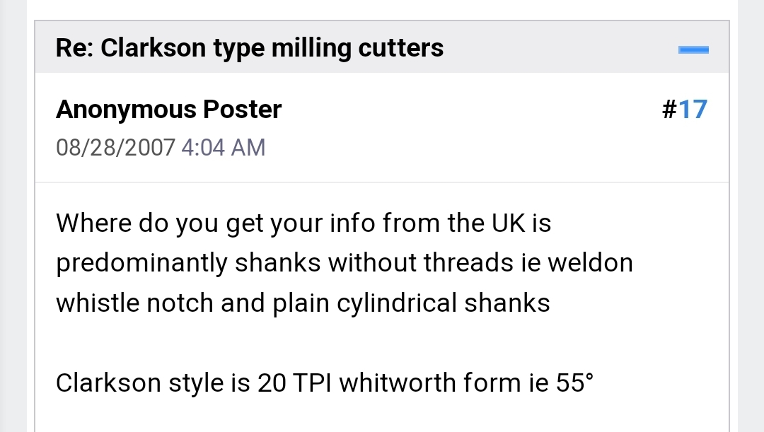

So what I did was machine the thread off my drawbar and tig a bored out M12 thread on instead. So what about the Clarkson - do they have a unique thread? I tried metric, unc, whit, nothing. The M12 goes in far enough to hold, but it's bugging me.
